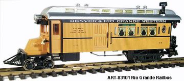

Some discussion on the build is here: http://www.largescalecentral.com/LSCForums/viewtopic.php?id=5857 You might want to do something similar. The problem is you need a drive unit. Aristo craft does have a motor block, but I have no idea what it looks like: https://www.aristocraft.com/MOTOR-BLOCK-RAILBUS-WA-FRAME_p_550.html - Motor Block For Reo Railbus w/A Frame and Side Frames ART29358 Edit: Probably looks something like this: :smiley:
(http://www.reindeerpass.com/images/products/detail/83101.jpg)
