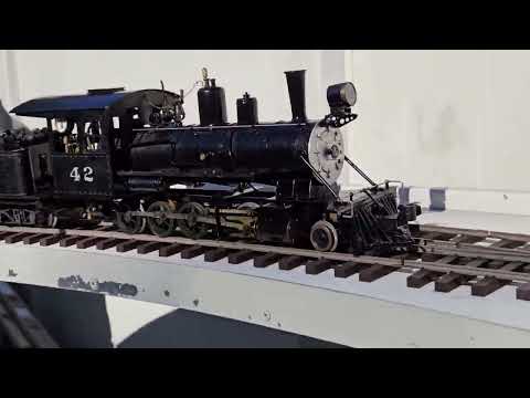

Cliff’s video of the meet showed everything, but my video has a great section of my live steamer climbing the hill behind Telluride with the coaches.
