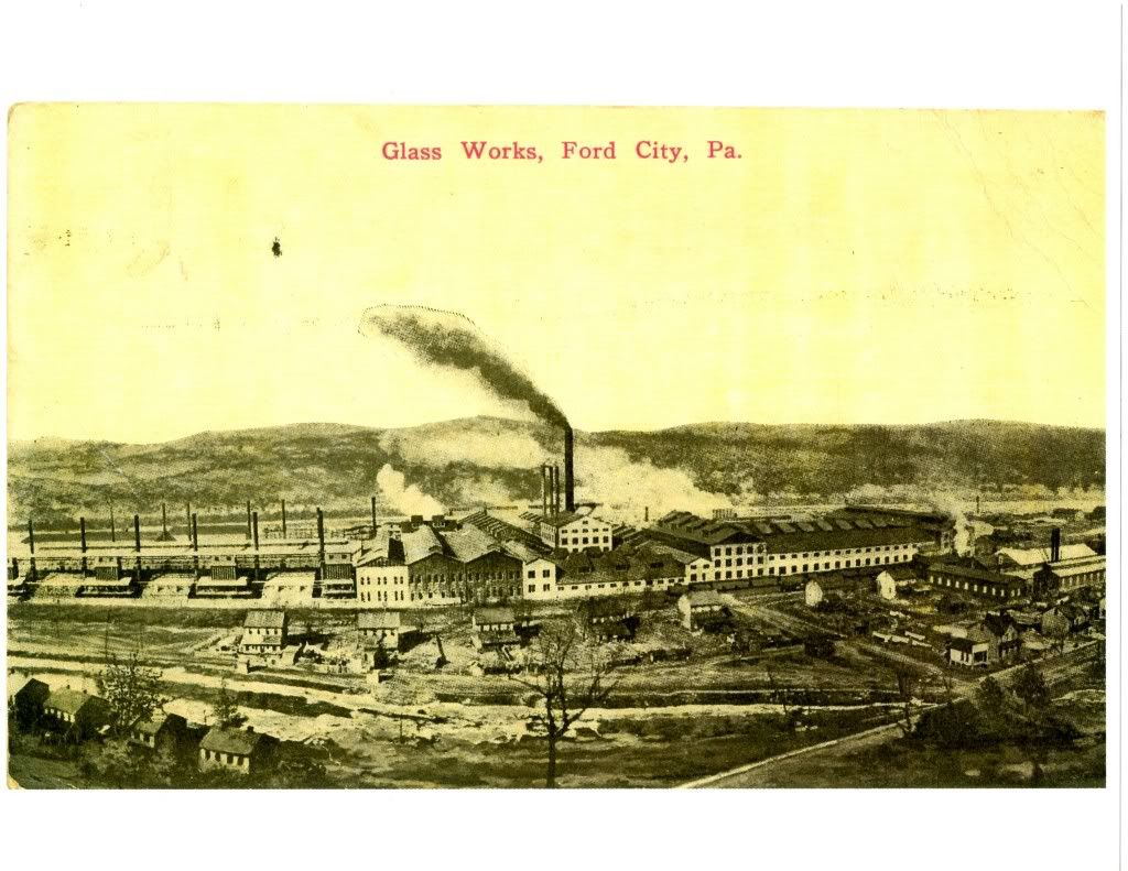

I DO need to build an industry at the end of that siding. Unfortunately a LOT of old industrial buildings around here are brick with huge banks of windows… and I haven’t yet figured how to fudge those. http://www3.familyoldphotos.com/image/view/23943/_original

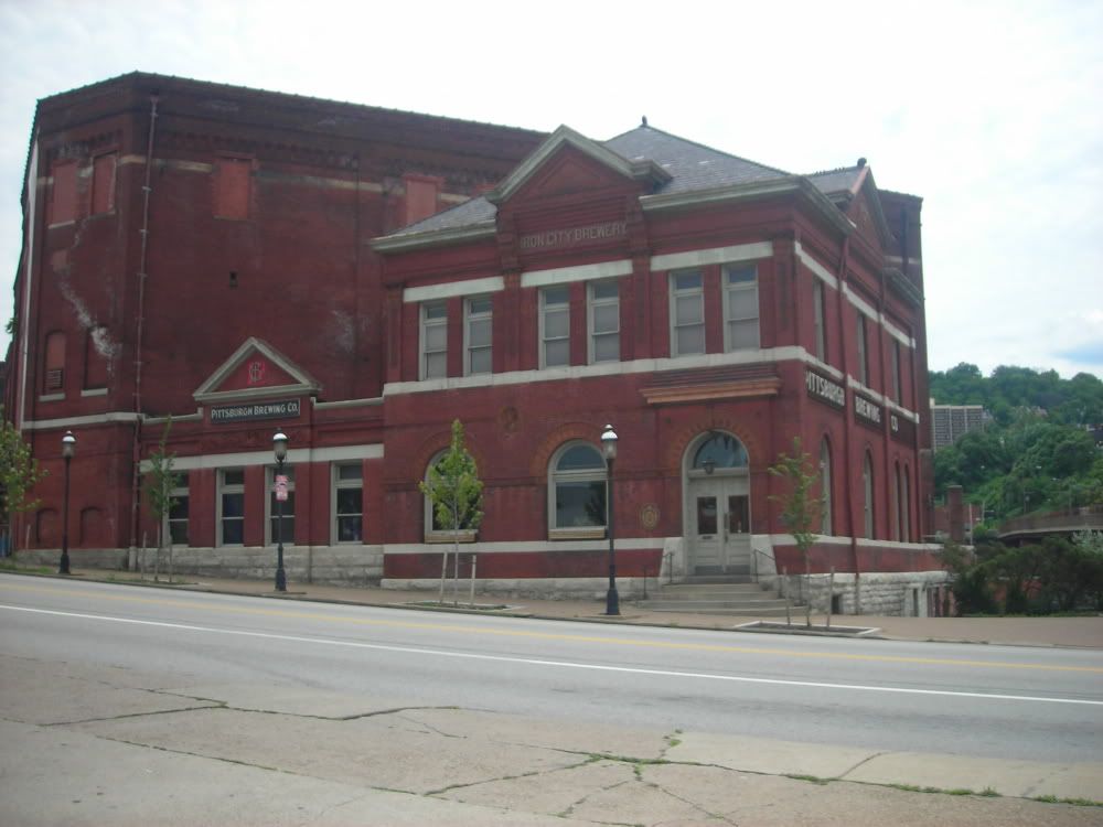

With all that industry you must have had a brewery?
A brewery? Fort Pitt Brewery http://freepages.genealogy.rootsweb.ancestry.com/~njm1/thumbs13.htm Duquesne brewing http://bradystewartphoto.photoshelter.com/image/I00009tP25Uk1iho Iron City Brewery

An idea for banks of windows. When I built my coal plant look in this issue of GR mag. my research showed most structures had huge windows. My windows are false in that I planked around the “opening” then painted the opening black, scored and snapped a piece of plexi for it then cut a piece of 1/2x1/2 " hardware clothe to form the grids. I have done a similar thing with my latest building but now have actual windows made from hardware clothe and plexi. You don’t need a huge building for a brewery maybe just a still or a bathtub enclosed in a small building.

Todd, Great idea, thanks!.. now to figure out the bricks

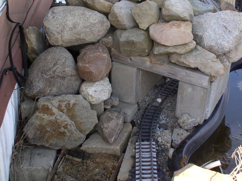

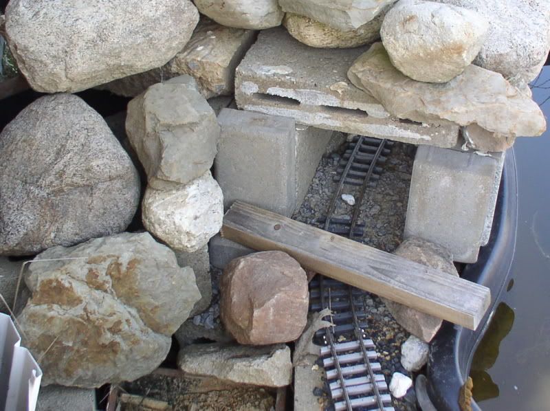

Since it was nice the last couple days, I started trying to get the layout back to where I could actually run a train. First order of business was to repair a major cat slide (as in the #$%& things think the layout is a jungle gym)

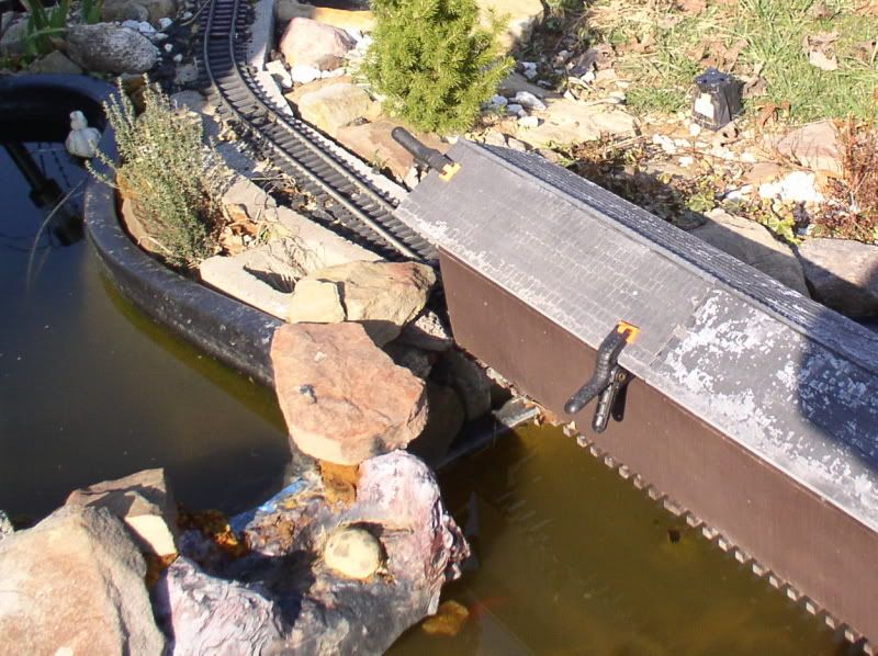

I planted ivy so maybe 1. it will help hold it together, and 2. maybe it will discourage them from playing on it. Another cat-astrophe was some fat tom got stuck in the long bridge, and put the roof in the pond. Are you all sure I can’t put out tuna and anti-freeze?

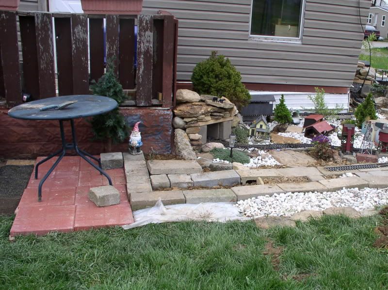

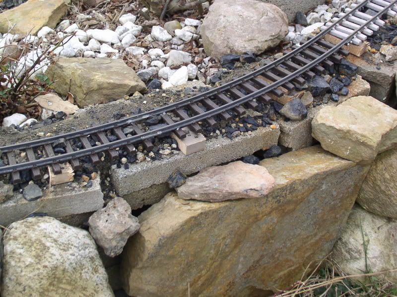

Subsidence is still an issue, even after two full years. I decided to use wooden piers set in the ballast to level and hold the track in the worst spots. - if they rot out after a year, they’re cheap enough to replace… or maybe the settling will finally quit and I’ll be able to reset the patio stones.

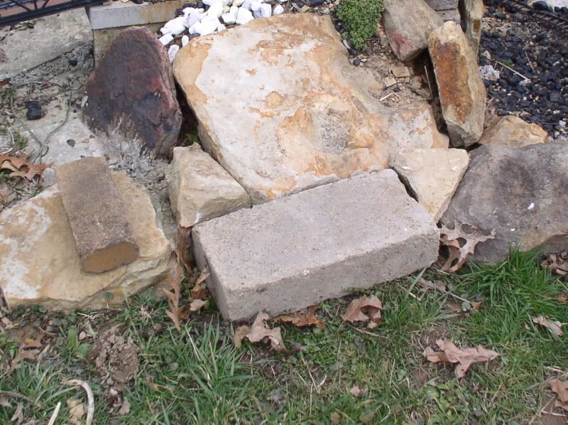

Foundation layed for a new building. I’m thinking a wolmanized 6x6 core plated with lathe since it’s so exposed… That way if it gets kicked it won’t hurt it.
