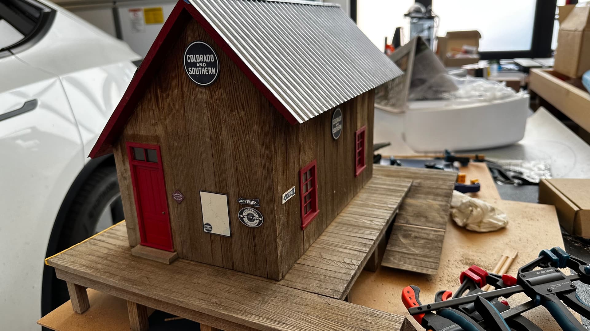

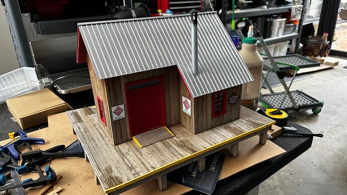

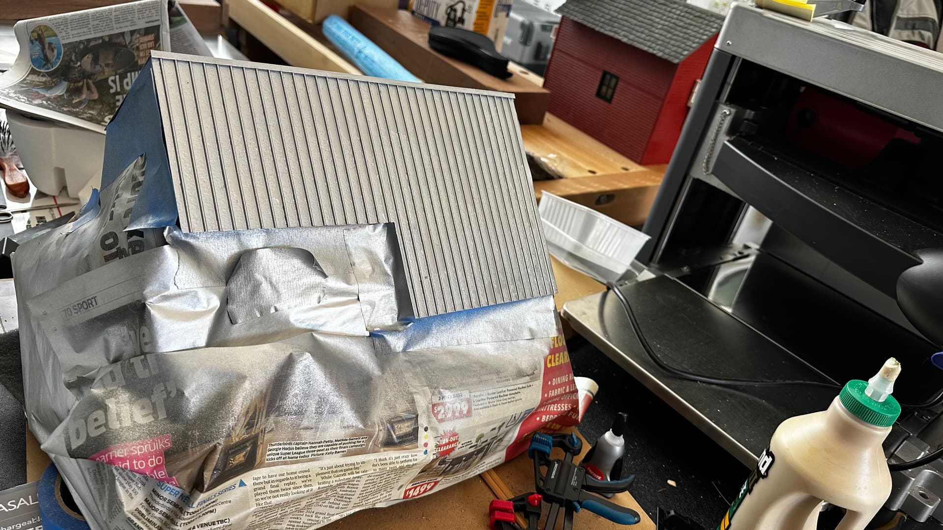

UPDATE:
Some warpage and wood splits I couldn’t overcome, but it’s looking serviceable again.
Now on to the shingled roof… stay tuned.
