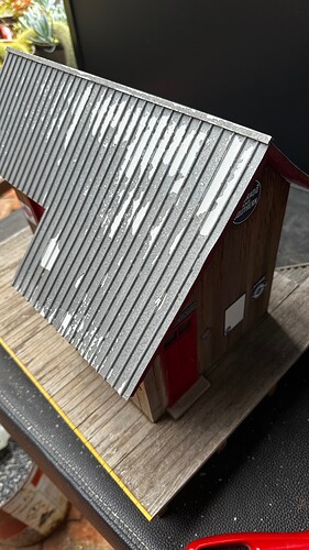

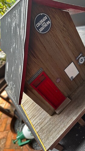

Earlier this season there was a light patch of plastic corrugated roofing showing through that I patched with some paint, but last month we had a bit of a hail storm
I did build this before joining LSC and would have built these differently now. Here are some limitations:
- I donāt have any access to more if this corrugated plastic.

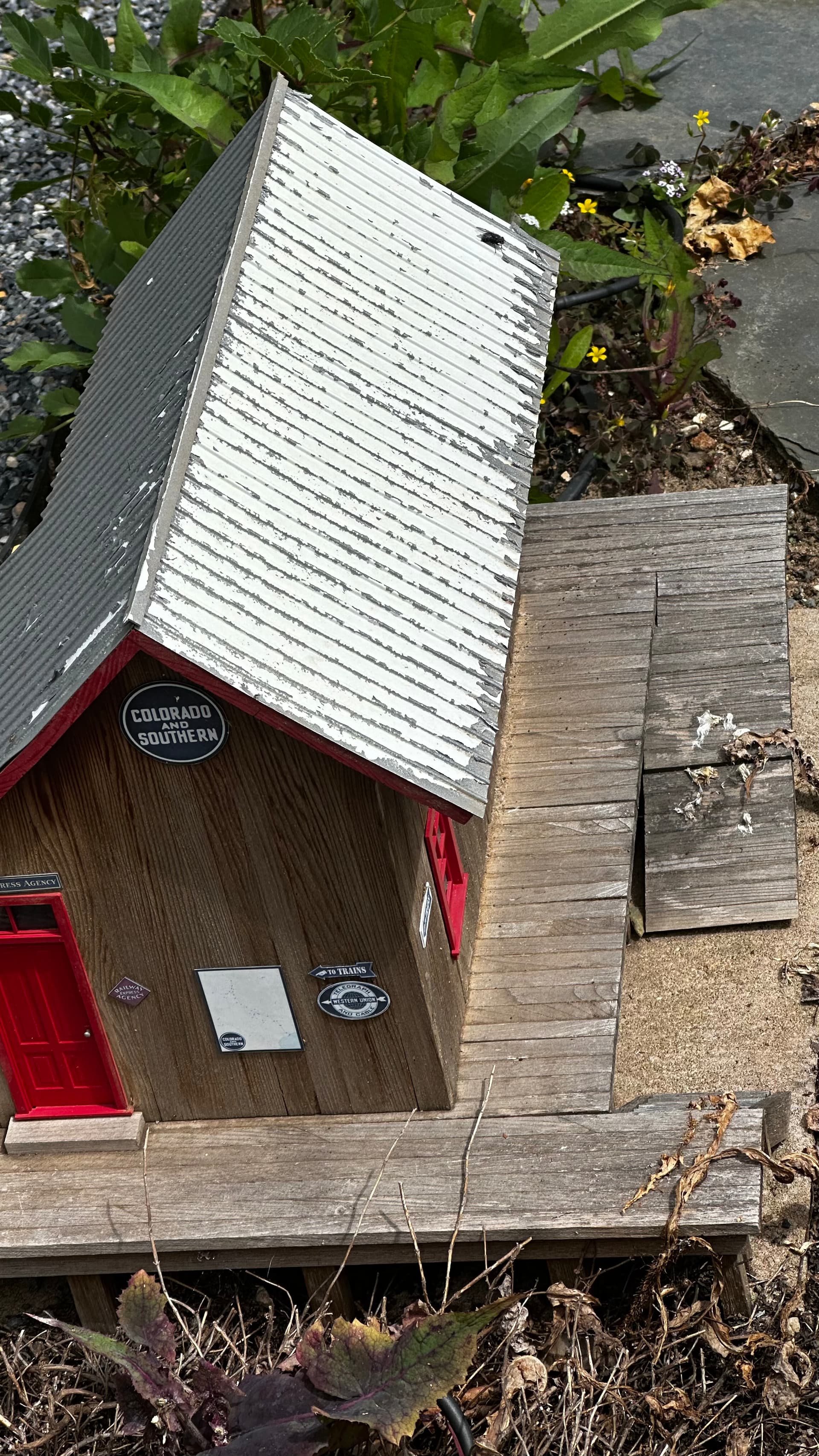

 - The glue in many places remains stronger than the wood.
 - I have some significant gaps on the decking

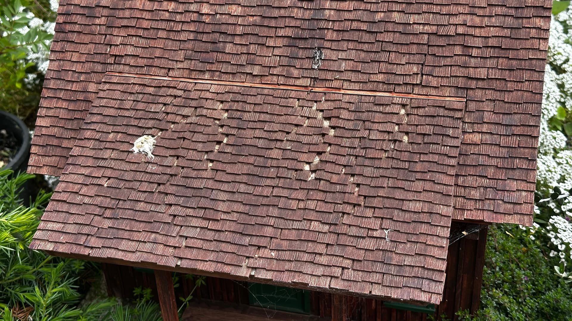

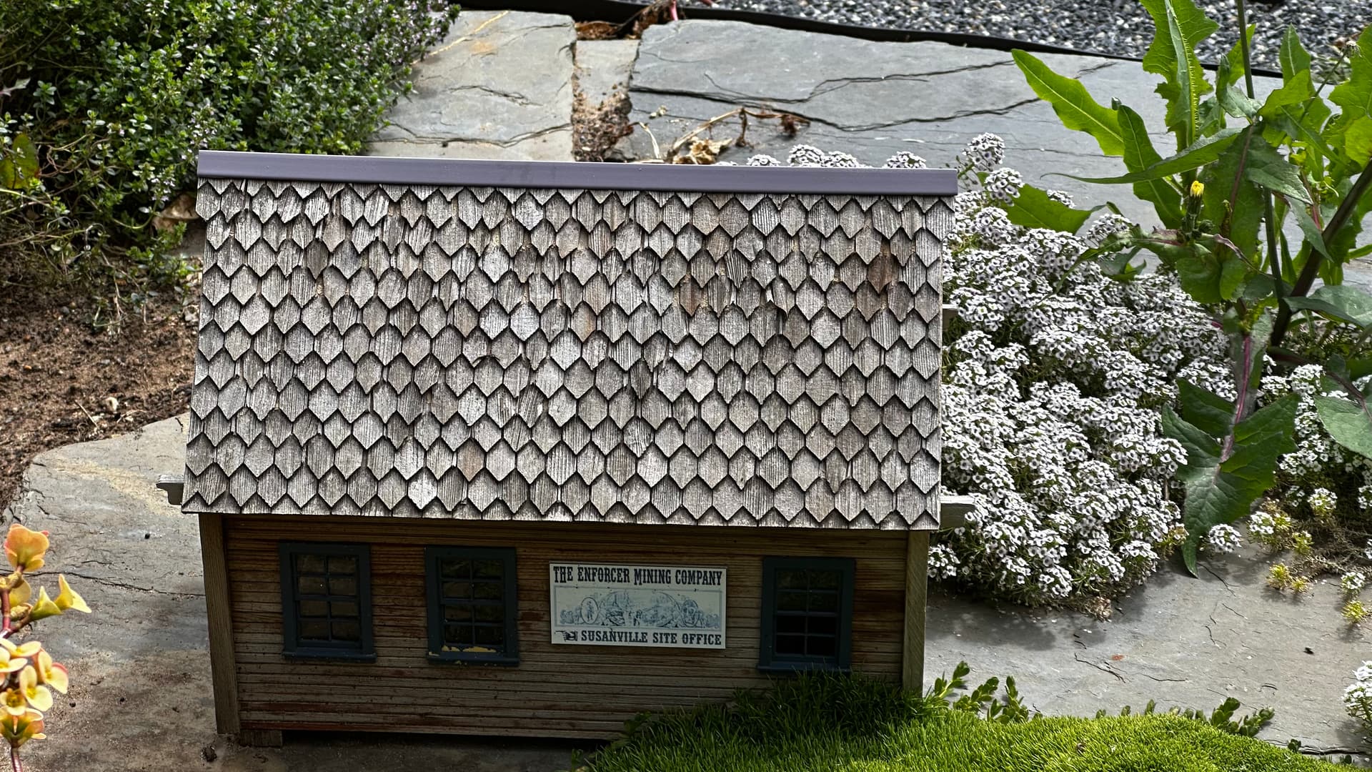

Iāve had some shrinkage on all my shingles except the ones I used on my water tower using a revolutionary yet messy silicon technique.

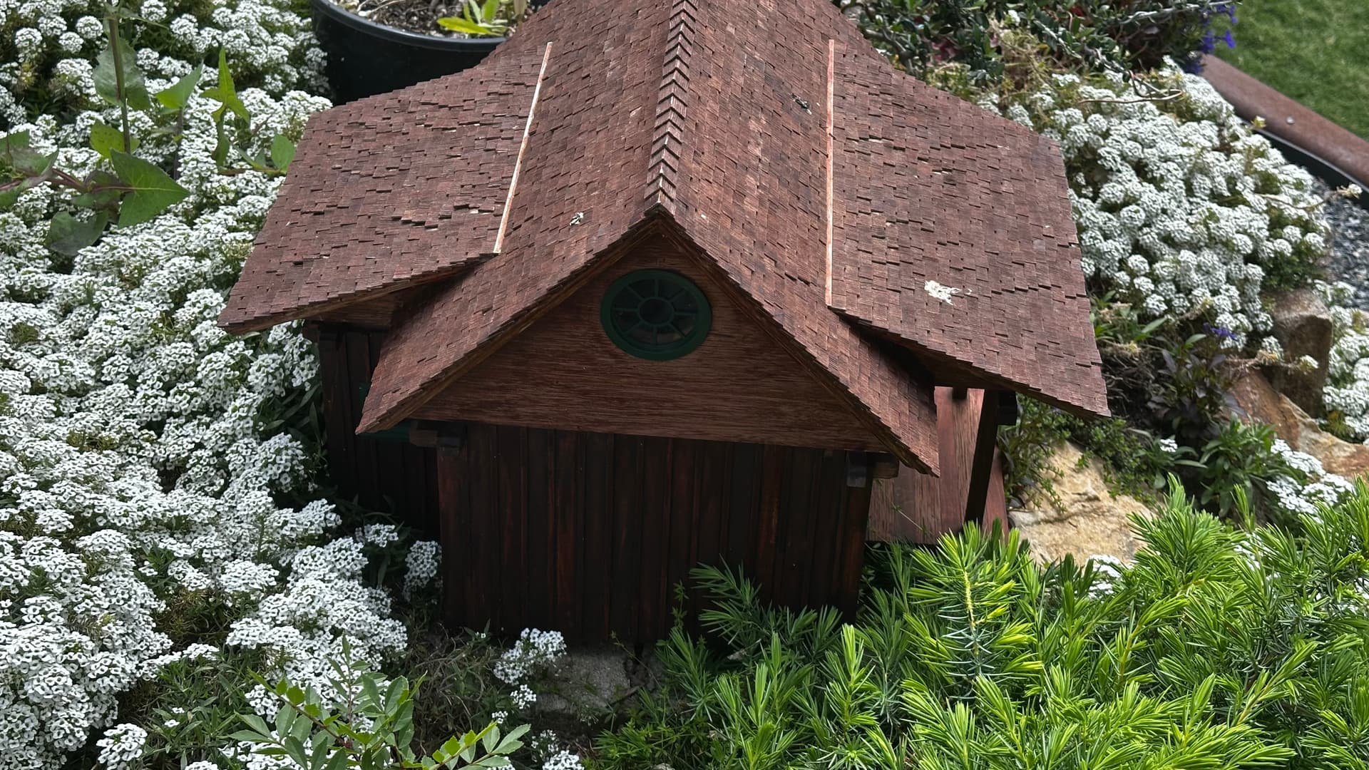

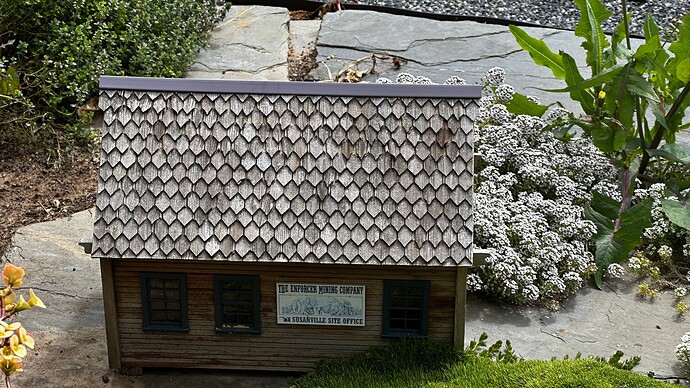

I slipped some slivers of shingles into my diamond shingled roofing with some success. (It looks ok at 3 meters)
The bungalow is doing ok on the steep section but quite disrupted on the flatter section. There is quite an undulation with the separation of the shingles which leads me to postulate the base layer has been disrupted. I had used tightbond 3 to waterproof it.

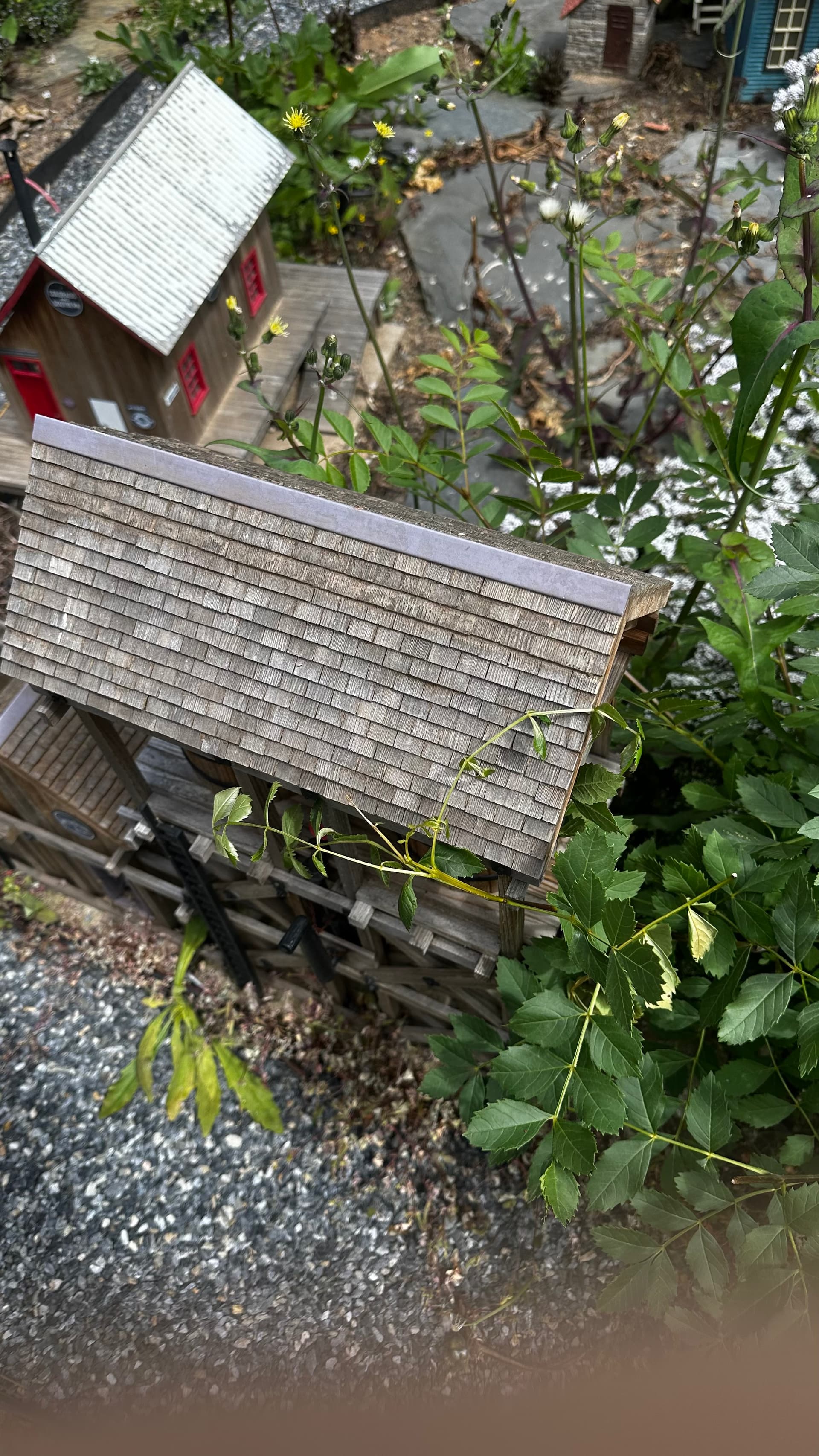

The water tower is ok⦠so far.
Any suggestions?
Would lindseed oil be worthwhile trying on the Decking vs relaying the deck?
