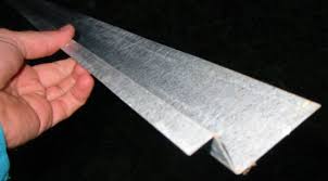

To save money, I used lathe metal Z flashing for the rails inside. My brad nailer popped right thru…
