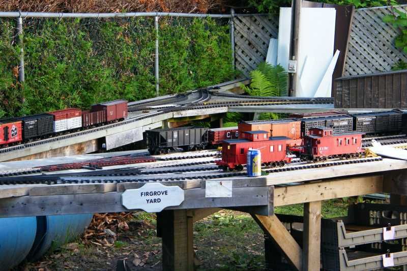

Jason, I just started my raised layout ala the Richard Smith system. My yard has a very steep drop of 5 feet over a 40 foot length. What I did was make the lowest point 4 feet off the ground and ran it back level to the highest point which I made at ground level. That way my platforms run from ground level to 4 feet off the ground but the top is level. It makes the layout look like the train is going up and down while it is really running level. Look up Richard Smiths article on how he made his layout. He does a great job with pictures and explanations. I made my platforms from 2x4 treated lumber 8 feet long, which is the least expensive treated you can buy because of the high volume they produce. I made modules that are 4 feet wide by 8 feet long with cross braces every 16" on center just like a standard house wall construction. I only need to go 2 feet deep in my area for the frost line. I put a 4x4 pressure treated post in each corner and a 2x4 post in the middle of each 8 foot side for support. I just fill the hole around the post with grave with sharp corners, no cement. The platforms are very sturdy and I can walk on them without them shaking and I weigh 280, enough said. The next platform is screwed to the end of the first one and you do not have to install the 4x4 post legs on that end of the platform. That way you only need two 4x4 and two 2x4 legs on each additional platform. When I want to make a curve I just angle the next platform when I install it. I fill in the wedge section between the two platforms with 2x4 cross pieces. It makes a very nice looking arrangement when you are finished. I have a minimum of 5 foot radius curves with some at 8 foot radius. I am taking pictures of each step as I work on the layout. When I learn how to post pictures I will do an article on everything from start to finish. The work goes very fast once you get started making the platforms like on an assembly line. I made 40 platforms in January in my basement and stacked them up. I started installing them in May and I now have 36 set up in the back yard. I have the screen on most of them and am just starting to put on the lanscape fabric and top 2x4 rails. I hope to have my first train runniing before Thanksgiving. I am convinced that Richard’s system is the easiest and least expensive way to elevate your railroad and still have the ability to put landscaping and structures on the table top.
Jason, Here’s a photo that pretty much shows everything involved in the way I construct benchwork for outdoors.
(http://1stclass.mylargescale.com/RichardSmith/RRConstruction/107Aug15ShowsAll-Web.JPG)
Here’s a shot of one of the latest areas being worked on.
(http://1stclass.mylargescale.com/richardsmith/2008/264-ViewSouth-Figure-13Jul08-Web.JPG)
If this looks interesting to you Steve Conkle did a most comprehensive PDF file on the RR’s construction. It is available free for reading or access at… http://1stclass.mylargescale.com/stevec/POC%20RR/POC_Main.pdf Warning: This is a very large file in case you’re on dialup. This is one way to do it but not the only way.
