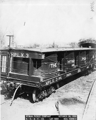

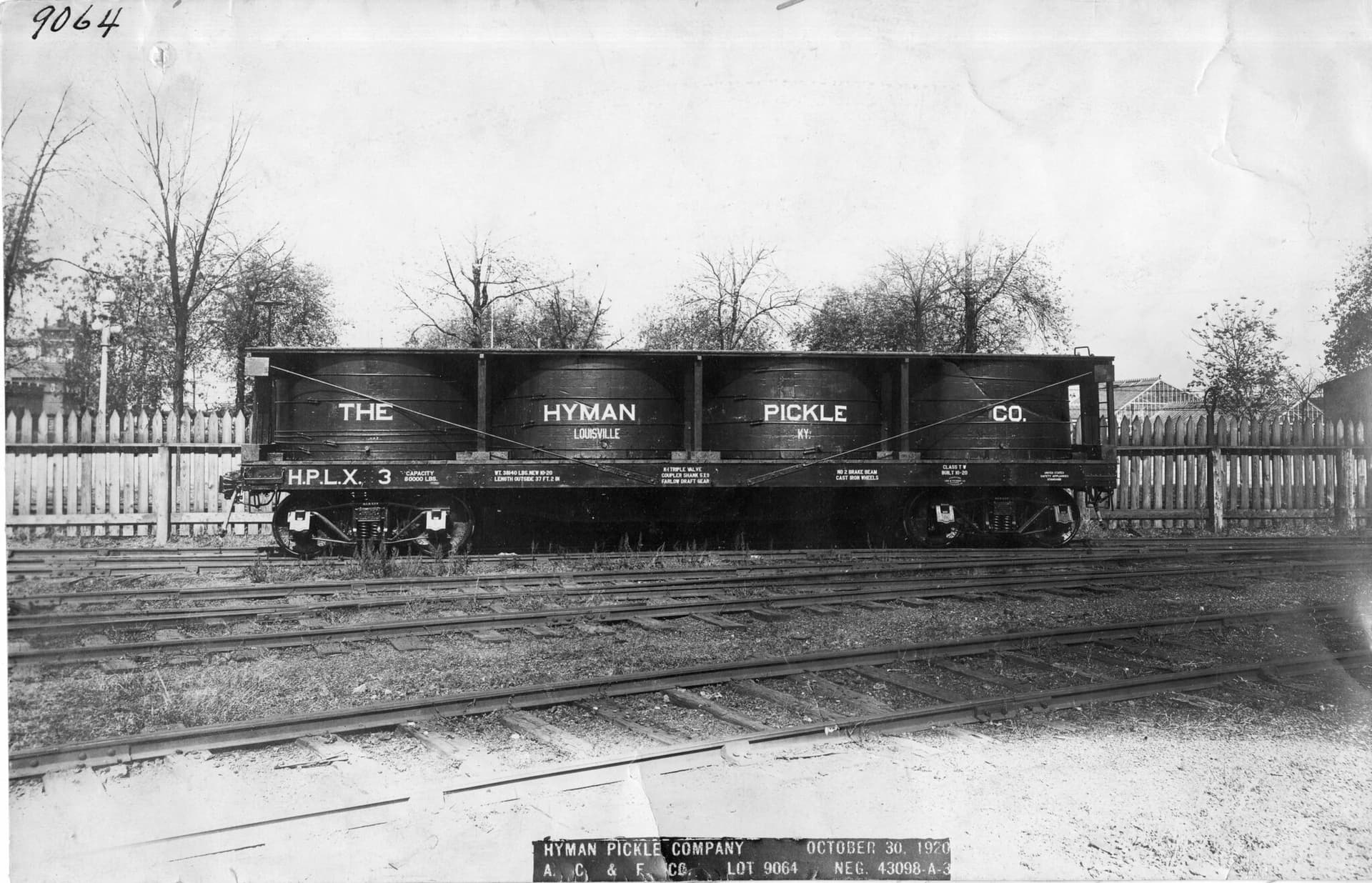

I want detail so open sided is the way to go. Kind of like the company name on the tanks rather than a sign board on the side or top. See the Hyman Pickle pictures.
I also prefer the inter-tank bracing and tension rod design on the Von Allmen car.

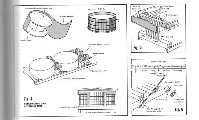

Some plans I found. Interesting ideas since I am going to kit-bash this not scratch build it.

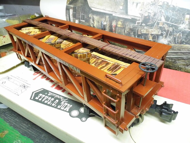

TA-DA Here it is:
Started out as a Delton Coal Car that I took the guts out.Pickle01
I used some plastic cylinder containers that instant lemonade had come in and covered them with stirrer sticks, then used markers to color them.
Pickle04
The decals I had from Who-knows-where. I think they were O Scale.

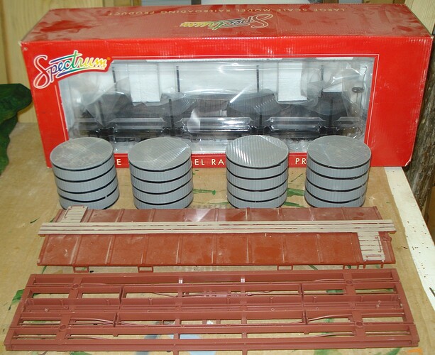

After an unusually adventurous search through the store room I found the basic parts for this project.
The roof and frame are left over from the rotary build. The tanks are from some Delta or Aristo flatcars. Don’t remember exactly but I have a pretty good stack of them. Lastly is the unpainted spectrum flatcar and a wood roof boxcar.
The first thing I need to do is swap the roofs of the boxcar. Pickle cars were mostly wood to prevent corrosion from the salt brine. That will leave me a wood-side boxcar with a Murphy roof for future use. Probably a poultry car or tool car for the MOW.

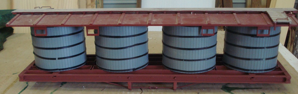

If I use the frame piece I can return the flatcar to the archives. It will take a lot of work to build a new body around the frame but it will give me the chance to do something a little different from the original plan. The Lamoille car looks like the tanks are sitting on wood beams with no decking. Could be pretty cool and one more thing to make the car seem unique. I will have to think about this.
In the meantime here is a mock up of the basics.
