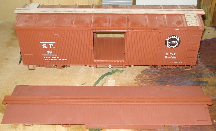

Roofectomy complete on the boxcar.
The metal rings on the tanks are heavy chart tape so I just peeled them off. I will use wire for the new ones.
The tanks should be about 7 feet high but they scale out to almost 8. That will give plenty of room to cut the tops off.
There is no wood grain on the staves. I will have to fix that with some 60 grit sand paper before painting.
My company that will own the car has a reefer already. To match that paint scheme the pickle car will be white with a burgundy roof. Need to decide if the tanks will be raw wood or white to match the rest of the car. There are plenty of examples of both.

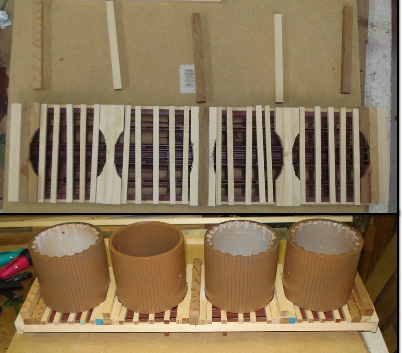

The first thing to build is the tanks. I was wrong on the measurements. They scale to only 5 1/2 feet. No cutting the ends off. Still need to open the top of one of them for the visible pickles.

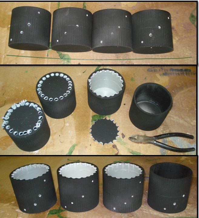

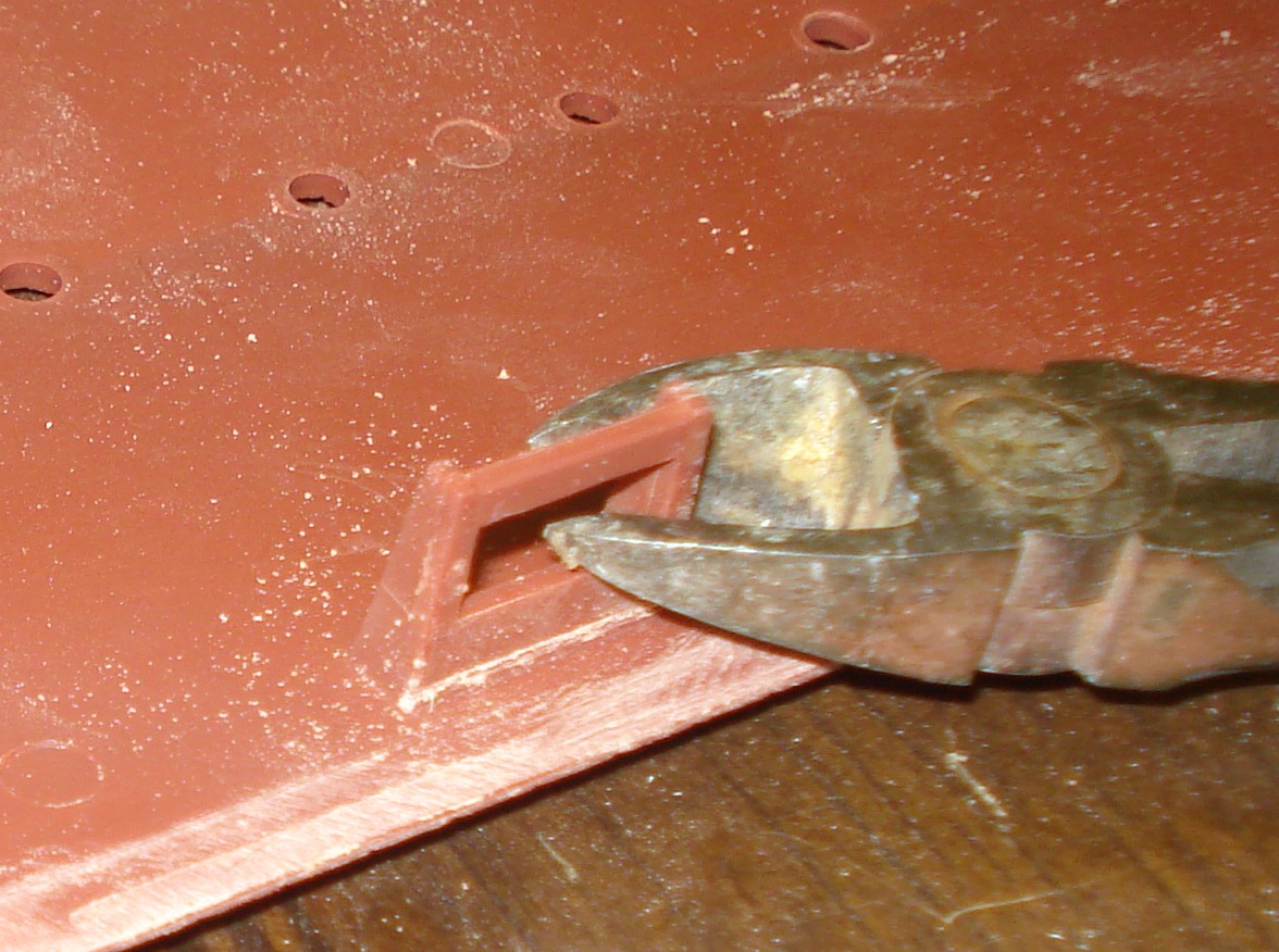

First I drilled all the way around one end. Say what you will about Aristo, but their stuff is hell for stout. Look how thick those walls are. Next I cut the connecting material between each set of holes with a pair of dikes and then hack-sawed around the interior to remove the last of the material. Finish up was done with sandpaper. A quick wipe-down with a little rubbing alcohol was all that was needed to remove the last of the glue residue.
Ready for primer. There are few equipment items in model railroading, especially steam era, that do not benefit from a good coat of flat black.

I decided to use floral wire for the tank bands. Holes are drilled so I can insert the ends and then tighten them from the inside. Unfortunately that means opening the tops of the other three tanks.
At least I don’t have to clean up the edges since they will not be seen.

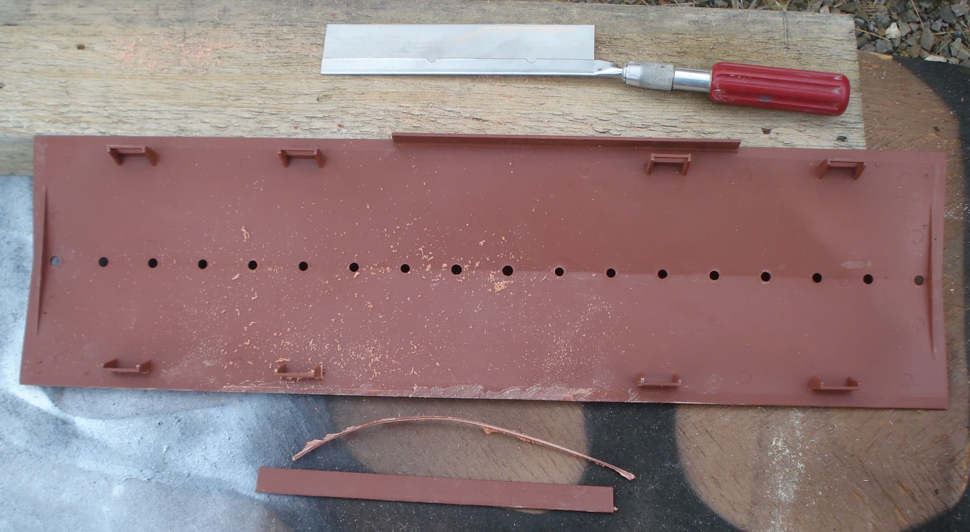

One of the nice things about working with Bachmann products they are either snap or screwed together, no glue. In this case the frame is just held together by the top section which is gone. To keep it together I glued the with Testers model glue.

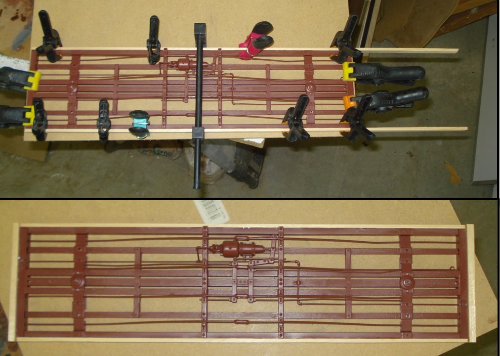

A new flatcar body has to be made. The side rails are pine strips I ripped on the table saw. They are glued on with model glue. Once dry the strips are trimmed to length and new end beams are glued on. To give it real strength I will have to go back and use superglue at several of the joints.
Still not wanting to do a deck. I hope the tanks, support beams and upper structure will hide the fact that the frame members are hollow. Lots of sawing and fitting today but it is starting to look like something.
Need to sand everything to fit and then I can glue the bottom section together.

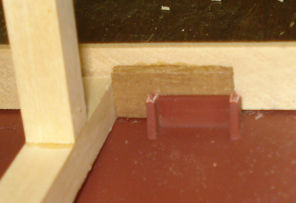

Sanded everything square. All of the joints are drilled and pinned to give the car more strength.
Once the ends are trimmed off and sanded flush, the center supports are ready to be glued to the frame.

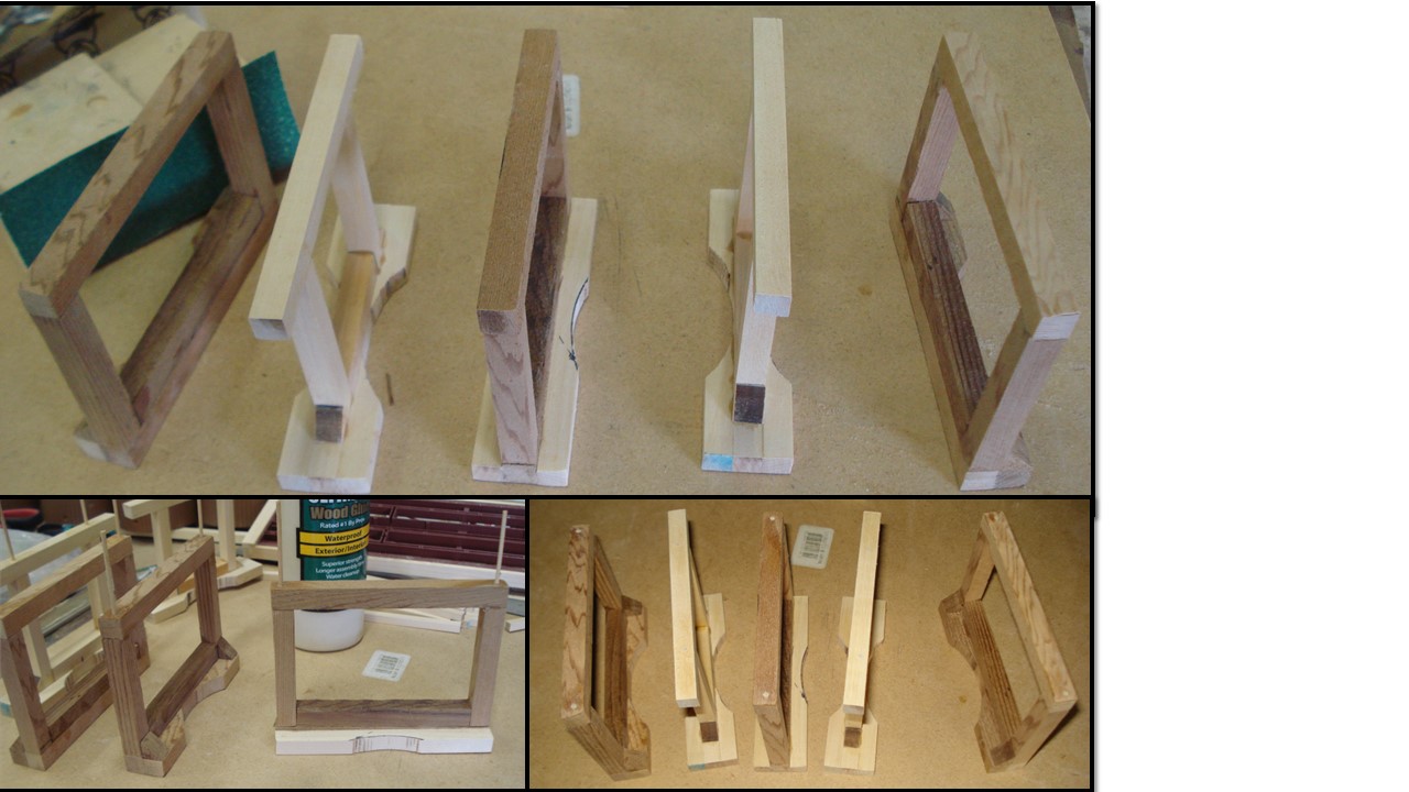

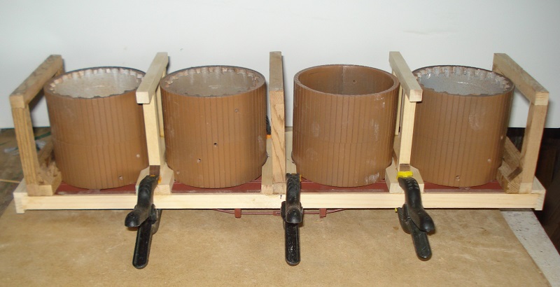

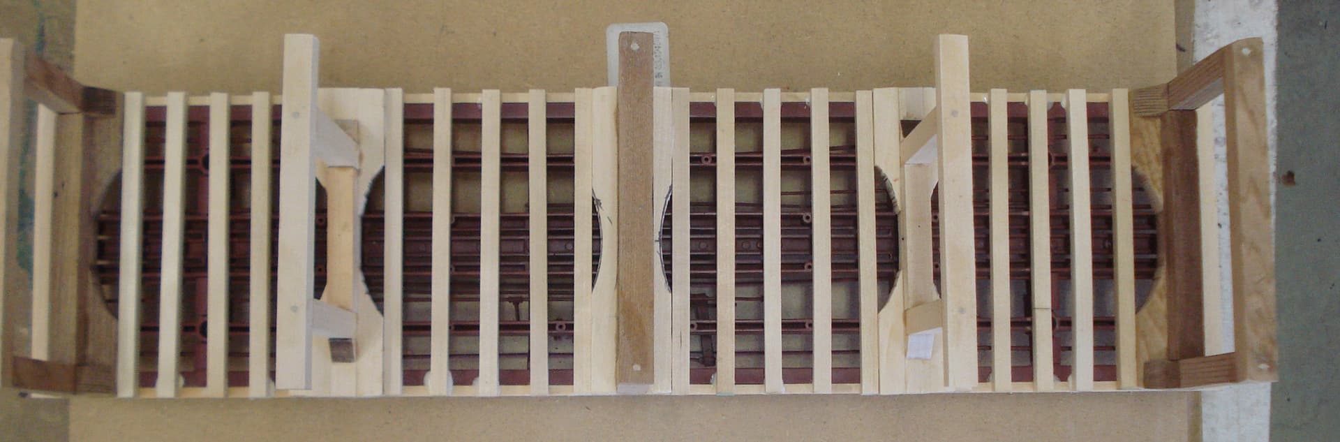

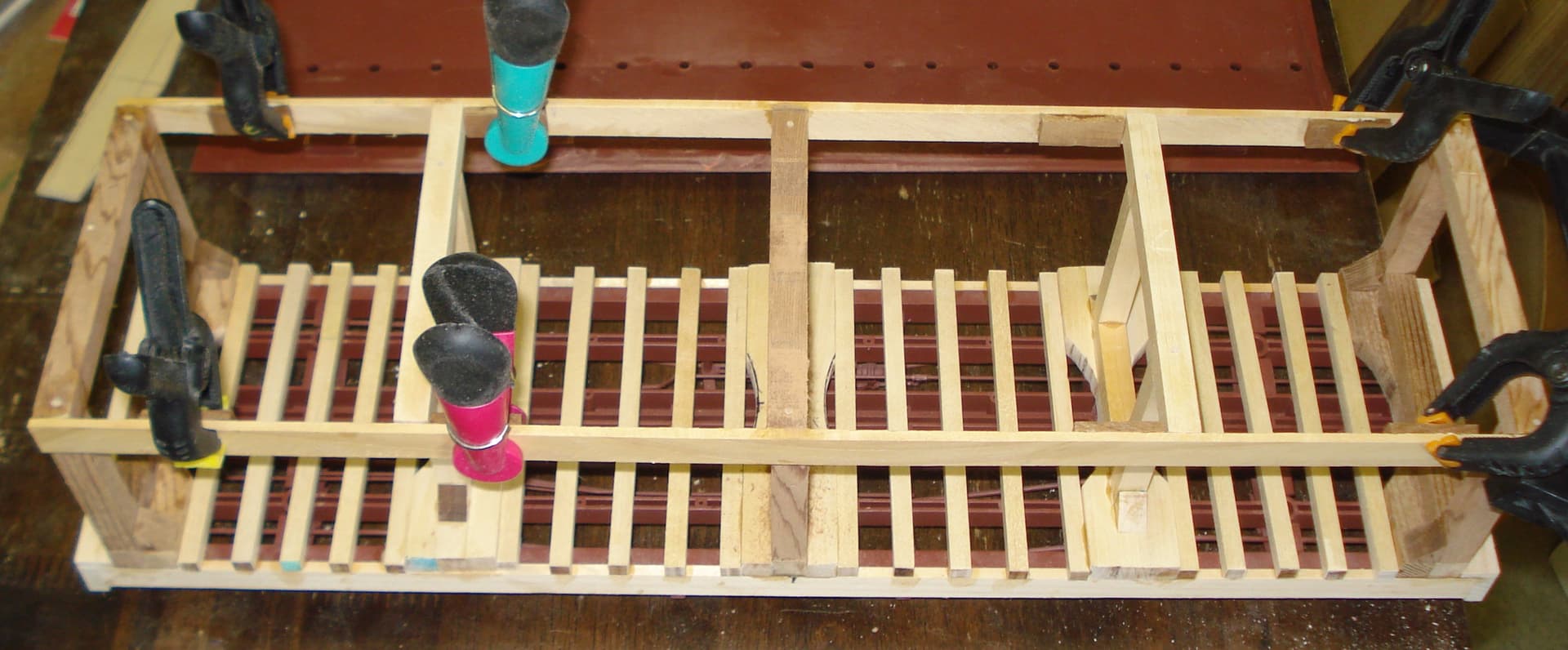

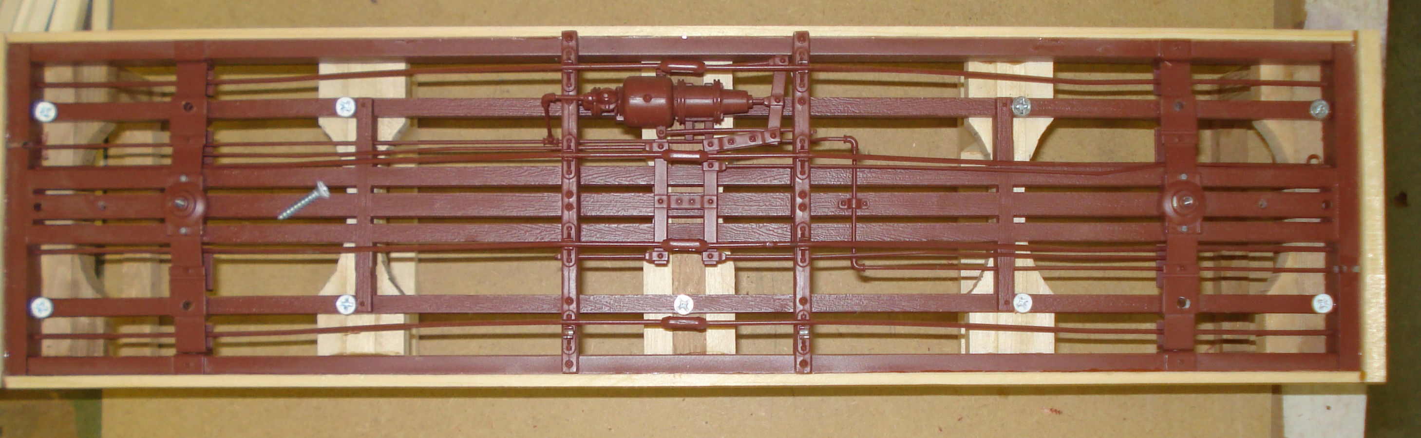

To give the car strength I ran screws from underneath into the center supports. This holds them firm while still allowing me to remove the second and fourth pieces. They have to come out so I can install the completed tanks.
I like the look of the open deck. When installed the tanks are large enough to hide the hollow frames.
To hold the roof, the top frame is attached to the end and center supports. The second and fourth supports will be glued in at final assembly.
The door guides and clamps are removed from the roof. I left the lower part so as to have more surface area contact when I glue the roof on.

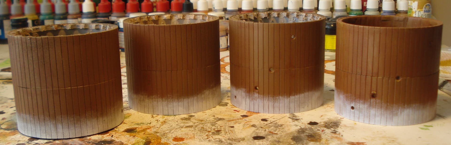

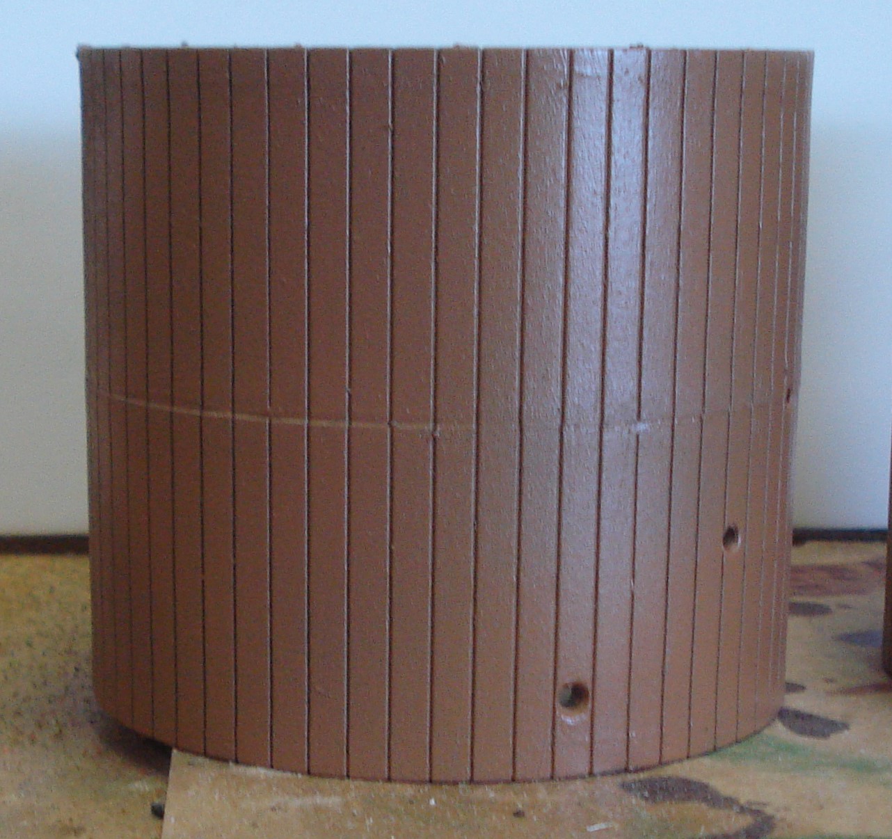

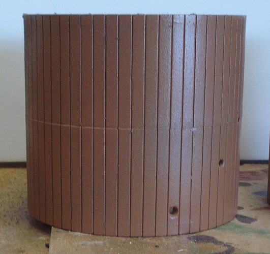

And now back to the tanks. I have given them a medium brown base coat. Next will come dark brown wash then some highlights with lighter brown shades. A little gray and then some stark white around the base for salt brine crystals.

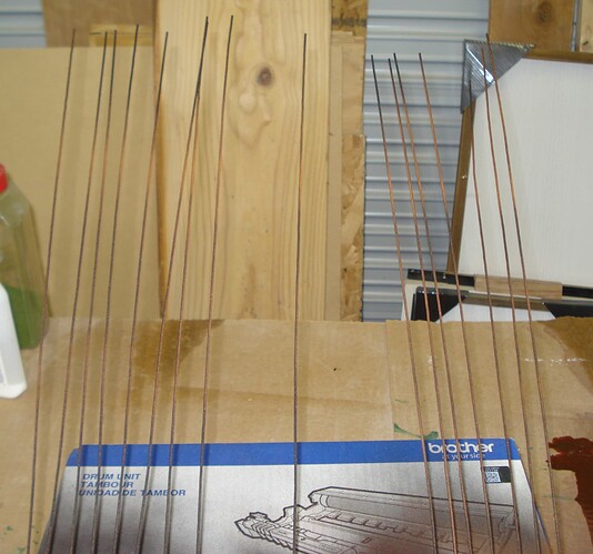

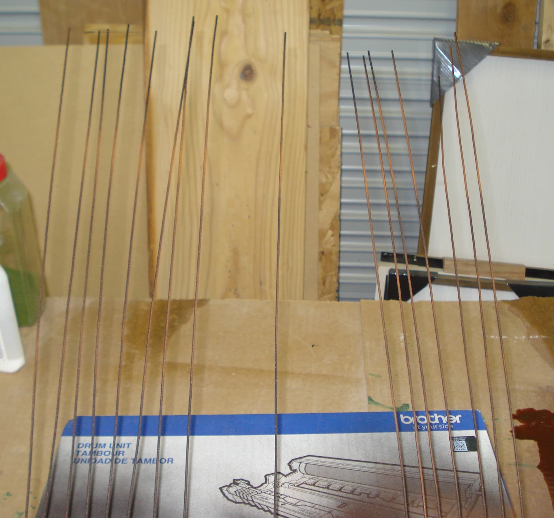

The bands are made from floral wire. It has been painted red oxide with some rust mottling.
While the paint dries I need to figure out the clamps.

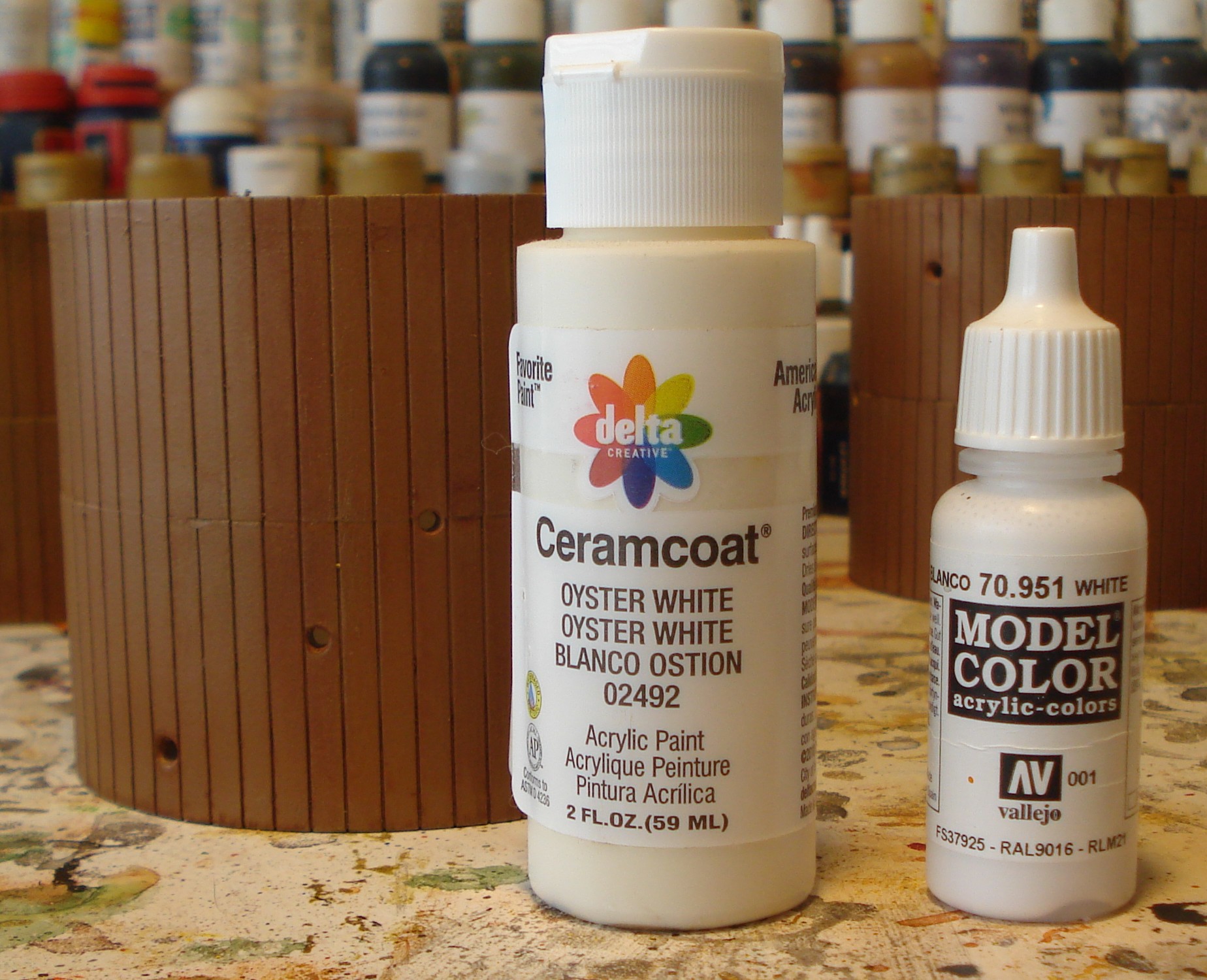

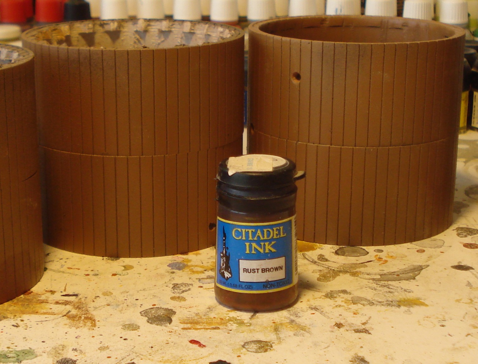

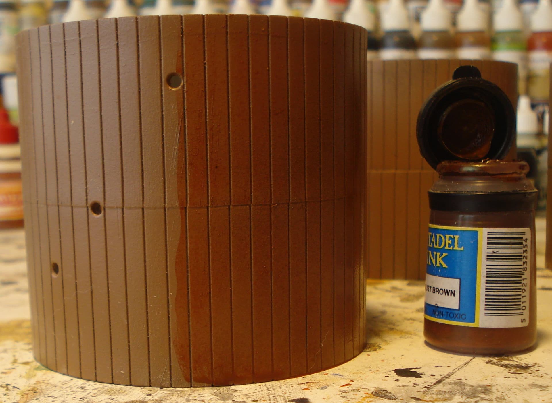

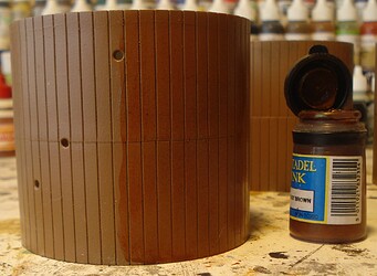

Tank painting. First I put a wash of rust brown ink. This is to give them a depth in the joint lines without it being to stark of a contrast like black. This is an old bottle of Citadel but similar washes and inks are available from both Vallejo and Games Workshop. You can see the difference it makes over the brown spray paint I used as base coat.

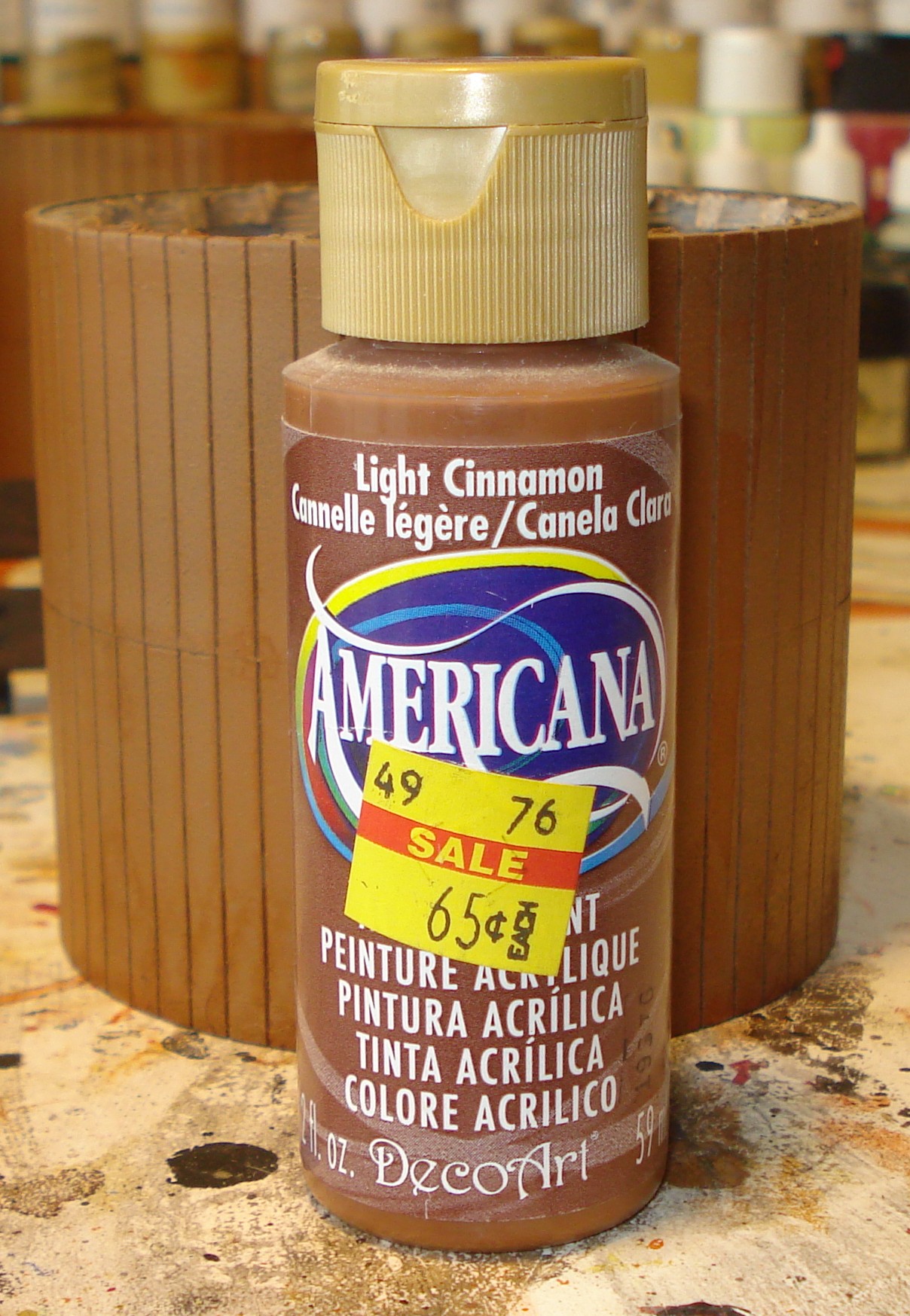

Once it was dry to the touch I dry bushed on a wide layer of Light Cinnamon craft paint. I have mixed results with these lower quality paints but every now and then I find a good one. Usually in the earth tones. The layer is pretty broad (but not solid) since it is the contrast tone for the variegation in the wood staves. I am brushing top to bottom to keep the wood grain moving in the right direction.

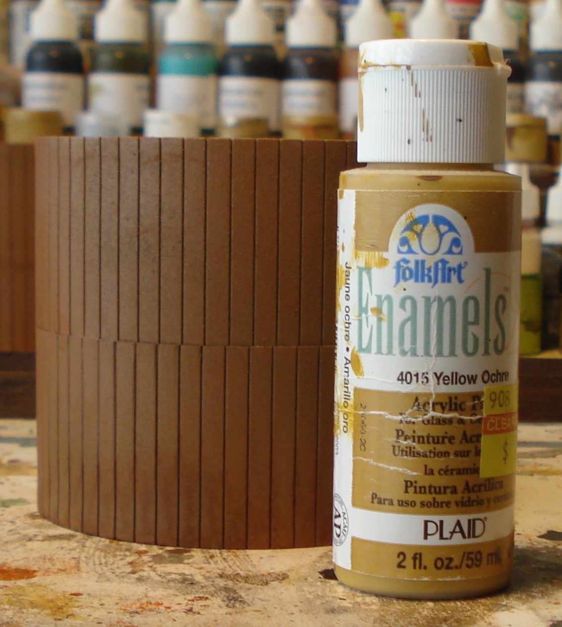

Time to do the highlights. Once again I am using a craft paint, Yellow Ocher. Top to bottom as before but these are light intermittent strokes .
The vats look pretty good so I am going to stop here with the wood colors. For the salt brine residue I am using craft paint, Oyster White first and final brush of Vallejo Pure White. This part is brushed from the bottom up.
Need to take these outside and get a matte clear coat on them. Don’t want to mess up the paint while I am fitting the rings.
