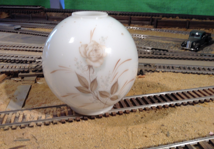

I’ve been looking around, basketball is too big, softball is too small, volleyballs a little too big it seems and not round anyway. Found the perfect size at the dollar store per my daughter’s suggestion, but it’s filled with air and that can’t be good.

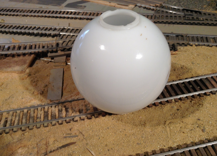

I came across the top of an old lamp, has a glass globe on top, and took it to see if it would work using the eye test. I think it might. I’ll post pictures tomorrow when I get a chance.

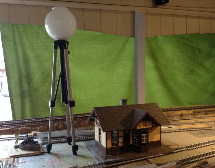

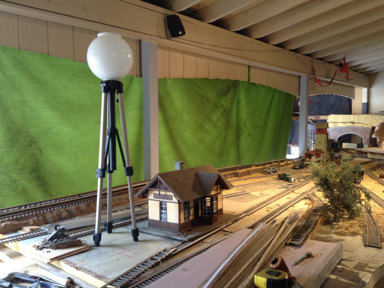

I’ve settled temporarily or permanently on this size and height for the water tower. The ten-inch Christmas ornament seemed too big to me, and the six-inch one seemed too small. But I found a (free) glass globe from a lamp, which is 7 1/2" in diameter (not radius!) and I found an old camera tripod and adjusted it up and down until I found a height I could visually live with in terms of overwhelming surrounding structures. If I break the globe, I’ll settle on an eight-inch Christmas ornament.
The station in the picture is something I had laying around and used it in the set-up for a sense of proportion. Someday…someday…I’ll have a station and a small hotel on this end of the yard, no time soon, but I tried the water tower in various spots and this end is where it would be most at home. So Devon, if you will please, will have to tell me how many gallons of water it holds at 1:29 scale and how much pressure I’ll get at 35" to the top of the water tank, and how many taps that’ll supply. I’m thinking it might be about 20,000 gallons and it should supply a few buildings in the yard, anyway.

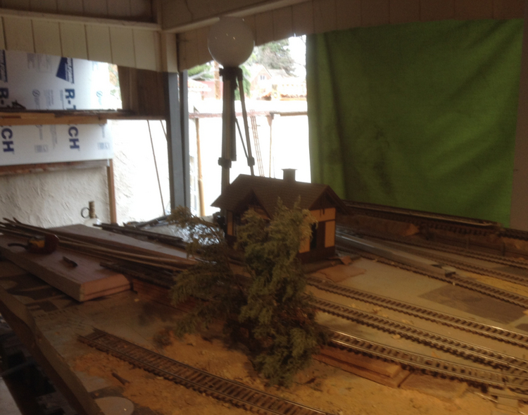

But here’s the globe and the set-up I’ve decided on:

It’s probably short for true scale, but I like what you came up with. It’s not so short so as to not be believeable, but not tall enough to overwhelm the space neither.
hmmm…
what timeframe do you use?
if i look at the station house, it looks very old fashioned in comparison to a round water tower.
