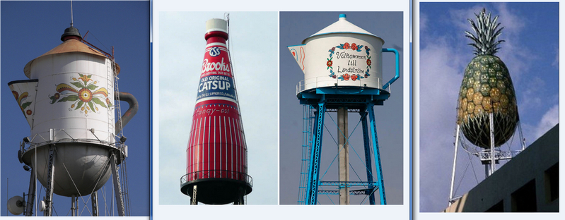

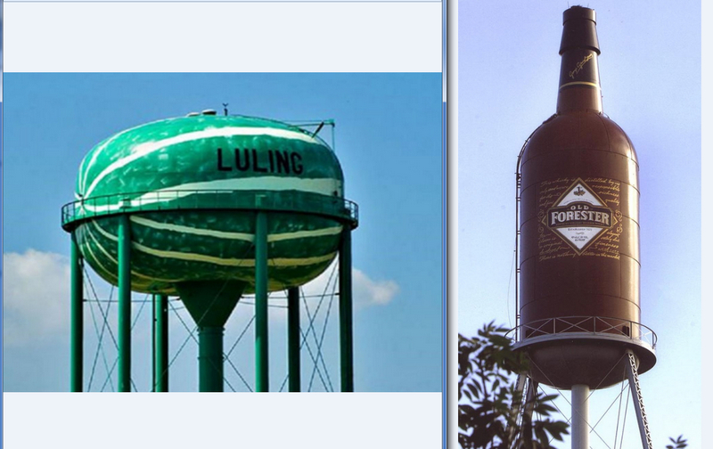

Novelty advertising towers:

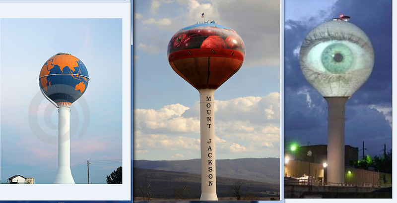

Towers painted in some artist or unusual way:

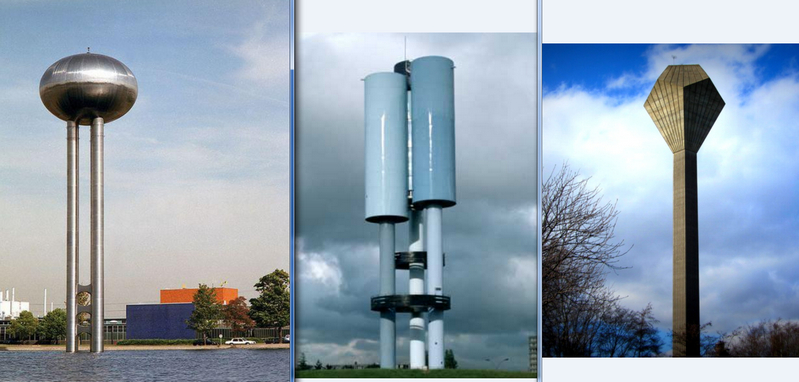

Space-age-looking towers:

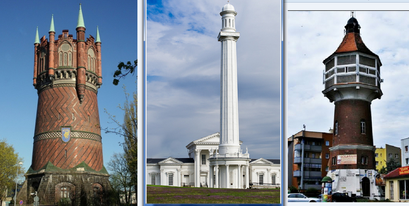

And finally, towers that look like brick-like structures, often rather “castle” looking, mostly European although there are some in the United States like the Chicago water tower, for instance:

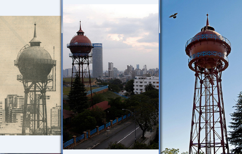

However, the one I have tentatively chosen is in Johannesburg, South Africa. It’s more utilitarian but its visually complicated and has a lot of interesting features and layers, including the interesting lighting rod assembly. To be perfectly honest, I’m not sure I’m up to this because I haven’t worked in styrene or metal, and certainly have never done any soldering like Bob did. Ain’t gonna happen. So I’ll have to get ingenious. Also, the project may be doomed from the start if I can’t come up with a believable height for the structure. I don’t want it to dwarf everything else on the layout, but it has to give the appearance of great height at the same time. And the tank on the top has to be big enough to plausibly hold enough water to make all that construction seem like it’s worth it. I don’t know.

I don’t care who y’are, that thar eye is just down right creepy. I gotta have one.
So then when you have that feeling that you are being watched, you can blame the water tower.
I love the first one: the Swedish coffee pot. I teach in Kingsburg where that water tower is…glad you found it.
Richard
