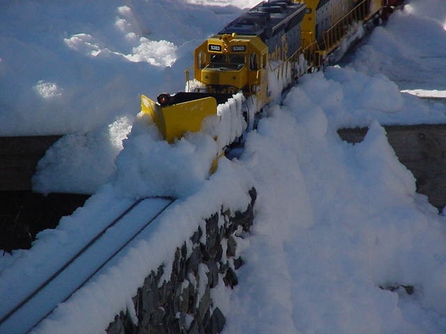

Don’t know why people have so much trouble running on track power. If you take your time and lay the track right you can run quite a while. When we first started all there was was LGB 1600 curves and three foot straight track. We ran for about 16 years before we had any problems. We could take a LGB engine and run anytime. Aristo and other manufacturers we had to clean the track.
So, in Omaha, you can run in snow?
No splash of rain and ballast?
No slug tracks, no coyote pee, no pine needles…and no volcanic acidic soil?
Not going to start a war. Each person has his problems I guess.
Curmudgeon , You can run in any weather in Illinois. Rain, Sleat, Snow or Hail. on track power. Never have had a problem.
Some of us use track power to keep off the cats , worms ,slugs . A bit of rain and the water boils and dries out the ballast . Why do you think it’s called a Main Line ?
Never had any problems running on track power up here in the North Country…rain…snow or even sunshine…:smiley:
