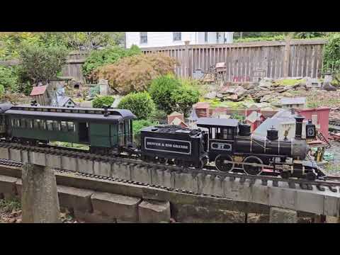

And here they are in action on NaptownEng’s Spa Creek & McKendree RR.
Interestingly, they still fit the original boxes, as the box has 2 end pieces of styrofoam to cradle the platform, steps, etc. Can’t close the box though.
And one last pic on the SC&M.
And, as the cartoon says, that’s all folks! Though I am still eyeing those ends that I cut off. . .
Those came out great! They were well worth the effort!
Echoing Eric, Pete, they sure did. And they look great behind that Hartland 4-4-0.
