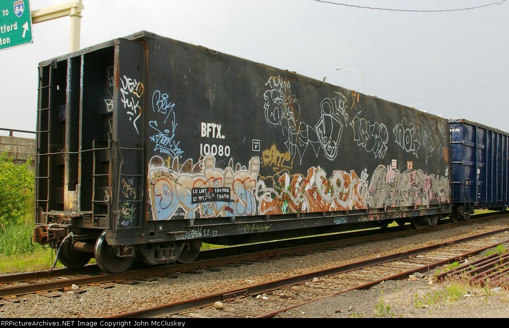

Here’s a better picture of the car i’m making.
I like it ! Looks like you’ve dabbled in the world of graffiti some too. The T in rooster caught my eye right away.
Note that car is headed west at high speed distorting the t

Some woodchip cars have a door on the “A” end, others have rotary couplers and are dumped via a rotary dumper. The cars with a door are unloaded with a front end loader…
That said, the proto photo looks like scrap steel service not wood chips.
