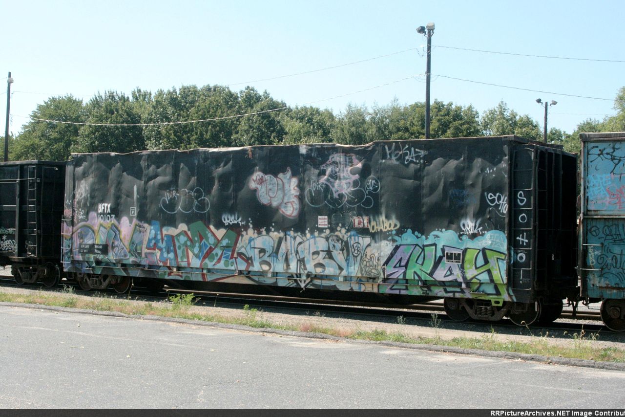

These cars are used for construction / destruction debris. They are like big dumpsters on wheels , all beat up and crusty . These cars do not have any doors but there are some types that do have large doors on the ends of the car.This car has end doors and is another car I hope to model some day.
Here’s a link to a video of HO scale models of these cars. This guy is really good at weathering and gave me the idea of building some of these for myself. https://www.youtube.com/watch?v=BM1_W7lELyQ

Here’s a picture of the real car. As you can see the sides are really beat up.
Just a couple of dents there, I’d say “slightly” used (http://largescalecentral.com/externals/tinymce/plugins/emoticons/img/smiley-wink.gif)(http://largescalecentral.com/externals/tinymce/plugins/emoticons/img/smiley-laughing.gif)
