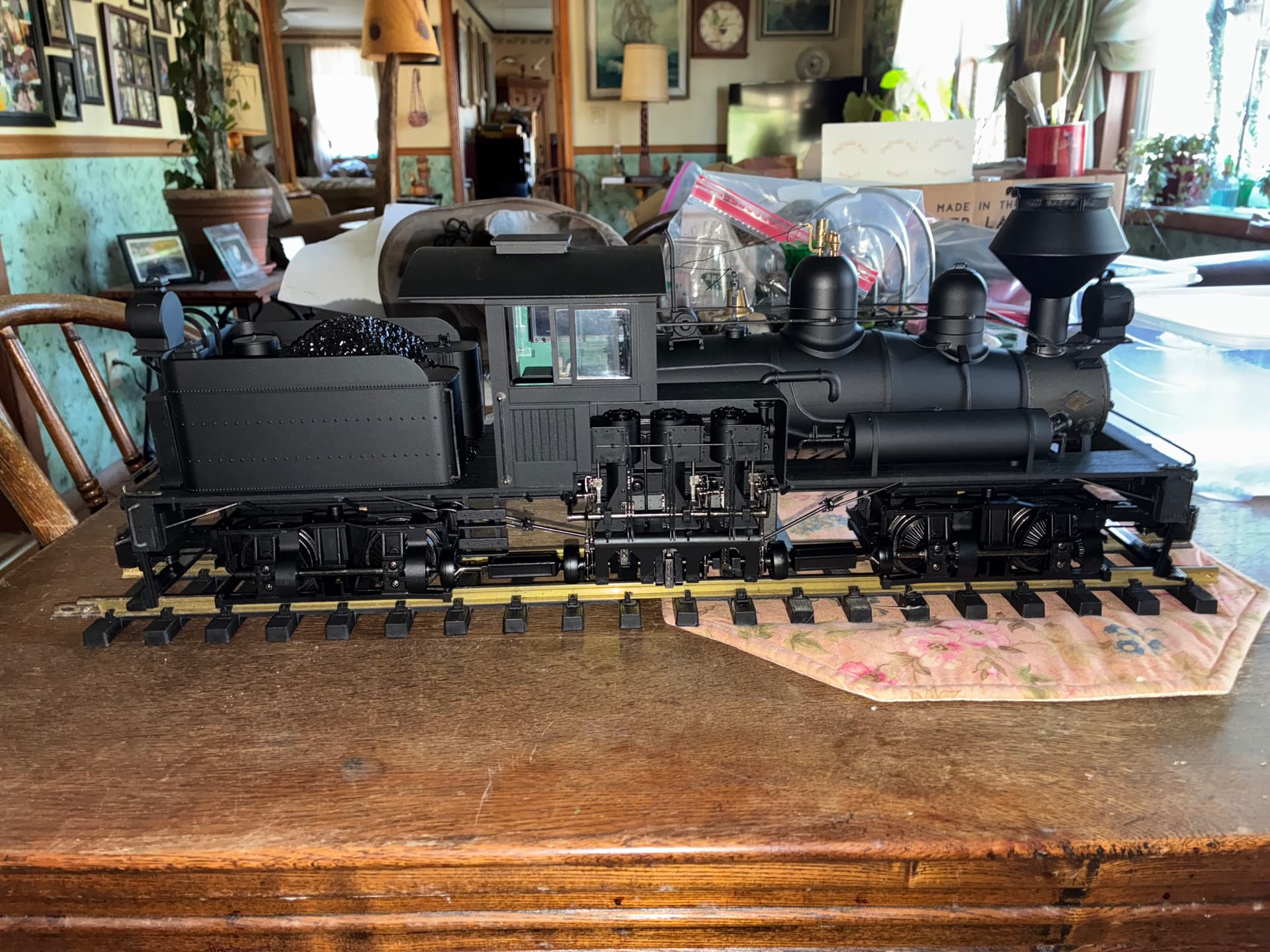

I bought a Bachmann Spectrum 36 ton 2 truck Shay off eBay. I don’t think it has ever been run. Got it in the mail and all four gears on the drive axels are split, in researching I found it is common. After some searching I found replacement gears made from Delrin. It is Maries favorite engine after she found some videos on FB.
Mark,
Check the motor block casings for cracks and fatigue as well also the internal bushings and spacers. A lot of them, especially the early ones, had a bad plastic that fell apart over time. If you really love the engine you may want to consider a set of replacement ( all metal) trucks. Expensive now days but may be worth the investment to you.

Thanks for the links I had not seen them in my search. I did see that the plastic trucks break down and do plan on replacing them with the metal trucks, the plastic ones are good for now, no cracks yet. I just have to wait for the purchasing agent to get over how much I spent on the engine and new gears. :grin:
The Shay’s are really cool. Unfortunately they are by Bachmann and split gears are a fact of life as is the crumbling trucks on the early run 36 ton Shays. I think at one point Bachmann was actually sending out replacements.

I had to buy the up fitter metal trucks and gears from Bachmann for mine as well.
I got them from what was San Val, now run by his daughter.
Yea, when Bachmann first acknowledged the problem they introduced the metal trucks and you could get a set for $99. I changed out my three 36 tonners and built a 3 trucker using them. I also changed out several for other club members, pretty simple process, wish I remembered how I did it :laughing:

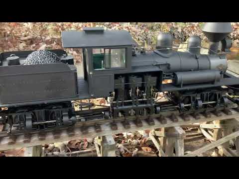

[36 Ton 2 truck Shay](November 20, 2025 https://youtu.be/PanPVRV_yyA)
Finally got the new gears in and test run it out side. Will have to get steel trucks for it as the plastic ones are starting to get cracks.
