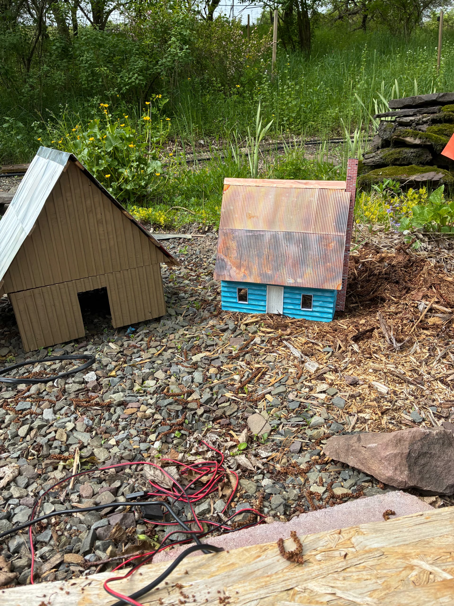

This is one of the houses with the copper roof. I heated the copper to try and get it to change colors, after I did the roof I did some research and apparently I am getting the copper to hot and its going past the colors I am looking for. Will be trying again.
Try Muriatic acid, it will give you some interesting coloring.

Here are a couple of screen shots of a Mansard I did on a building in Redding, CA some 50 years ago. Not good pictures but it gives you the idea.
I know that just about everything on the internet tells you that copper will have no reaction with Muriatic acid but that is just another internet legend.
Muriatic acid, I will give that a shot, I think my local hardware store has some if not they can order it. Thnaks
Try a swimming pool supply, probably cheaper, but the hardware store may be able to get it in less than a gallon size.
Edit to add; Be very careful about breathing the fumes of the acid, not so much the acid/copper combination but just the acid itself.
Way back in the day, I used a solution of diluted Muriatic acid to clean the innards of the Penberthy 1/2inch water injectors for the Dry Gulch RR locomotive. The acid would brighten those bronze or brass parts after they had been dulled and scaled by the limestone in the local water. I could usually pull the innards, dip them in the acid, rinse them, reinstall them, and have the injector working in ten minutes or less. Care had to be taken to avoid contact with the acid. The solution we used was pretty powerful stuff. I’m not sure whether it will weather the copper or brighten it. Probably best to do a trial on a small sample. Your results may vary.
Just saying, David Meashey

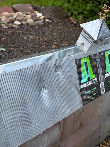

The town had a hail storm last night and suffered some damage. In real life it was various sizes up to the size of a quarter and scaled to the town that would be the size of a basketball. I was figuring on more damage and glad it was not. Some I will fix some will be scars left from the storm.
