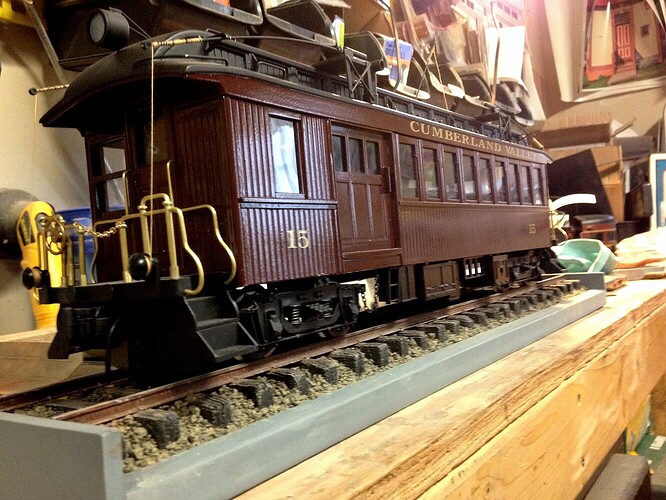

When I did my CVRR motor car. The PRR was in the process of taking over the CVRR and this car was in Tuscan. CVRR Electric Motor Car #15
I used Rustoleum Kona Brown in a rattle can available at HD. It only comes in gloss and I would have preferred a semi or flat however I toned it down a bit with chalk weathering.

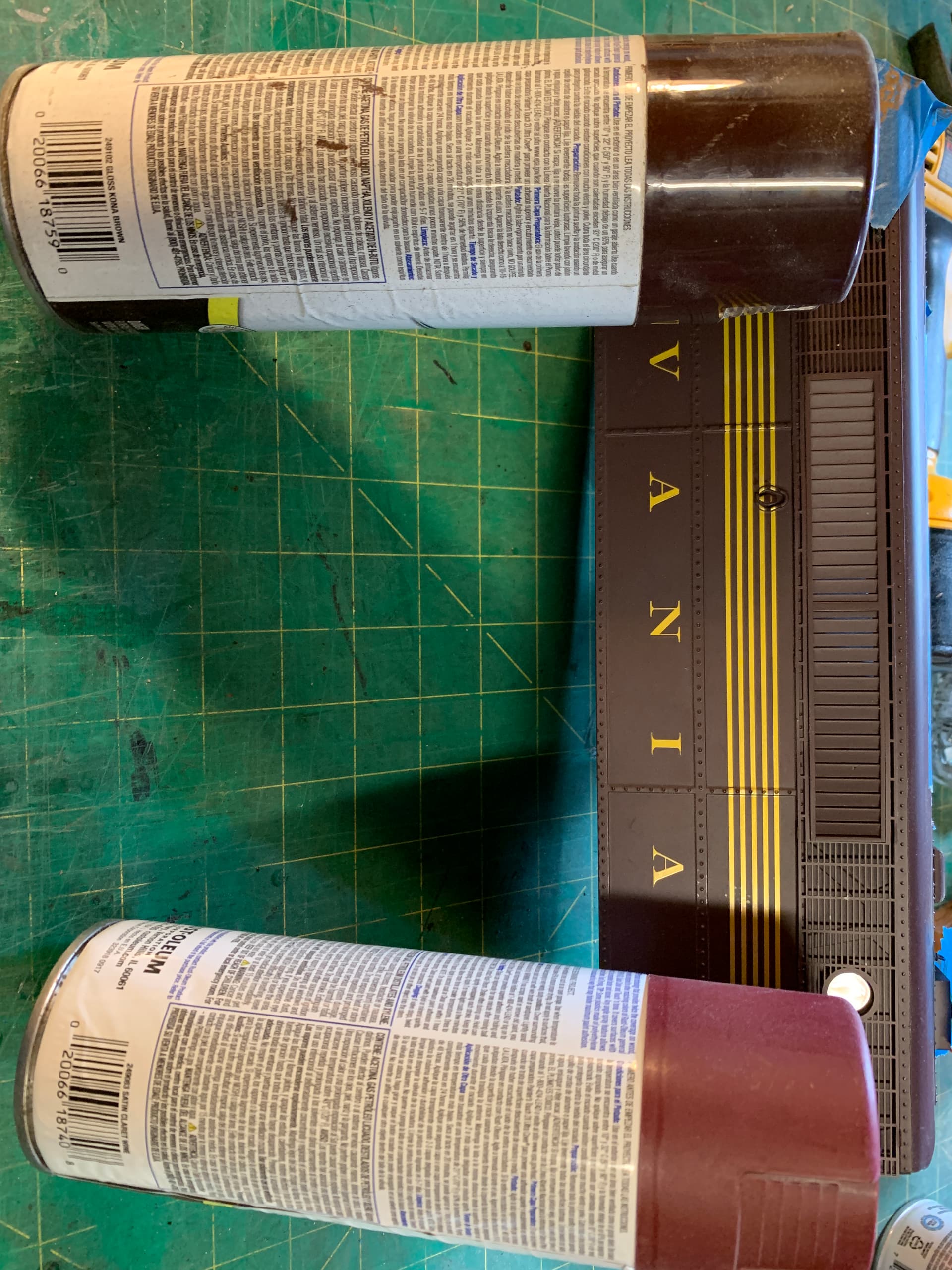

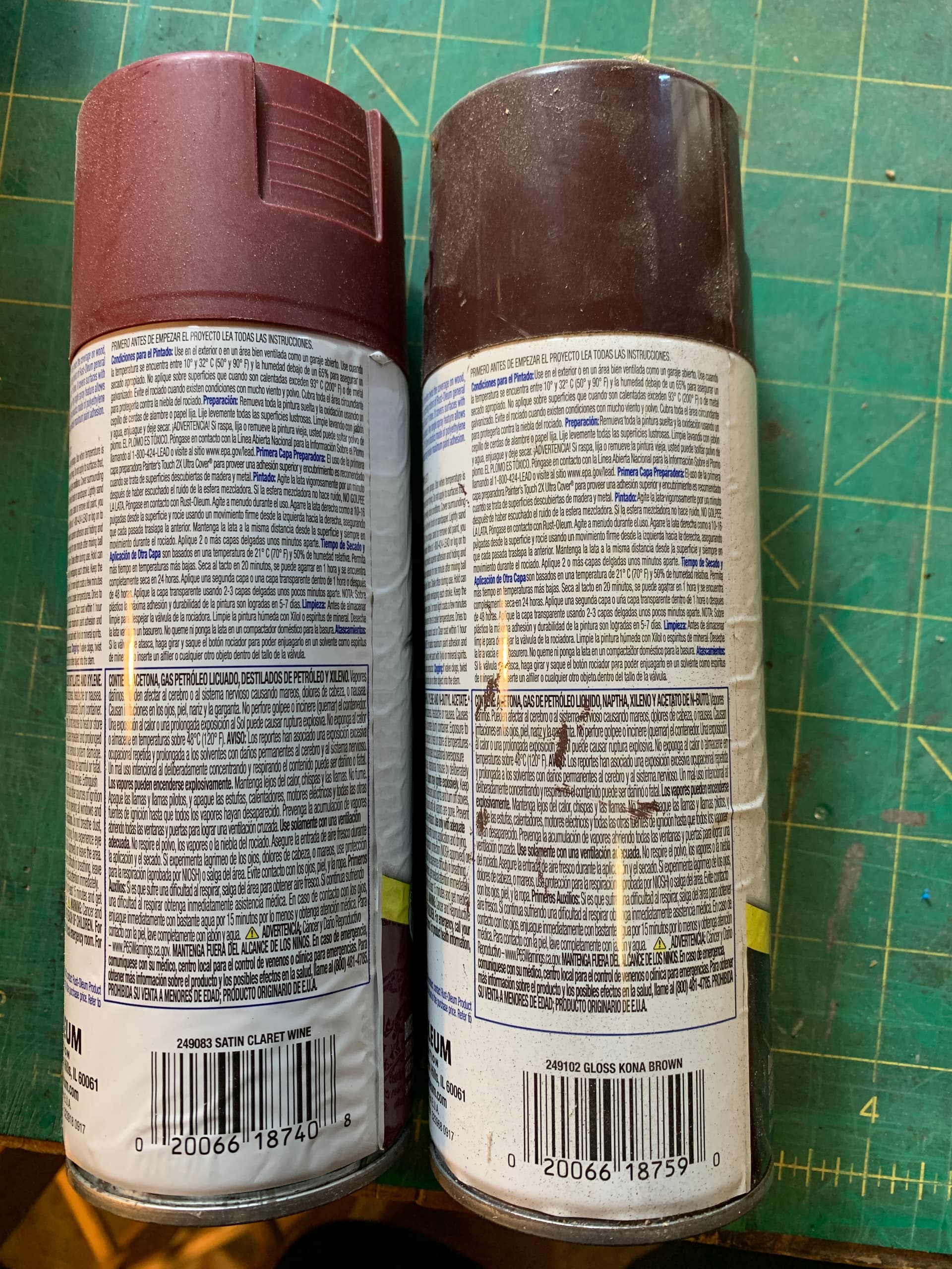

I went out to the shop and took some pics for you of an Aristo PA shell with the two colors I have that I will call Tuscan. The Kona brown is about as close as I could come with anything in a “cheap” rattle can. The other color is Claret Wine (Rustoleum) that was the color I originally chose but didn’t really like. If you want a “TRUE” match I’m 100% positive the PRR museum in Strasburg had the color custom made at the Sherwin Williams…with the information they have…lol

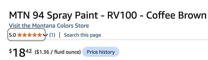

EDIT: I couldn’t find that primer here but I stumbled across this website. They are made in Germany.
“Ruddy Brown” isn’t a branded color. It’s just what they call any red oxide.
