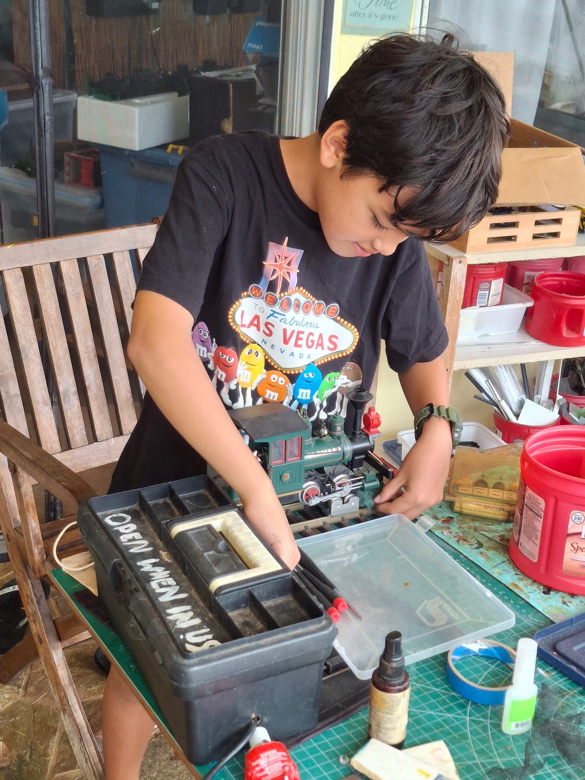

This was another one on the project list today. Kid-zilla lent an able hand as we let glues and paints on his latest rocket dry.
Meanwhile, after reprinting the parts diagram because I couldn’t remember where the motor went (the gears to nowhere did not cue me to the location), he got out the test rollers. We buttoned it up, and, of course, it failed. The next logical step was to see if we could find a break somewhere, so, we lashed up the following…
…and made the little motor spin. Like before, then, it seemed the tabs were not making contact with the metal bars that carry the power to the motor. I successfully soldered bits of wire to the motor tabs. I was not able to solder the wire to the metal bars. Not wanting to melt plastic, I opted to wrap the wires around the metal bars, button up Olomana, and put power to the wheels.
