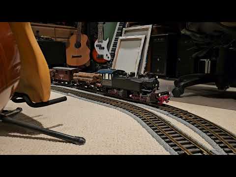

So, I finally got my LGB 2085D European Mallet to run! I replaced both motors but now believe that I actually did not need to. Both old motors run just fine when applying power directly to them. I did end up soldering one of the motor contacts to the contact point and that seemed to make all the difference and the loco runs. The only thing is even though it appears to be running smoothly, the rear powered truck seems just slightly slower than than the front powered truck.
Gah! So close! I am sure you could paint a white dot on a wheel, apply voltage, and count rotations. I haven’t the foggiest idea what the tolerances are for safe running. Frankly, I’d be tempted to just run this beast and enjoy a frosty beverage for a bit first.
Congratulations on getting this far!
Nice to see your persistence pay off! Hope you had a beverage to celebrate!
indeed I did. In fact… a couple!
Well-deserved after a saga like this! I know the feeling well!
