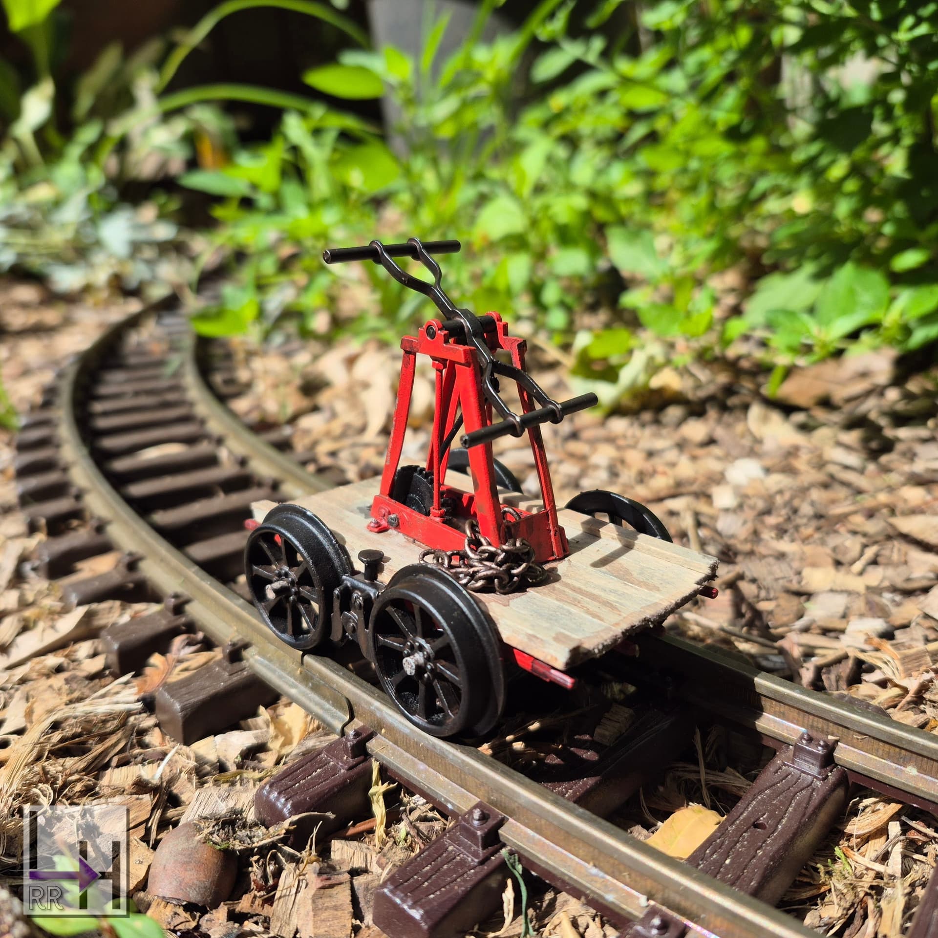

The most fun thing, I think, is the rail bike I am working on. It’s meant to be etirely 3D printed except for the wheels, which I am re-using from a NewBright box car I bought.
Still missing some bits in this shot, and this is v1. I already started v2 (longer buffer rods and some detailed spots to make attaching other bits easier). My main issue is that I have no idea how to get this thing to run! Suggestions are more than welcome.

Maybe some robotic people pedaling?
Many moons ago, there were “stompers” - little electric trucks that just happened to be the right size for gauge-1 track.
This is my speeder on a stomper with similar wheels to yours. It has 1 AA battery, and it ran twice around Roger’s huge RGS layout, including the 3% hills.
Casey Jones
For your little beast, you need a lunch pail or similar to hide a miniature motor/gearbox. You can buy these on eBay or Aliexpress. The gear ratio is the problem - mine was 40:1 so it was very slow. You then need another box (safety gear?) to hide the battery. You can get small 3.7V Lithium 16340 batteries, which are 1/2 the size of an 18650: 16mm x 34mm. 34mm will easily fit between the wheels.
Sometimes an object one would normally throw away will work for the model railroad. I cannot find the photo at the moment, but I once converted the box that held mechanical pencil leads into a credible model of a concrete milepost.
Regards, David Meashey
The left one is yours, I just stretched it vertically and scaled it up about 15 percent.

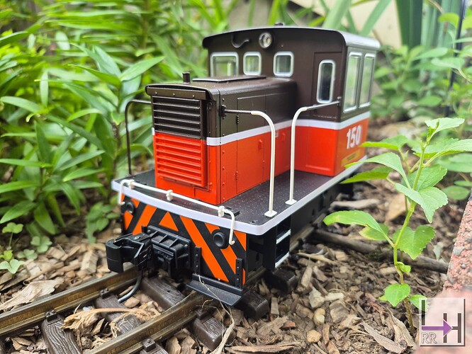

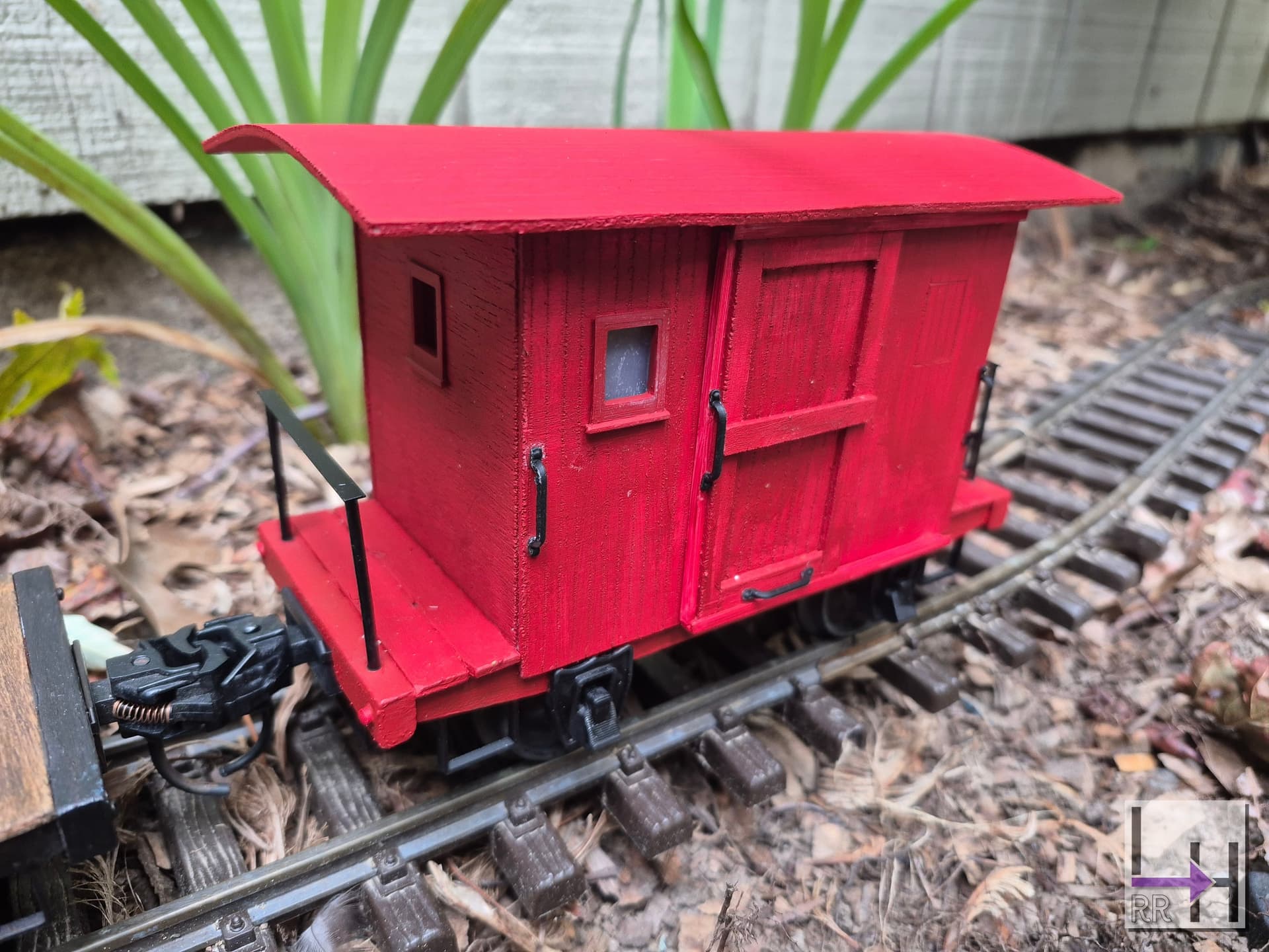

Today I managed to finally finish my 25-ton switcher! Thanks to, @RGSNH Al, I got the last couple of railings I was missing (read: that I broke) and I finally got them painted & installed. It is a model of Providence & Worcester’s #150, which the Seashore Trolley Museum now owns.
This car is completely scratch-built. It is a model of Mosum River Railroad’s #8 car, which is also a part of the Seashore Museum’s collection. I designed & 3D printed the chassis, the windows, and grab rails. The rest is plywood, popsicle sticks, and styrene. I am in the process of getting decals from Del (G Scale Graphics) for this car.
The process for this car is documented on my website.

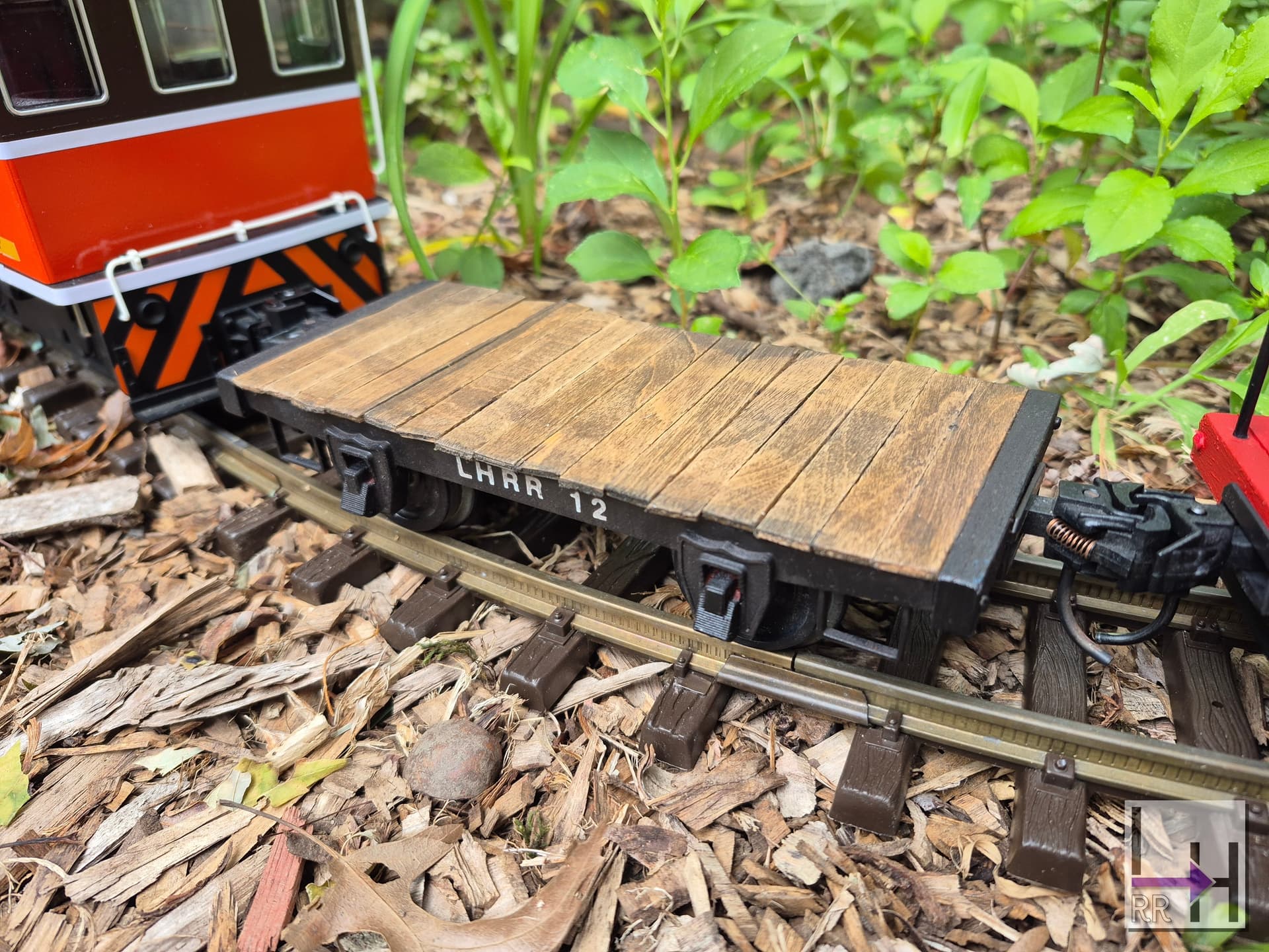

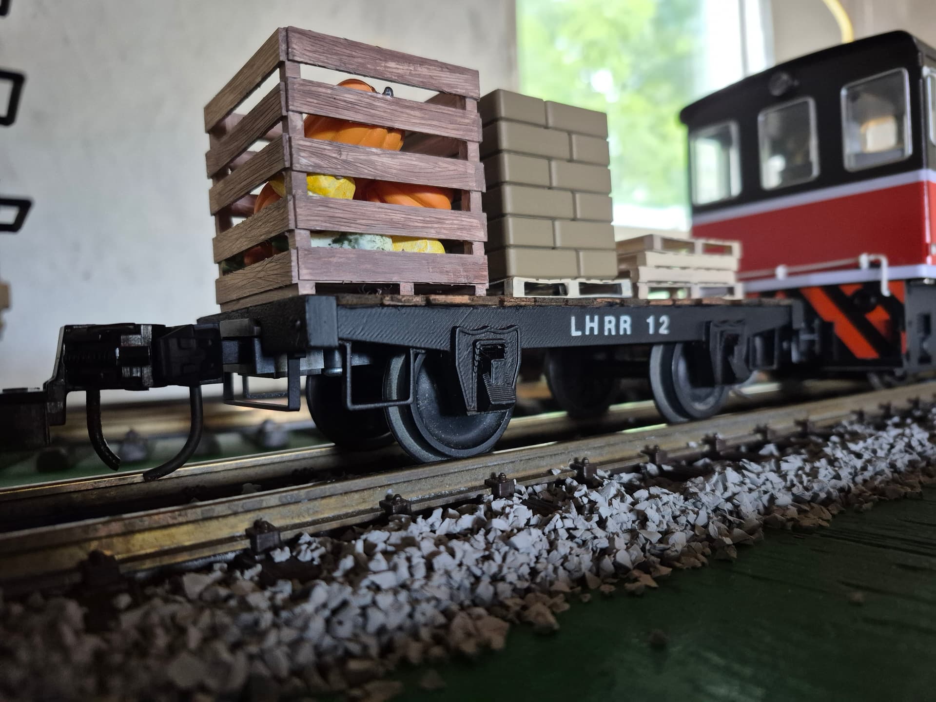

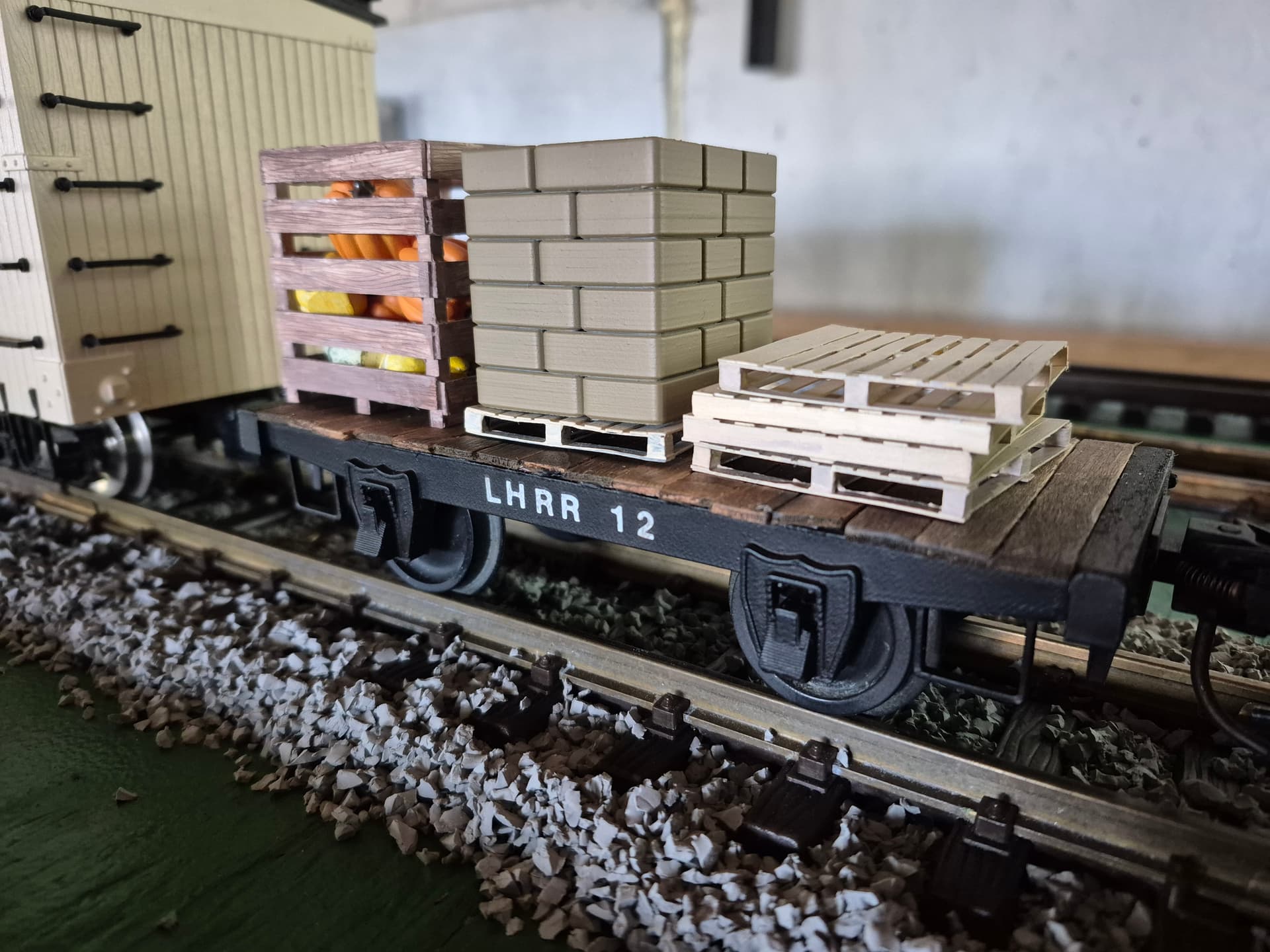

I also made this flatbed. It was actually a prototype for the MRRRCo #8. A stained pop-stick deck will play host to all of my fun little details I’ve been 3D printing over the last several months. Notes from this car are on the same page of my site.
More pics to come!
Great work, John! I’m looking forward to seeing your flat car load(s).
Looking good! That flat looks very similar to some 4 wheel flats the EBTF purchased from an industrial user. They will go into work train service allowing the historic flats to get a rest.

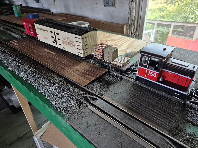

Here you go, Cliff! I finally took a couple shots the other day.
Oh, that’s awesome! I love when things work out like that. I just designed it based on the frame of my MRRRCo model sans body.
EDIT: P.S. This is the first time I’ve posted a photo publically of the progress of my modules since finishijg the level crossing! I am quite happy with it. The platform, too.
