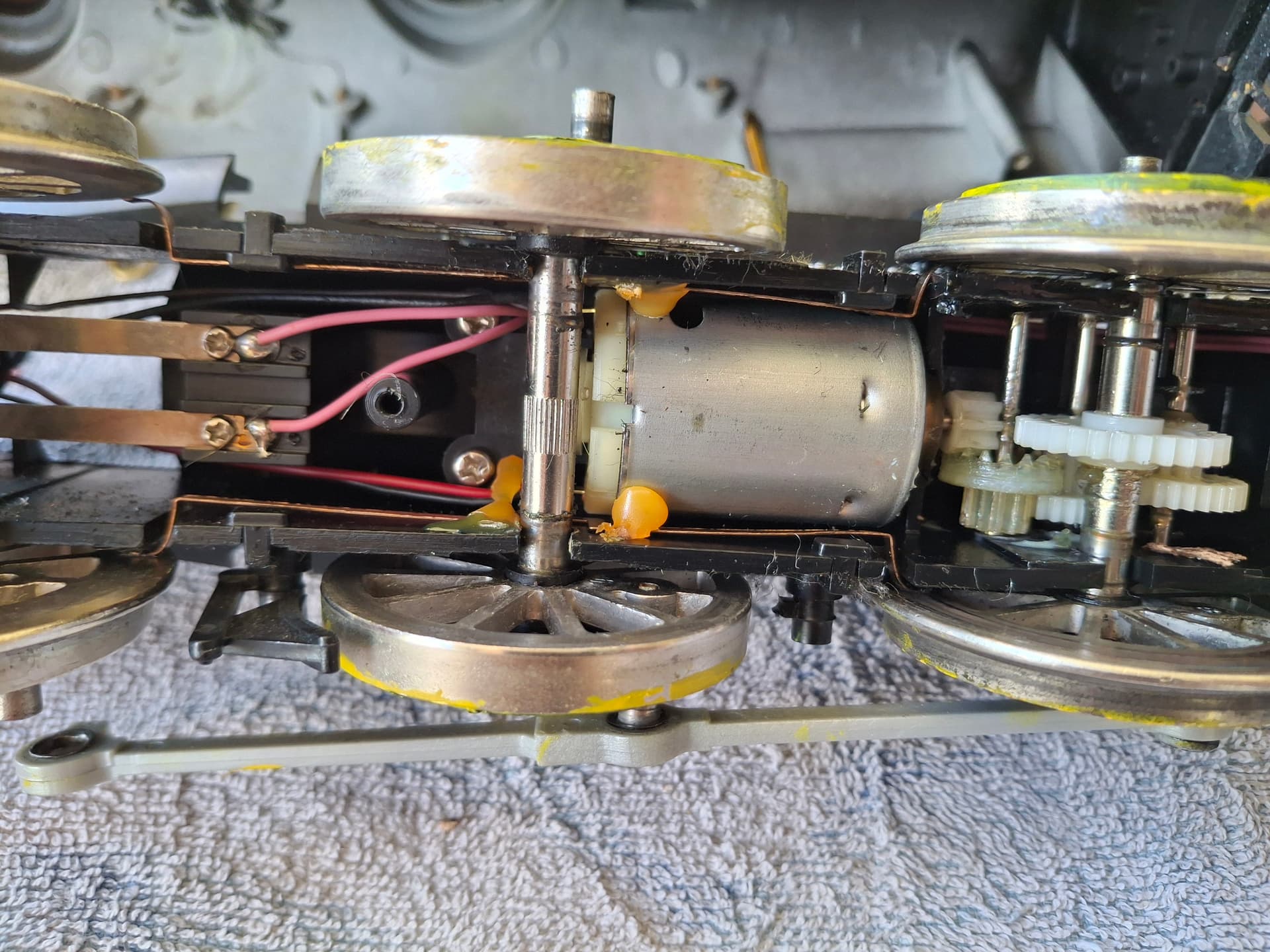

@PeterT 's chassis arrived on Thursday on Friday. Guess what? In addition to piston things and bottom-plate mounted buses, Bāmann had side-mounted busses to carry electricity from the wheels to the motor!
Who knew? Bushings, no bushings, pistons, buses, combinationsā¦bottom line, if Kid-zilla ever goes into business refurbishing derelict Bāmann 10-wheelers, heās seen it all! Back to this project, OCU-Bumblebee had these side-mounted buses; Peteās chassis had bottom plate mounted buses. It was time to hedge our betsā¦
You may remember from an earlier post that the starboard forward driver kept coming off. Sure enough, the plastic insert was worn, and the ridged axle would no longer ābite.ā Kid-zilla and I ransacked the bits box. He found a driver that would work; I found the buses and bottom plate to put Peteās chassis into service. PCU-Bumblebee looks like this:
The fixed work. While Kid-zilla is not thrilled with the looks, the rest of us find it sort of whimsically charming. Peteās chassis, meanwhile, is in reserve against future need.

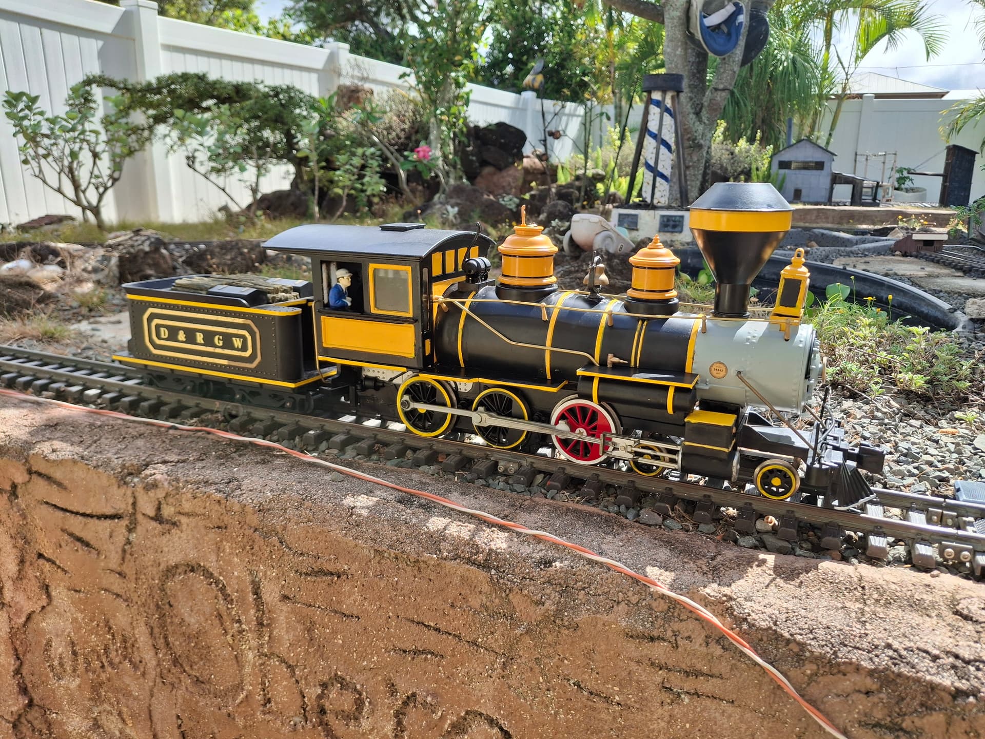

Kid-zilla also gave PCU-Bumblebee his number, applying a vinyl ā9ā to each side of the cab (thanks for those numbers @Rooster !).
Again, overall, it looks sharp. I was dubious about the color scheme, but I really canāt wait to see her in service!
It took multiple sixes and nines, but we also got some black dry transfers on the lamp which we sealed behind clear gloss.
Unfortunately, running tests were a bit rough. My homemade pilot tends to come off the rails, so more tire trim weights are in order. Also, PCU-Bumblebee stalls on turnouts, so I suspect I have to putter with those buses to ensure contact with the drivers.
Al-most-thereā¦
Those pilots are very long, and have no flexibility - and thus donāt pick up power if the track isnāt perfectly level. If you are still using the metal strips and pickups, then loosen the strips [they are what hold the axles/wheels in place anyway.]
(I thought there was a pic.) What I do is to remove the nylon spacers so the whole thing gets floppy. Then put something down the center to insulate the two sides - tape or styrene work fine.
