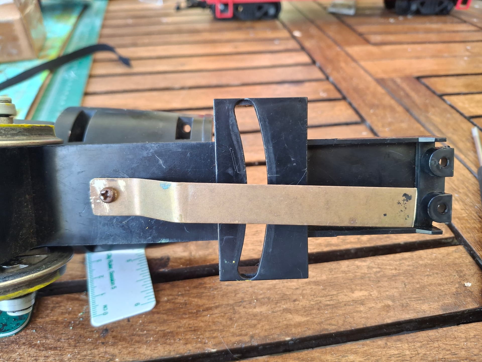

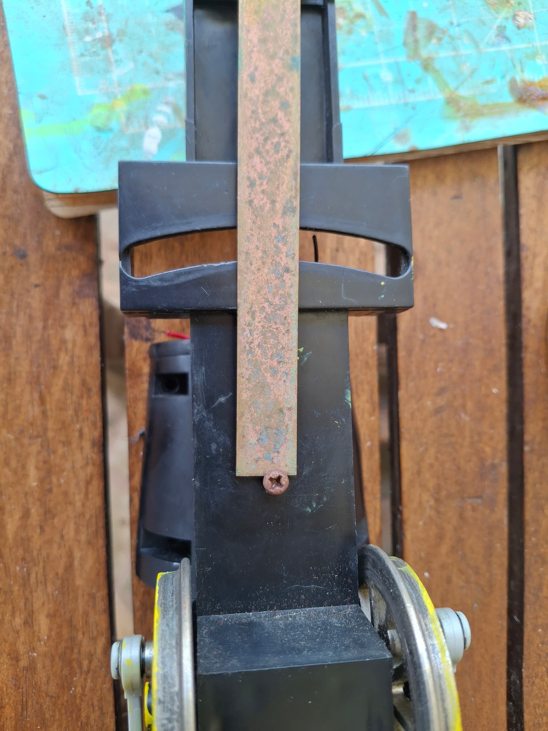

I would drill holes in the brass strip. Use a short self-tap screw to attach it to the chassis, into a pre-drilled hole. A small bolt and nut on the truck end should work.
OK, we’ll try that.

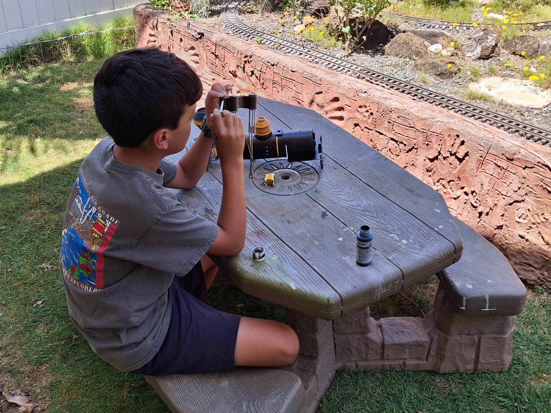

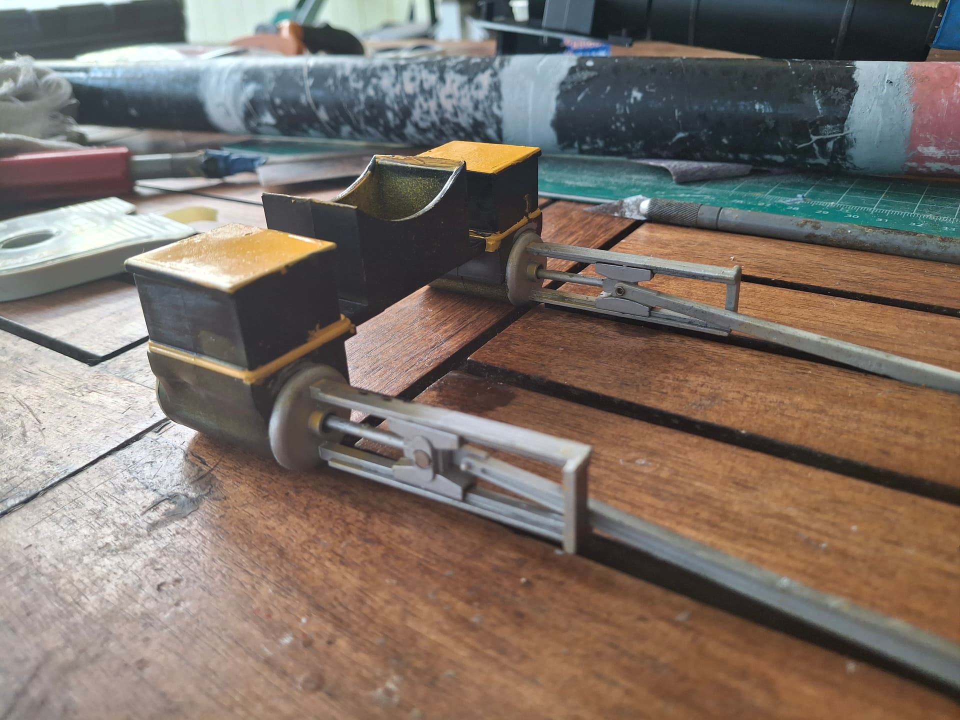

In the meantime, Kid-zilla has been busily masking and painting. Today, he took on the steam chest. He had previously sanded away all the flashing. He partially masked it, allowing a little paint to get on his fingers as a compromise to allow for finer control.
It took two trips to the Palm of Spray Painting. He took the photos below and provided the commentary.
He was busy using markers to touch things up when the sun went down.
Today, incidentally, he didn’t wait for me to come home. He was already at it. I think someone see the end product already serving the Triple O!

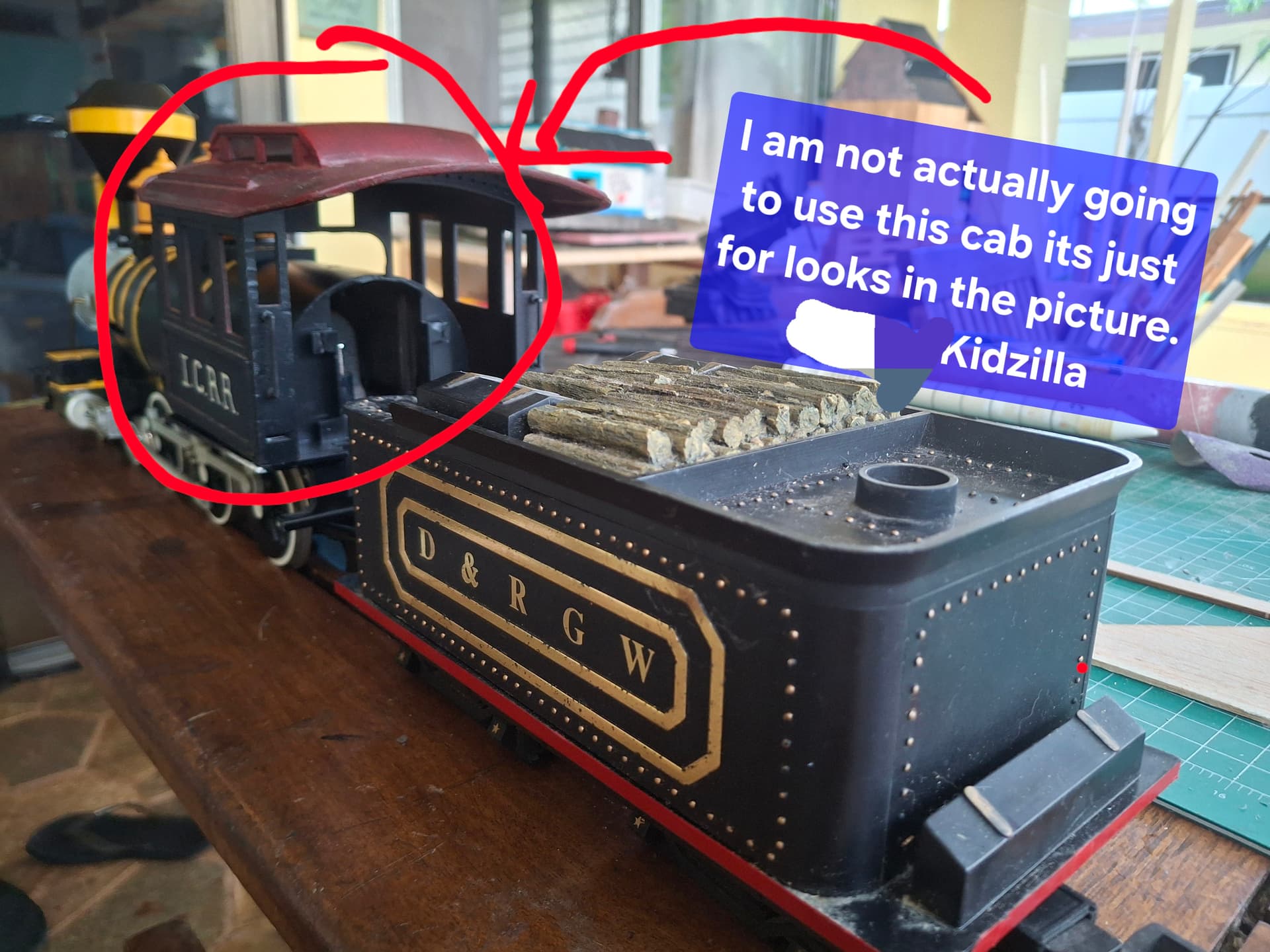

) to get PCU-Bumblebee as ready as possible to receive a Delton cab (Thanks again, @David_Marconi_FOGCH !). I am finding myself increasingly out of a job, with cries of “I can do it! I know! It’s my project!” coming off the lanai (Mixed emotions, here, if I am to be fair…). The main effort over the latter part of last week was the boiler, which he masked and painted. He also staged some shots to get a sense of what PCU-Bumblebee will look like when she takes the rails. The following photos are his:
He got some overspray onto the rods and guides, which he declared, correctly, “looks like weathering.” The yellow trim paint that oozed under his masking job on the port side sand lines, however, he plans to correct, though whether by hand or spray paint, he has yet to decide.

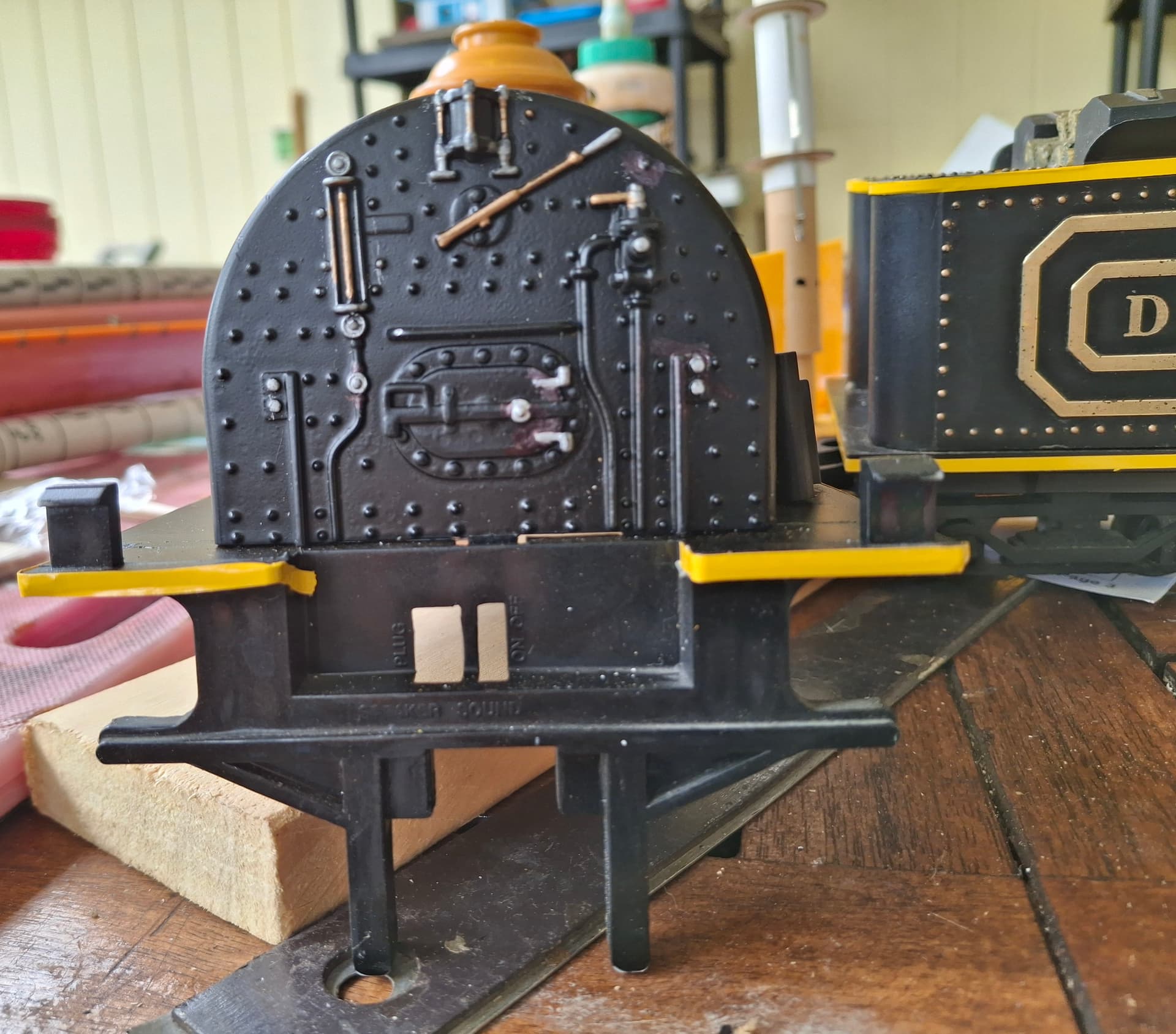

He also touched up the backhead with paint markers.

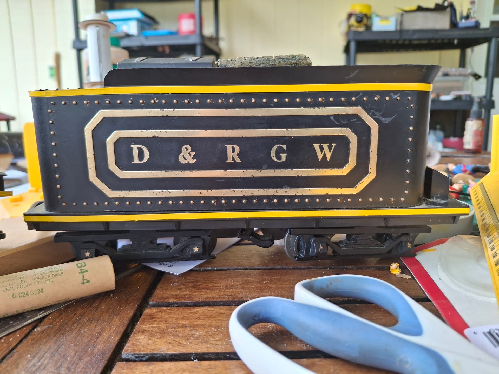

The yellow stripe is a trim tape that @David_Marconi_FOGCH forwarded along to us. That sped things up considerably! We found four hands were better than two, and I carefully peeled back the tape as he aligned it and pressed it flat. Here is the tender.
We did have to make small cuts to get it to fit flush on some of the corners near where the fireman will stand, but, other than that, it was a pretty hassle free process.

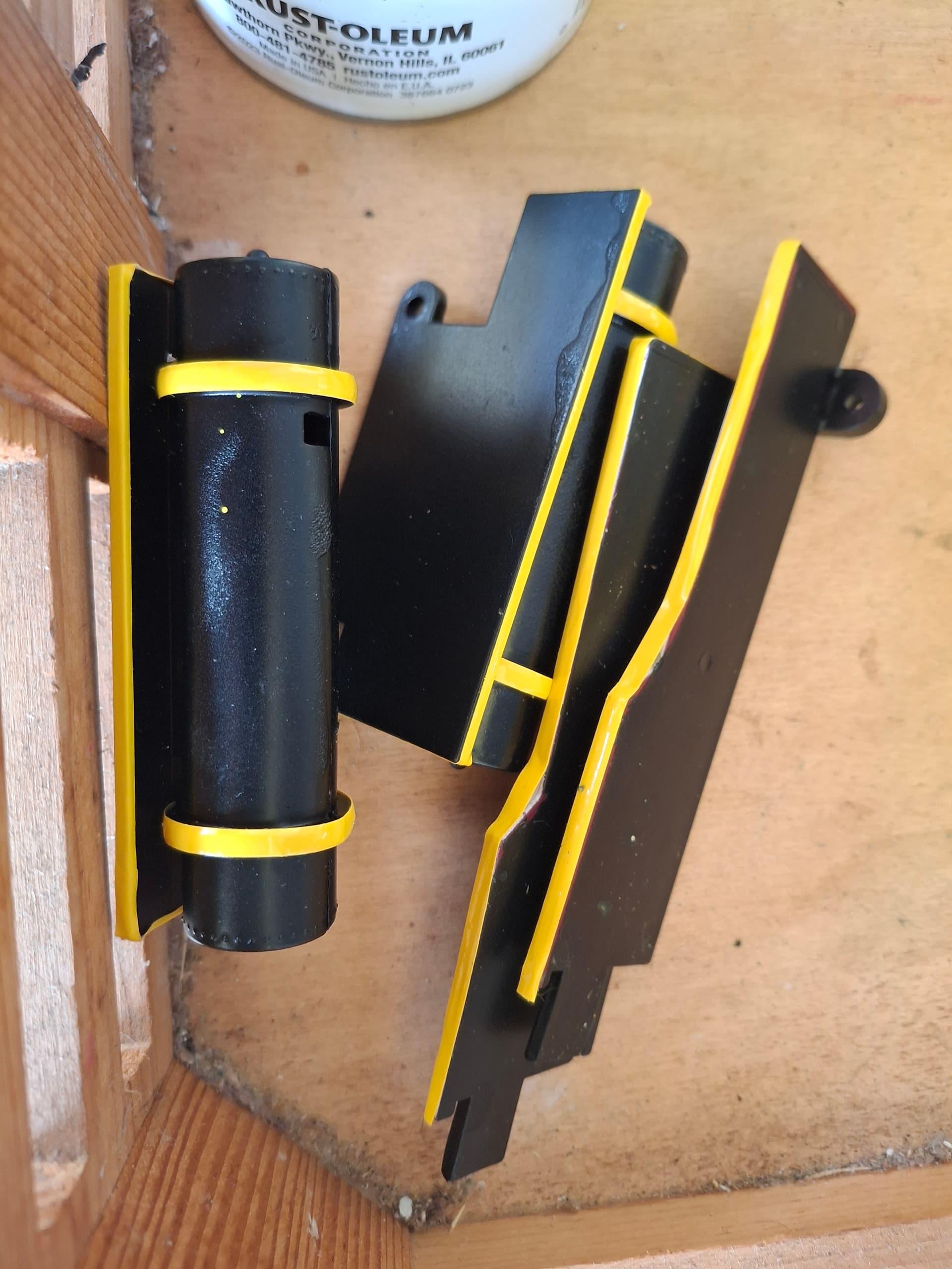

Air tanks and running boards got paint and trim.

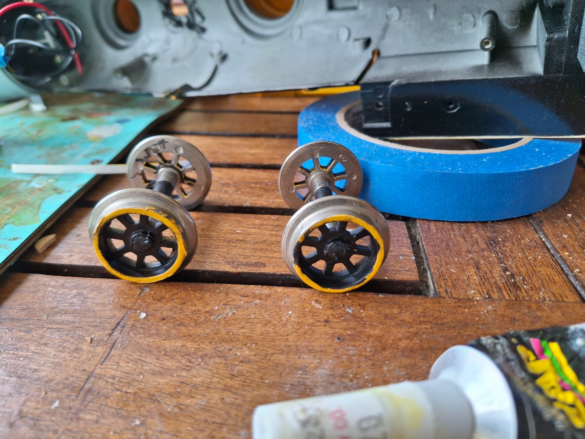

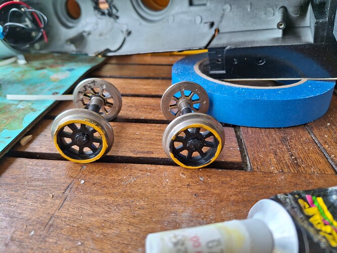

The pilot wheels got paint.
He plans to touch these up.
The drivers also got some paint…
…but it was a poor match. That has been fixed, I am told.

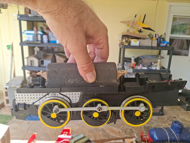

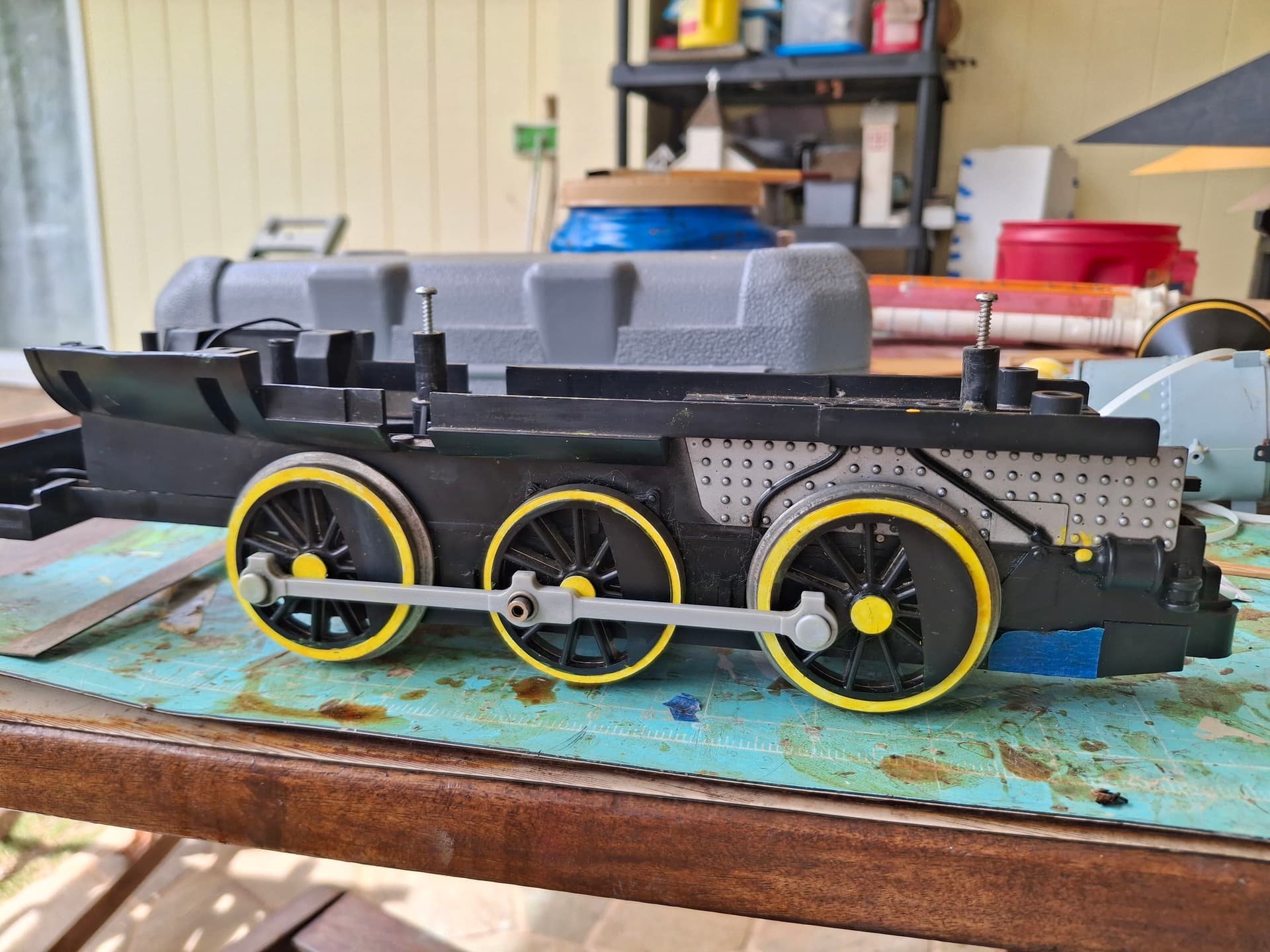

The convention behind us, it was time to get PCU-Bumblebee buttoned up and put to work. Kid-zilla had gotten frustrated with the weight, and the pilot truck is still beyond his skills. I finally had a purpose on this project!
The weight proved pretty simple. I trimmed those shelf holder things we got, found the right screw (thanks @David_Marconi_FOGCH !), and bolted all in place, remembering Pete’s (@PeterT) admonition not to overtighten the screws.
That’ll do!

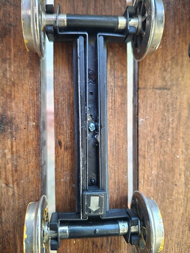

The pilot took some thinking. I figured I could cut and bend a bit of brass (measure 97 times, cut once, screw up anyway…I gave myself plenty of slop!), availing myself of a structural screw to serve as a pivot point…
…but holding it to the pilot had me buffaloed. The stock 10-wheeler draws power from the pilot, and the metal transfer buses carry power from the rails to the wires. The also hold the pilot wheels in place, so I figured I had to keep them even if I didn’t intend to run wires from the pilot truck. This meant I had to find screws small enough that they wouldn’t short across the buses. At first, I tried to epoxy…nope. It sheared off. Then I noticed a cavity where the original post had broken away. It was big enough to accept the screw and naturally recessed to prevent shorting!
I think it’ll do.

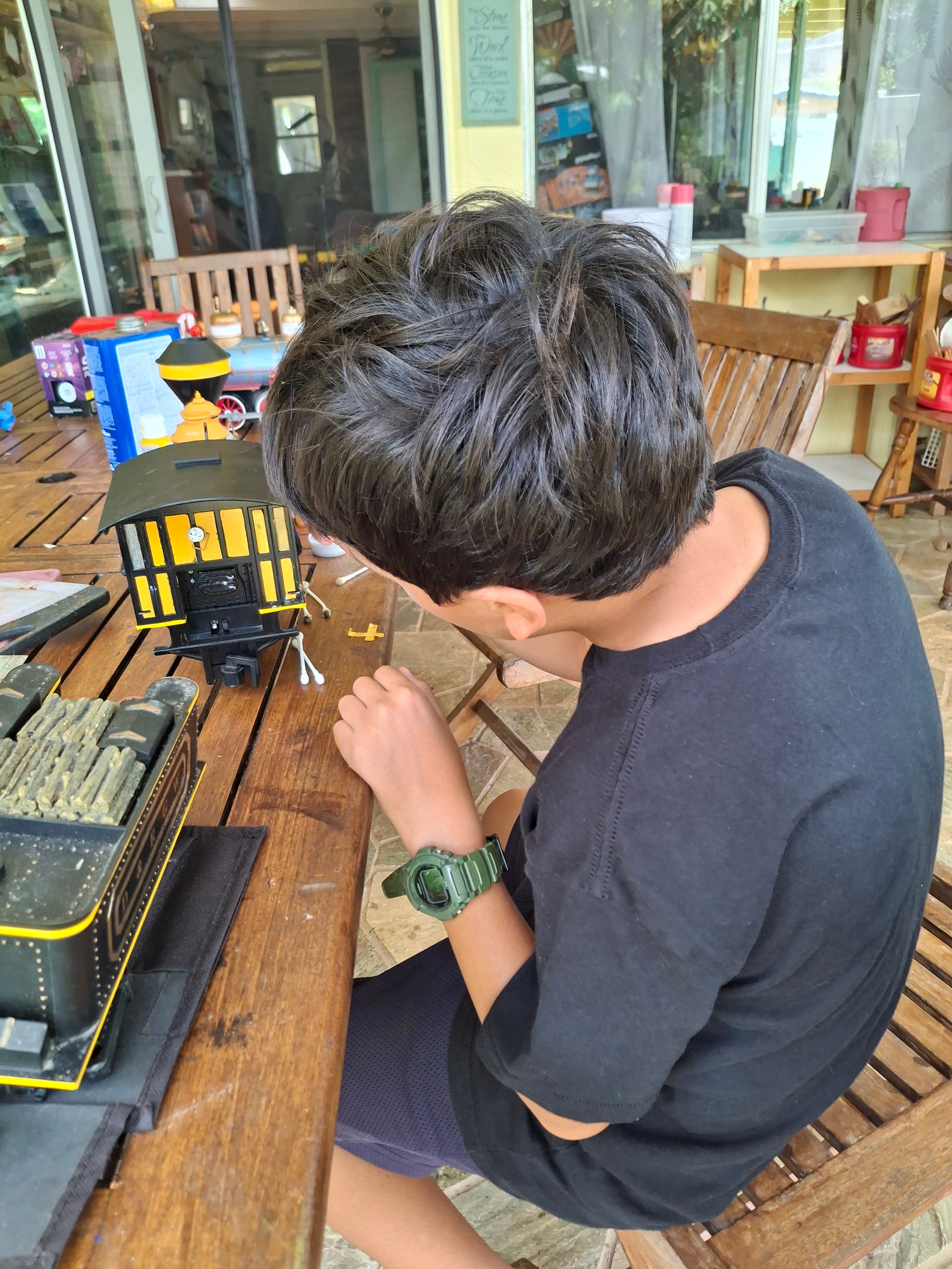

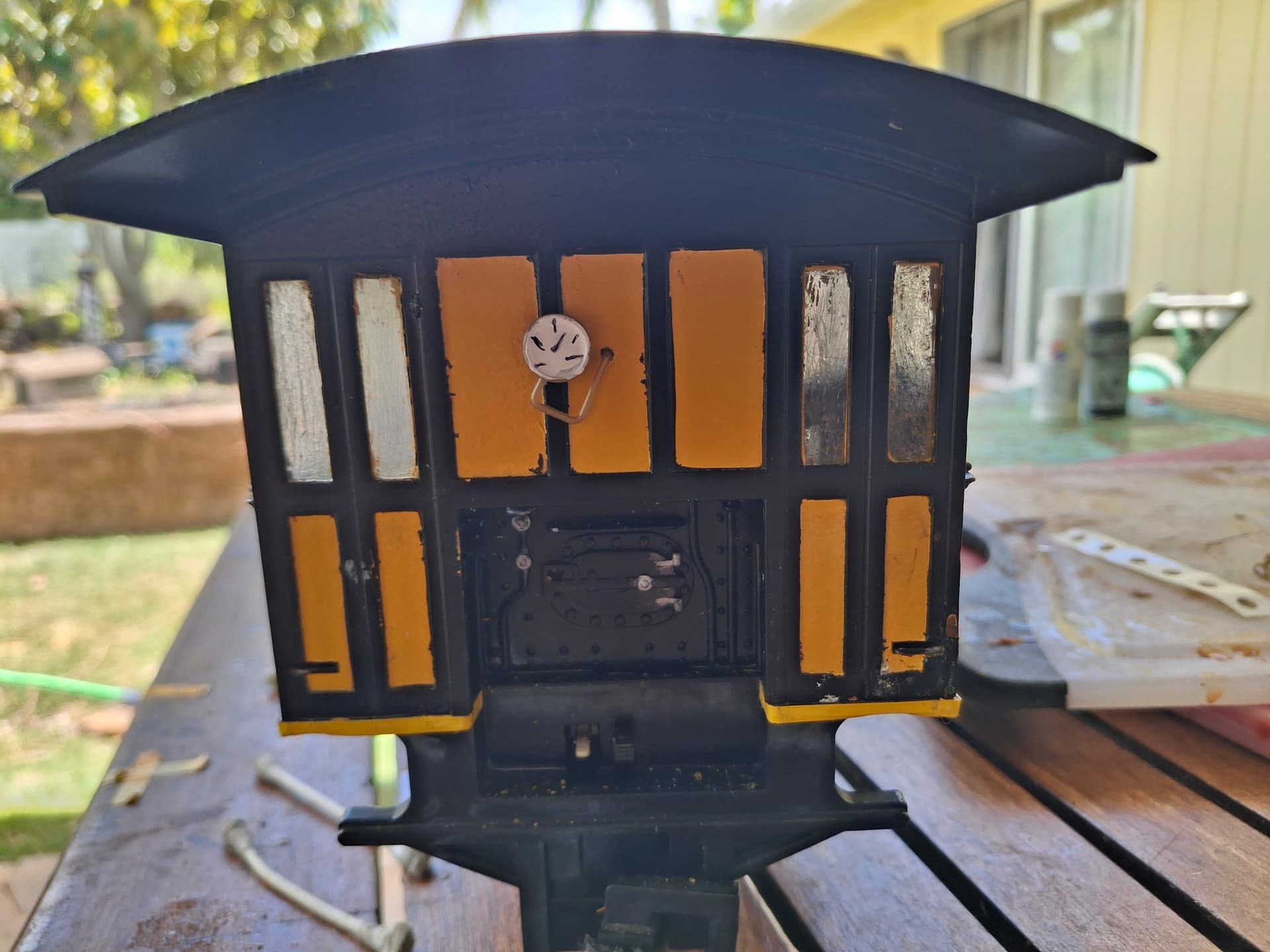

This activity had the desired effect of getting Kid-zilla to mask and paint the cab.
He also soldered in the smoke generator and headlamp.

First, though, he found that he had forgotten to remove some masking tape. Worse, he found he had forgotten to mask the inside of the windows! It was nothing some paint thinner, a toothbrush, and scraping couldn’t fix.
He opined that rediscovering the windows removed some of the Hallowe’en feel of PCU-Bumblebee. I agree.

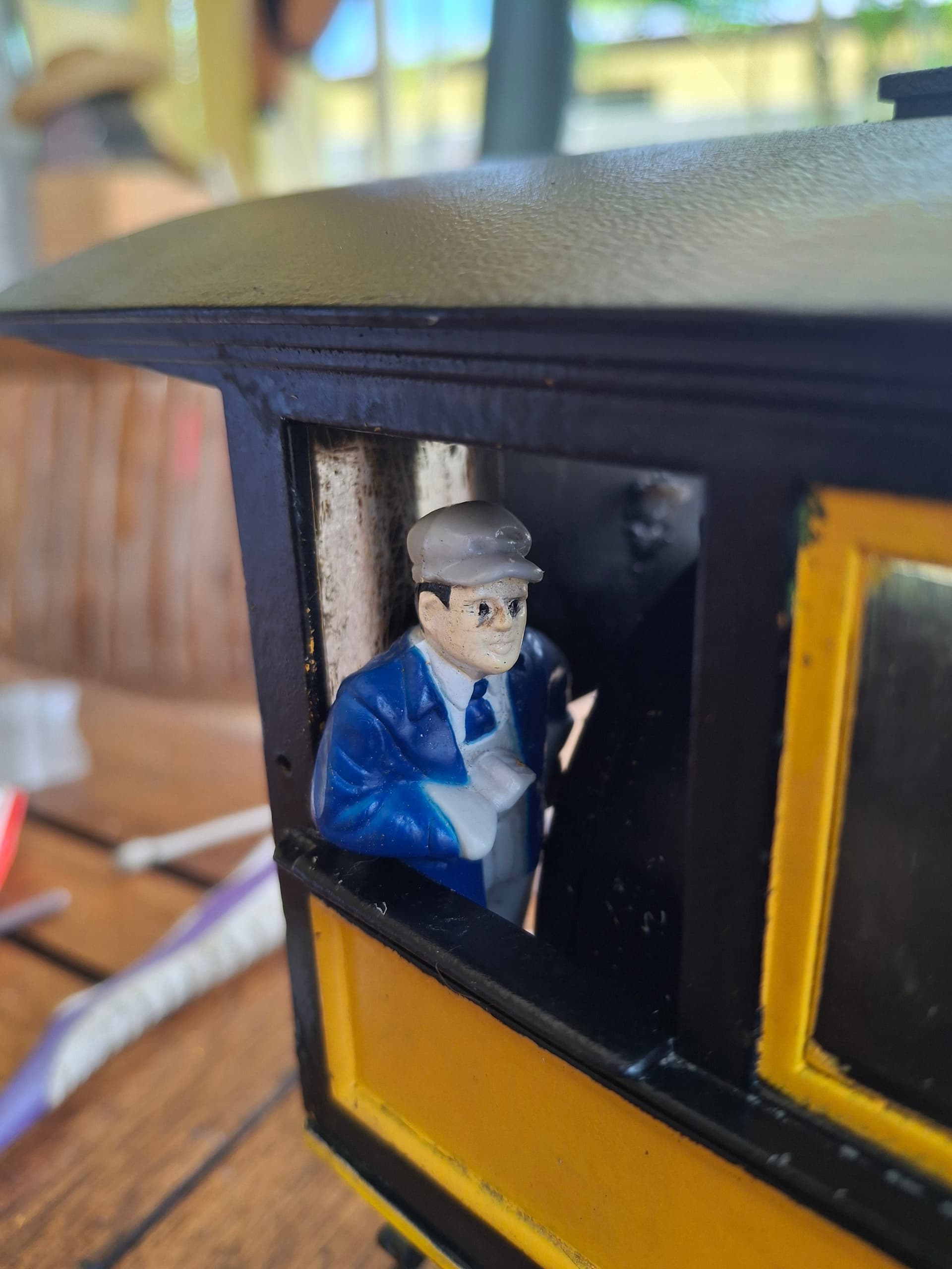

He also asked that I share a photo of the engineer, a refugee from a discount box at the convention. He added the facial features using a micro-brush and acrylics.
Let’s see if he touches up the fireman, too!

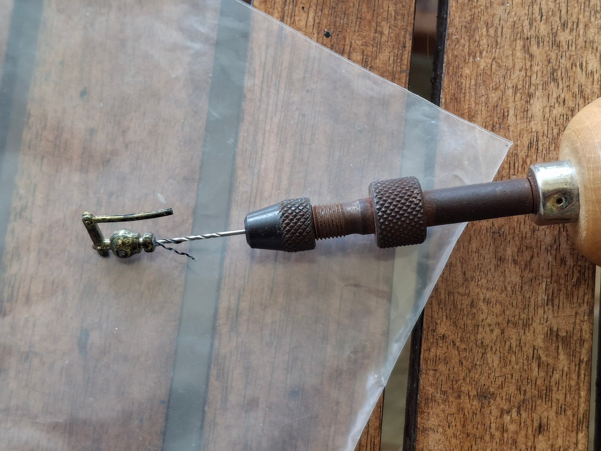

He found and removed the safety valves from a spare steam dome…
…while I helpfully lost the broken LGB STAINZ whistle I had prepared for him to mount alongside them.
Back to the bit box. I was more successful bending brass to replace handrails, which he cut to size. He also noted that the piston rod’s pivot point was cracked, so he swapped it out for a good one in our collect of bits.

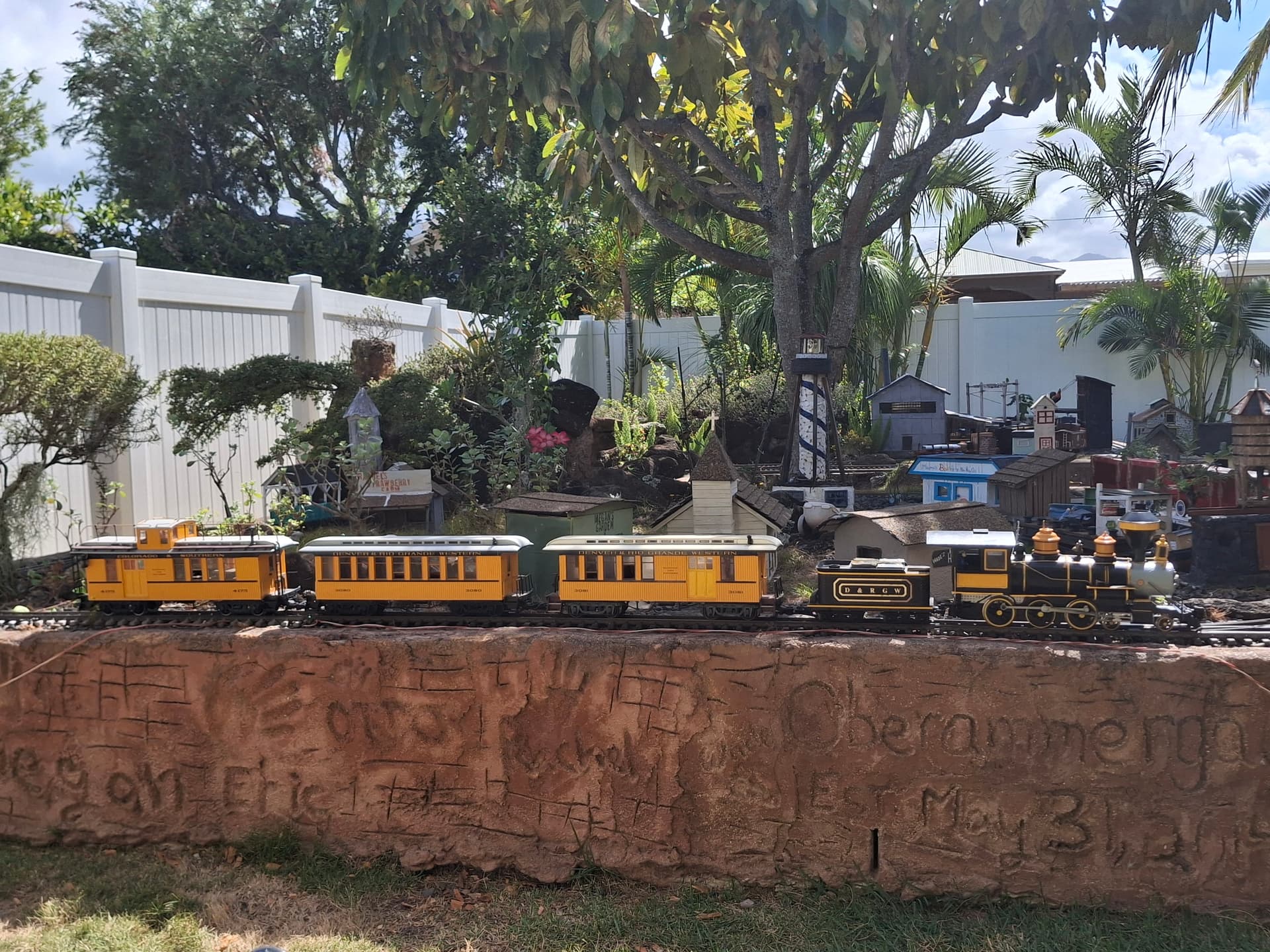

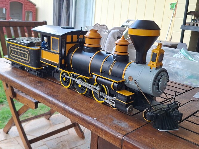

We did not have time to prep the numbers, so, instead, he chose a consist and took PCU-Bumblee to the track for acceptance trials.
It looks really, really sharp! And he was justifiably proud!
Alas, however, it’ll be back to the shops. The port-side forward driver will not stay on the axle. This would suggest either the interior of the drive hub or the axle itself are worn to the point friction will not suffice to hold it in place. Also, the old B’mann drive train, while happy enough rolling about with neither boiler nor cab, whined disagreeably under load. This usually signals a split gear.
We will look to our bit box for a better set of forward drivers. I also have an aftermarket drive gear on hand, but swapping those is not much fun. I also offered to look for a secondhand chassis in need of a custom boiler and cab.
