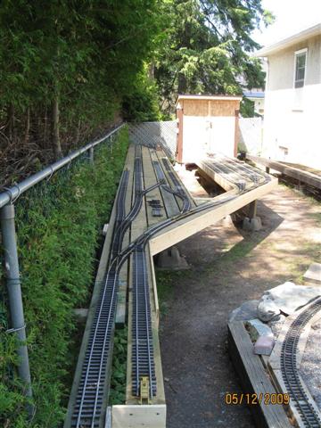

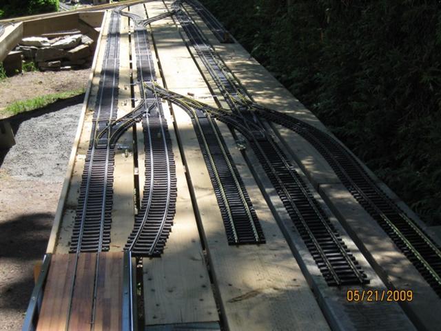

The last of the switches needed for the “Arrival/departure yard” should be here this coming week. It will take a few days to do the modifications to them, then we can finish up the track laying.

Looks good Fred. I'm curious about the switch layout. Was the design used to conserve space and keep the tracks closer together?

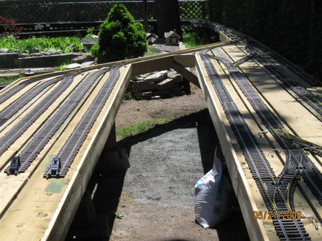

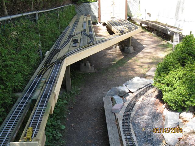

Last switches arrived…need one rebuilt for tomorrow…that will finish the track work at Firgrove. There is one more stub siding that we may put in later, if it is needed.
Pictures may be sent to Bruce tomorrow evening. We may drive the last spike on Saturday, to complete the Firgrove Project.
The trackwork at Firgrove is complete…sorry, no-one brought a camera…I’ll get pictures soon.

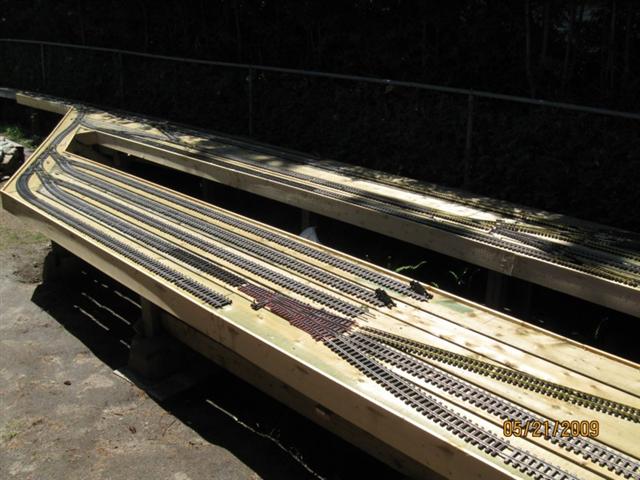

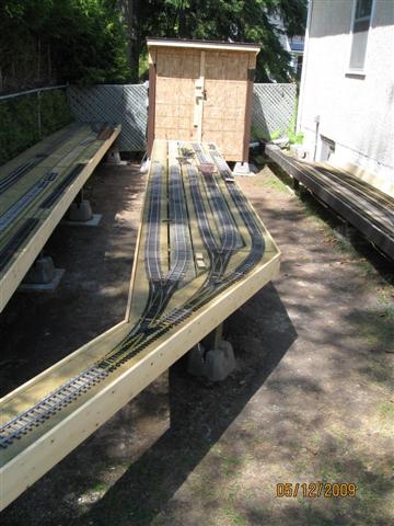

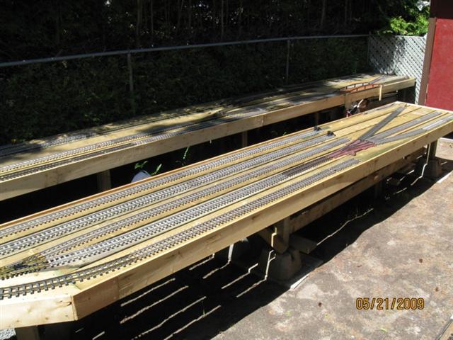

The latest pictures. Overview
(http://www.jbrr.com/Pics/IPPW/NewFirgroveOverview.jpg)
Firgrove Valley
(http://www.jbrr.com/Pics/IPPW/NewFirgroveValley.jpg)
Yard Area
(http://www.jbrr.com/Pics/IPPW/NFGYardArea.jpg)
Station Area
(http://www.jbrr.com/Pics/IPPW/NFGStationArea.jpg)

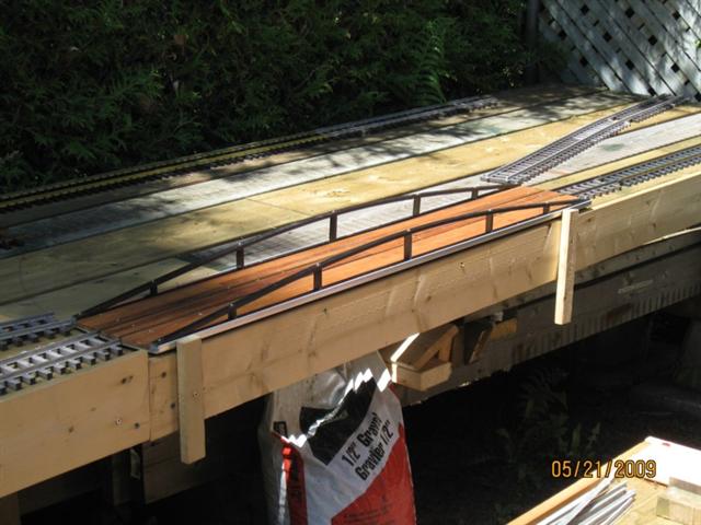

Turntable
(http://www.jbrr.com/Pics/IPPW/NGFTurntable.jpg)

Whew, I like that turntable and it’s stops.
Nice work, Fred. I’m interested in the turntable and how it is constructed. Do you have any under construction photos or advice for us. Thanks for all you have done for the hobby.

Mario;
Thanks for asking. We have three turntables, all designed about the same. They are based on a 6" "Lazy Susan" bearing, generally available at Home Despot or other builders' Supply houses. We use Aluminium plate, for the actual table, with the sides bent up to form a trough type structure.
The rail is attached to the aluminium plate with either rivets, or metal threading screws.
The idea is to make the platform of the table, the bearing and the rail top, equal in height from the wood roadbed, as average track…eg: LGB, Aristo, or USTrains, track railheight.
We do not build an actual pit, but instead try to “Simulate” a pit, as in one of the pictures on our web page.
The construction method does not lend itself to track power, as the metal rails on the Aluminium plate will cause a short. We are strictly R/C battery operators.

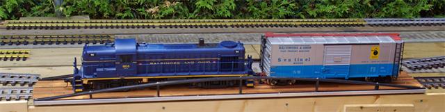

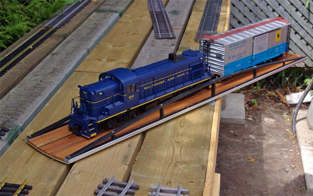

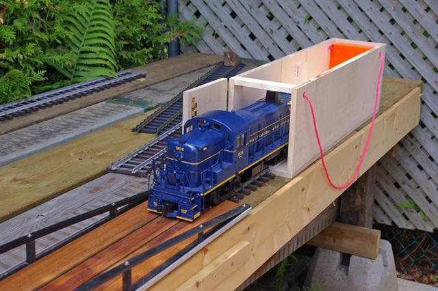

Fred sent some new pictures, as well as a note from Lawrence Watkins, the builder of the latest DGM Turntable on the IPP&W. "Attached are pictures I took today… Some talking points … The New Firgrove turn table was designed to turn engines with an attached power car. It was placed on the edge of the bench work so it takes up less space (30 inch semi-circle compared to a 48 diameter circle). The heavy end (usually the engine) is always moved over the bench work not the aisle so the table will not buckle.
(http://www.jbrr.com/Pics/IPPW/TurnTableSideView.jpg)
(http://www.jbrr.com/Pics/IPPW/TurnTableSwing.jpg)
The north end of the turn table has a stand-by track, an engine house track and a carry box track used to load/unload the trains from carrying boxes. The south end has two exit tracks to New Firgrove station and yard.
(http://www.jbrr.com/Pics/IPPW/TurnTableandCarryingBox.jpg)
(http://www.jbrr.com/Pics/IPPW/FreightHouse.jpg)

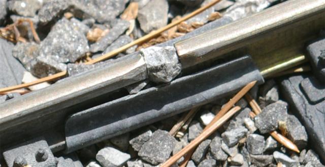

The turntable is 48 inches long 8 inches wide. The base is 1/8 inch aluminium plate with the sides bent up 1/2 inch to give longatutional strength. The floor is ceder strips cut to the height of the rail and trimmed underneath to fit flush against the rail and cover the screws holding the brass rail. The arch is made from fiberglass strips used to hold the ends of a change link fence. It provides no structural strength just a decorative element and a catcher if the trains are jolted off the rails when moving the turn table. The swivel is an ordinary lazy Suzanne. Rock and Rail? This is what happens when the heavy rain, gravel a hot day and cool nights, and a rail gap (for heat expansion) that is too large. The stone had to be pried out
Mother Nature worked so hard to get that rock in just the right place and then you guys have to come along and try to improve the installation.
Fred,
Thanks for the info, additional photos, and the description of the DGMT. What thickness plate do you use and what is the preferred bending method you employ? Thanks again.
