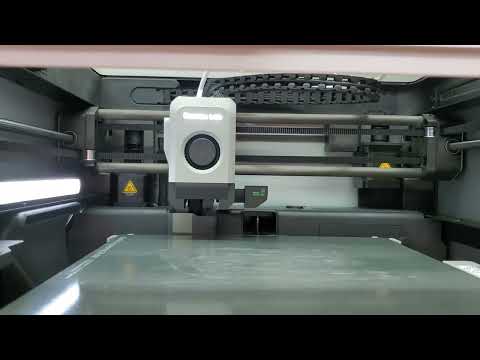

You really should see the Bambu do its bed leveling routine. When the guy says, “Why is it doing that?” it is totally normal. It is making “micro-adjustments” across the bed. And when he says, It’s not extruding", it’s not supposed to…, it’s “examining” at the area where the print will occur. It will also go back and examine the first layer after extrusion for flaws or differences from the program. Everything it is doing is totally normal.

Couple things without seeing the whole video…
Regarding the cone and temp to produce a shiny finish, the Bambu software lets you change temp/speed with height so you can make the whole thing shiny.
My Bambu runs at 53-55C for ASA from the bed and extruder head without the heater. And there is no wait for the print to begin. The temp comes up rapidly, but it is not one of the requisite parameters. The bed and extruder go though several heating/cooling cycles during the leveling/calibration process and this warms the chamber.

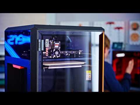

Regarding 3d printing of ties, I’ll admit that I’ve been coming from the perspective of having had pretty bad luck with FDM, especially in printing multiple separate parts like ties in a batch. There was always some part of my printer bed that wasn’t happy; so when one piece fails, it gets dragged around and taking out the others.
But after watching these and other videos on the newer “core” machines with enclosures, higher temps and a bed that stays put, I can really see it working now.
