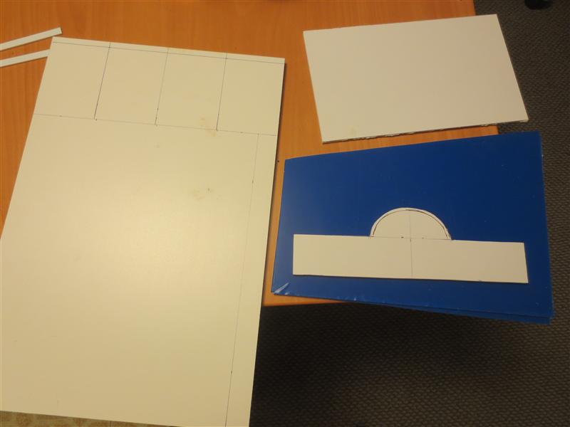

I looked through my scrap box and found enough pieces to make it. I cut two walls out of 1/8" acrylic. A base, back wall and storefront sign out of some foamed PVC.

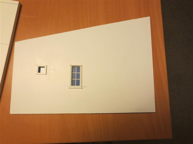

Well, first oops. I love working with acrylic, but I just wasn’t thinking ahead. I want a few windows on one side, and it would be much better to use a hunk of PVC to make that wall. It’s much easier to set the windows back in a 1/4" thick wall…
OK, the windows aren’t even close, but they are ones I had ready to go - a big plus!

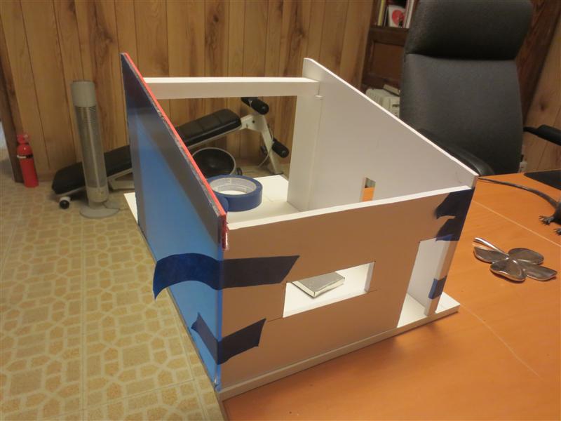

I also found a window for the back wall. Have to make a door, but that’s about the easiest thing to scratch build. Openings cut for both and I’ve taped the walls together to get an ideal of how it will look.

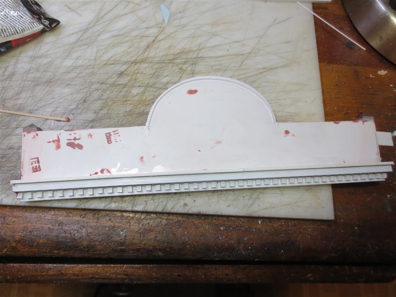

And I’ve started building up the storefront sign. The clamps left too strong of an impression, so I’ve filled the holes with Bondo glazing compound. Much cheaper than the hobby stuff, and doesn’t dry out in the tube nearly as fast!
Dental work done in styrene…
A fairly simple building, but the front is going to take a lot of work to get right.
