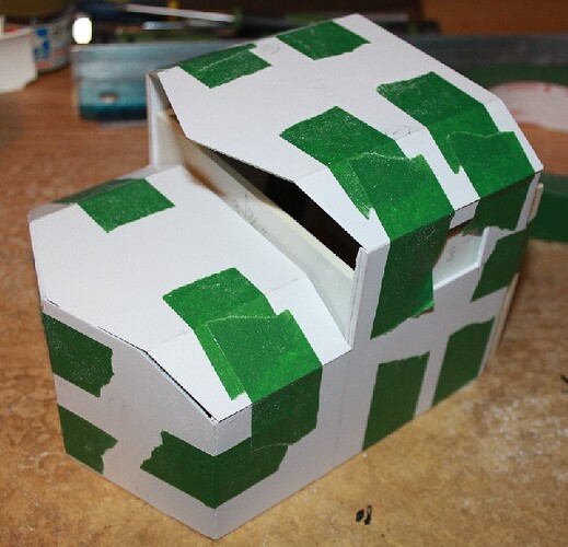

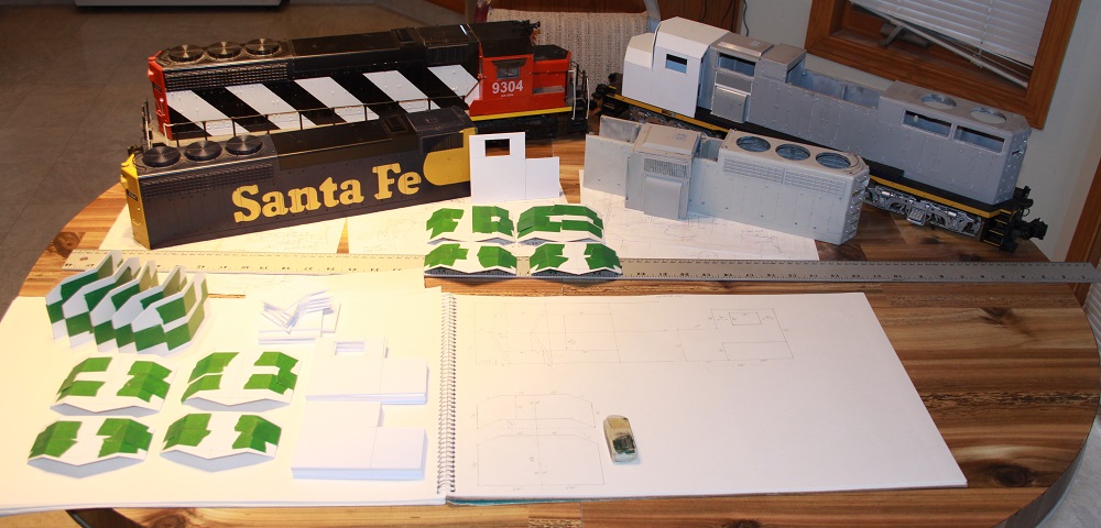

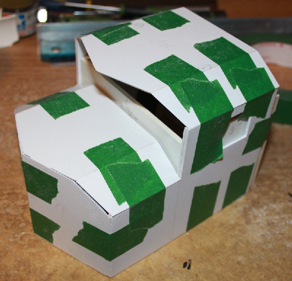

The weather is starting to turn cold, so it’s time for winter projects. My main focus this winter is going to be a GP38-2w and 3 GP40-2w’s.
I’ve been designing the cab the last few weeks, and after the initial one looks like it will work, I’ve started to work on the rest.

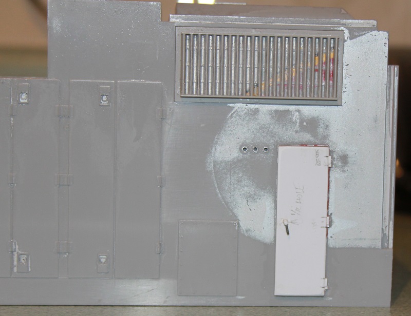

I’ve also got started on modifying the GP38 long hood,
Shane

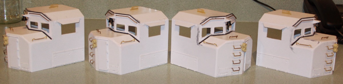

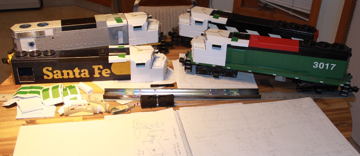

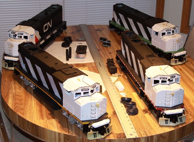

I’ve been making some progress on the cabs, and the GP38 long hood.
Nice modeling skills, I’m with you, keep up the good work. I realize many just run trains, but those with modeling skills bring another dimension to the hobby. I have no problem taking a perfectly good engine, car, etc. and making it something much more detailed to my liking.

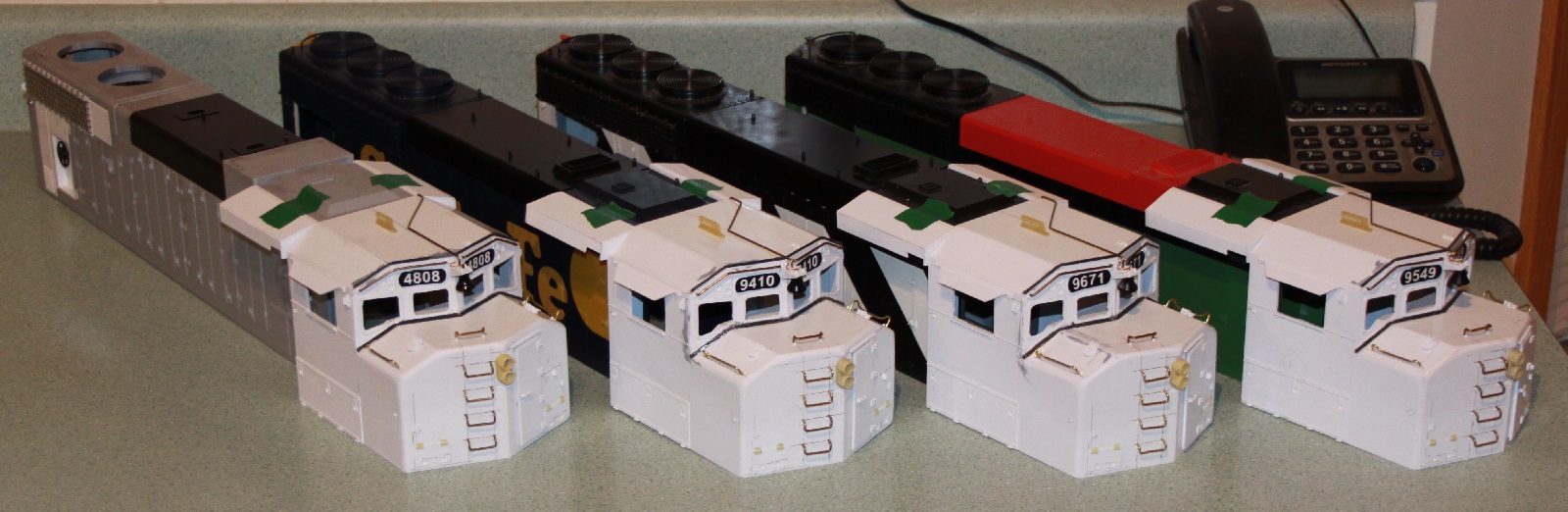

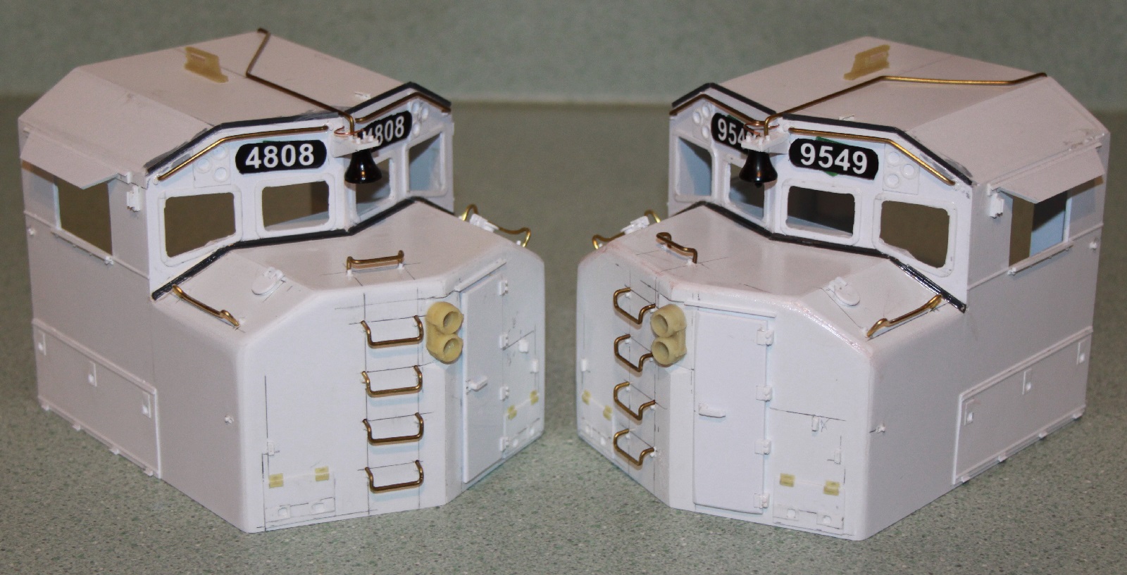

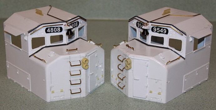

I’m making good progress. Cabs just need rear doors and steps, and then can be painted.
The long hoods need some warmer weather so I can strip the old paint.

We’ve had some incredibly mild weather the last two days that allowed me to get some painting done. :smiley:

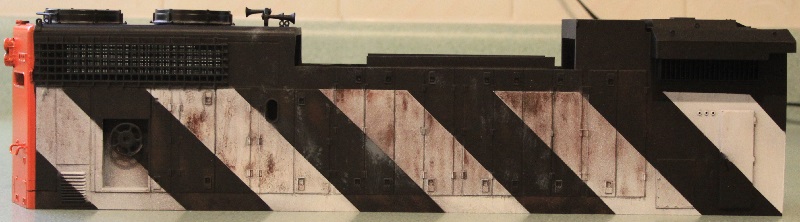

One more teaser. I’ve started working on the weathering on the GP38-2w hood. The GP40-2w’s will actually be in worse shape, so I’ll have lots of work to keep me busy as the weather turns cold again. :slight_smile:
Shane
Nice! When I was in CT, the local short line ran GP-38-2’s with the original cab style. These "W"ide cab versions look so much more modern! Looking forward to seeing them on the rails.
