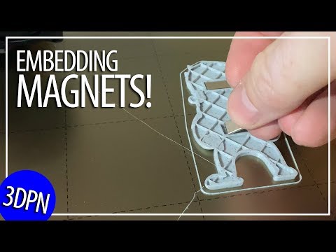

With FFF printing it is possible to print some negative space and hide a magnet in the print. Can that be done with resin?
In any event Bob, are you considering placing a rare earth magnet on your electromagnet? It might allow you to precariously attach bits to dangle without glue…
Neat idea Bill, plant a magnet in a cavity, and let it do its thing on some junk.
Maybe an easy way to print the cavity might be to print a lower ring (surrounding the magnet) separately, then print the superstructure and glue it onto the ring.
Cliff,
I went on a Print-a-Palouza when I found I could program a “hole” in tinkercad then pause a print to drop a magnet in side and seal it up.
The bolt template was one of my first attempts as I was testing how many layers would hide the magnet. This was one layer thick.
I’ve not seen that, very cool!
FYI
