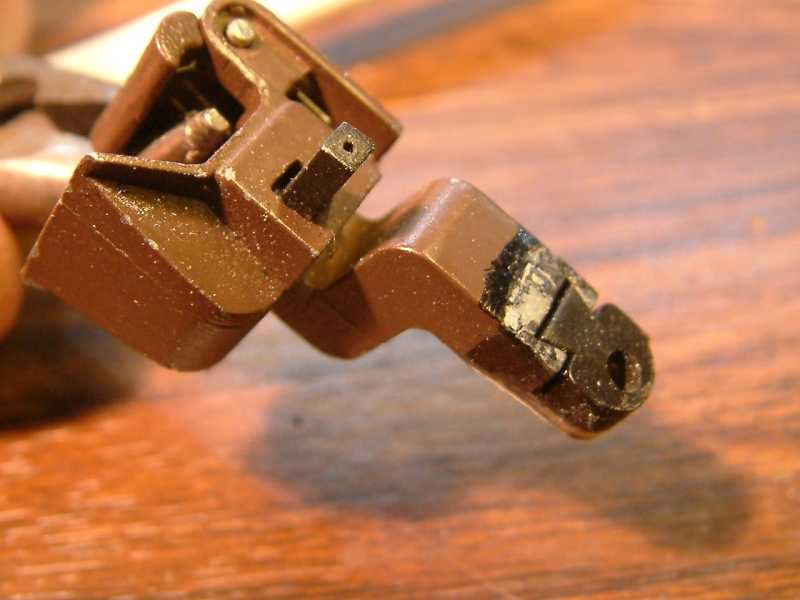

Here’s a conversion I made for a Porter I kitbashed. I used an Ozark Miniatures L&P socket and a Kadee knuckle that I slightly drilled out and inserted a piece of styrene tubing. The pin is from the Ozark kit.
Here is what it looks like installed. Sorry I don’t have a photo of the link installed.
Hope this helps.

Similar to how the KaDee couplers are mounted on the Bachmann Shay. Now why didn’t I think of that?
