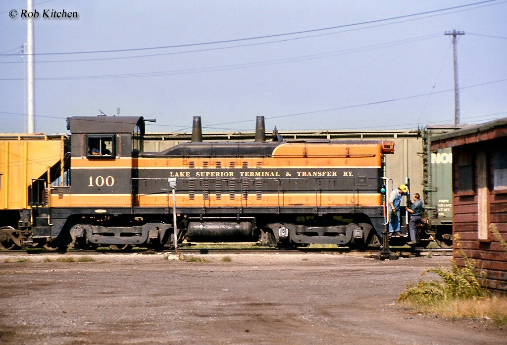

Looking at pictures of real prototype locos I am trying to figure out the differences between the two from a modeling perspective. US Trains makes the NW-2 and the St Maries River RR uses a SW1200. I would love to model the STMA switcher
SW1200
NW-2
So what are the obvious differences between these two locos. Seems like they are dang near the same locos. I can see behind the back stack the slopes are different.
different rear light housing 8 rows of vents on the 1200 piping next to tank, handrail down the side of the NW2 (http://www.largescalecentral.com/externals/tinymce/plugins/emoticons/img/smiley-cool.gif)

If only I had either to trade(http://www.largescalecentral.com/externals/tinymce/plugins/emoticons/img/smiley-cool.gif). looking at the SSB I am seeing that all of these EMD switchers are very similar. Things like hand rails and lights would be easy to deal with. I could and off the excess louvers, not sure how to add them but I wouldn’t need to be that picky. I think I could fake it.
I might have to pick me up a USA switcher. I just looked at this site http://www.thedieselshop.us/DataEMDIndexYD.HTML which has data on all the EMD switchers. And the NW2 and the SW 1200 have the same dimensions or very nearly so. The only glaring issue is the back of the hood but that would be a cinch to fix.
Anyone have tips for making louvers?
So I found some line drawings showing both locos.
The bottom is the USA nw-2 It doesn’t have the louvers at all so no issue there. Really the only thing I can see that would be a big difference it the larger windows and the smaller radiator grill. The radiator grill would be easy enough cut a larger hole and get some mesh for a grill screen. The windows would be a bit tricky to make smaller. But I think it would be a real doable modification. Oh and the hood transition. but some styrene and its easy

It’s not just the louvers that are different on the long hood. All the door arrangements are different. Look closely and you can see the location of different pairs of doors and the door hinges.
If I was to do a conversion, I would completely strip the detail of the long hood. Then using the shapeway products that Burl has designed completely redo the doors. He has designed both the door latches and door hinges. The next step would be to replace all of the missing louvers. Making louvers is quite easy with 1/4 round styrene stock… Or I believe that Archer decals makes a set of raised louvers like the rivet and weld decals (I’m about to order a sample set of each for the Snow Dozer build).
At that point finish the rest of the modifications as you have mentioned.
