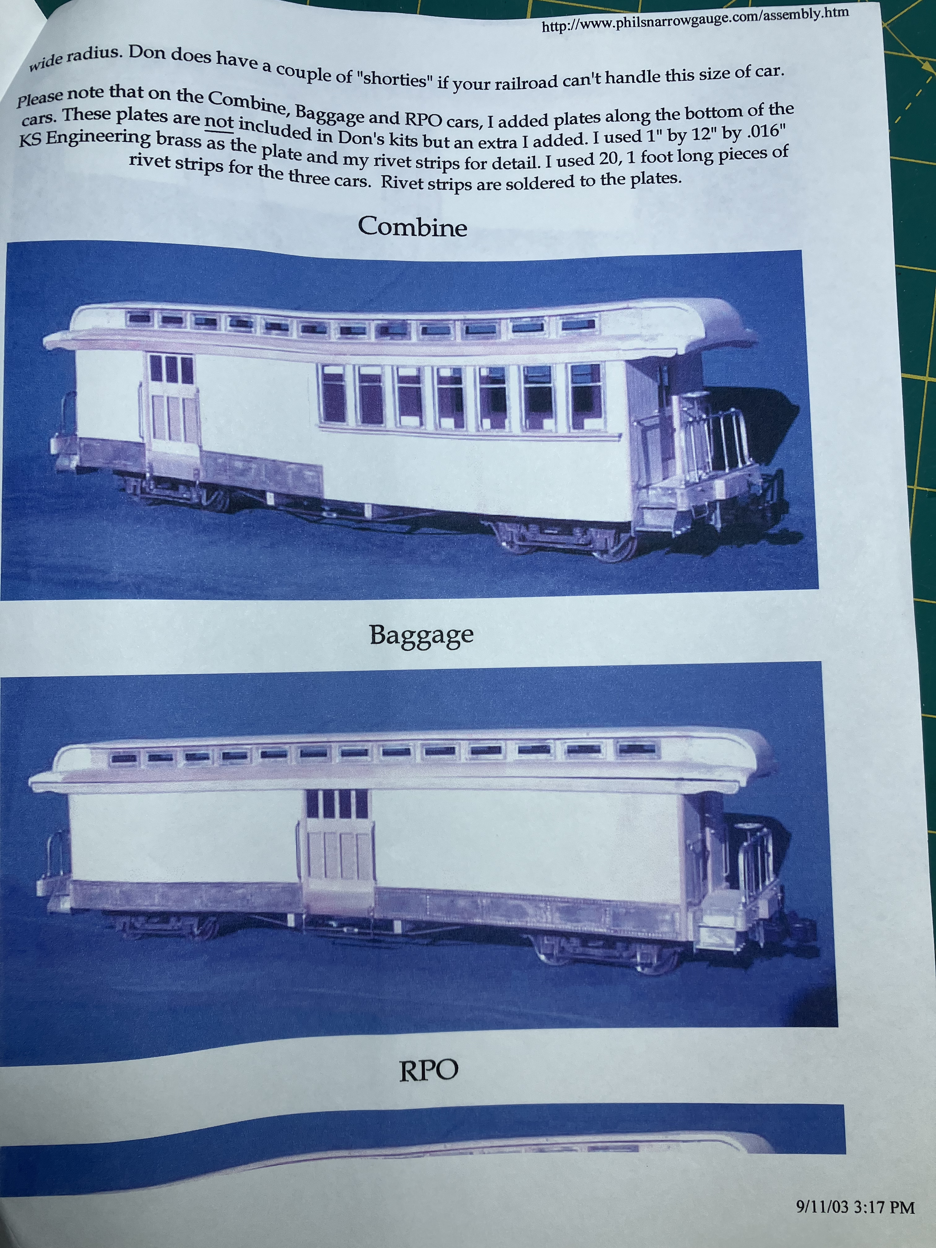

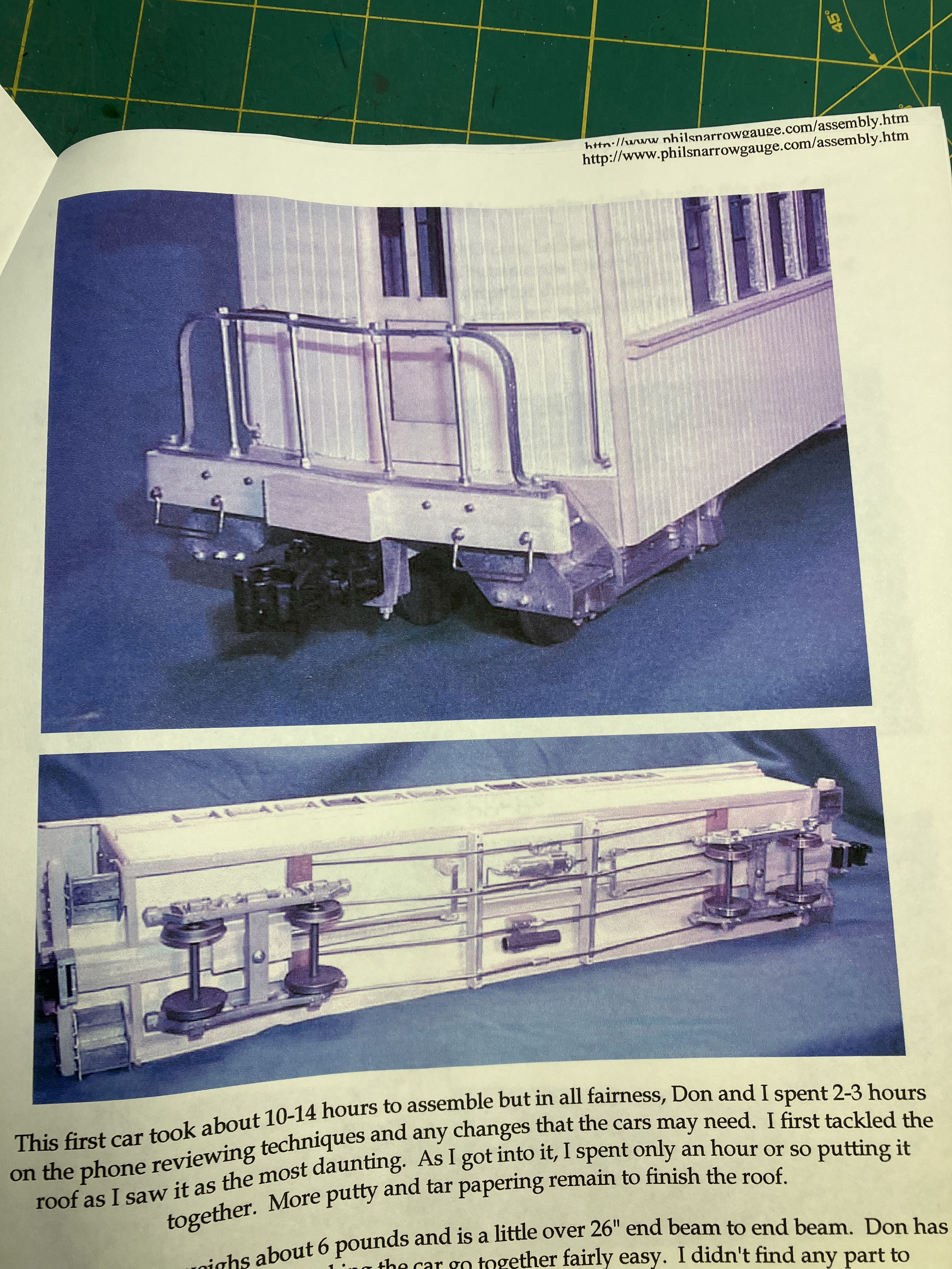

Here are pictures of the cars that Phil produced based on the Don Winter originals. These are from Phil’s assembly instructions.
I also have pictures/instructions from Don’s Drover Caboose if you need them.
The cars aren’t really warped it is just the paper pages

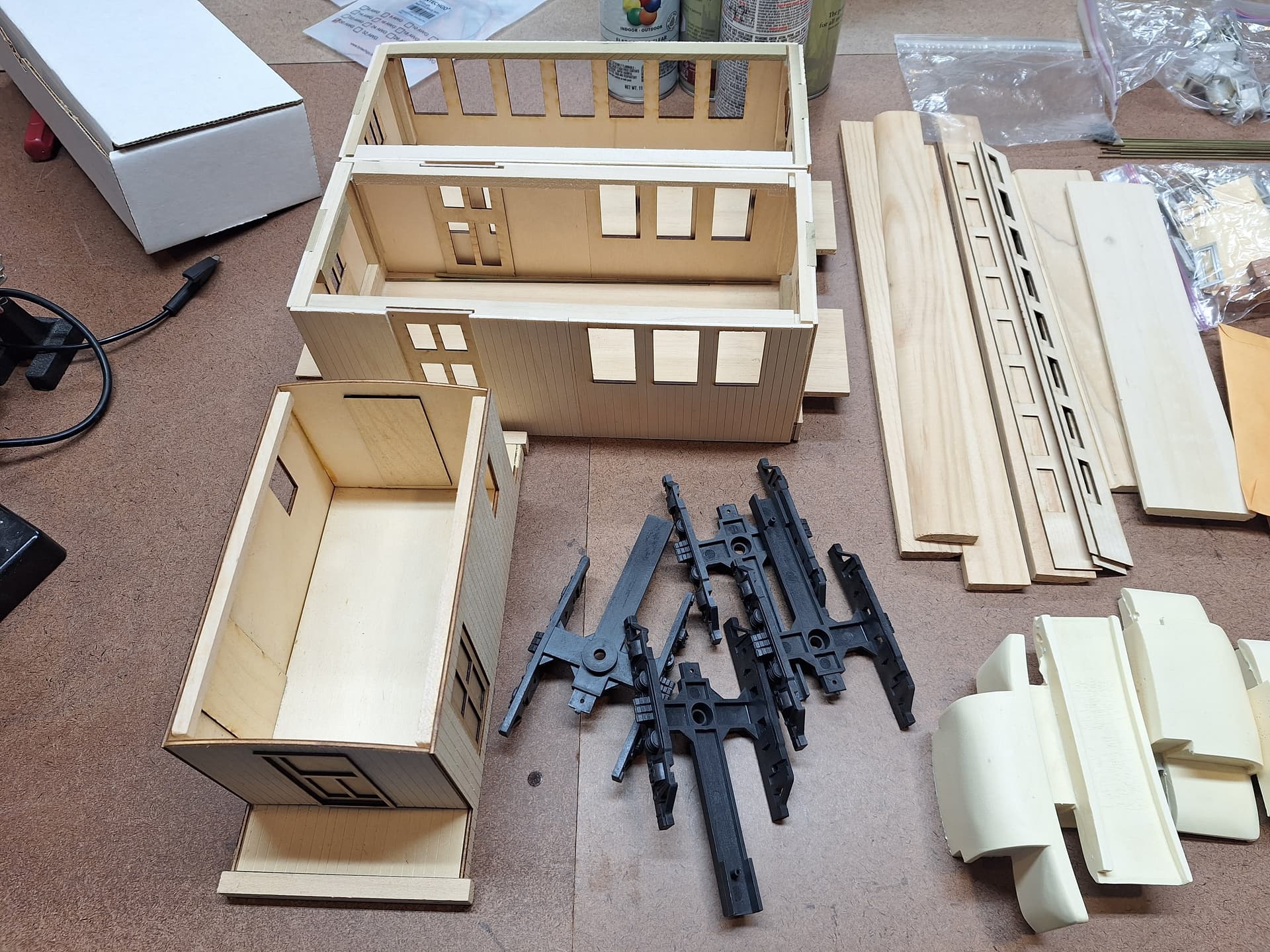

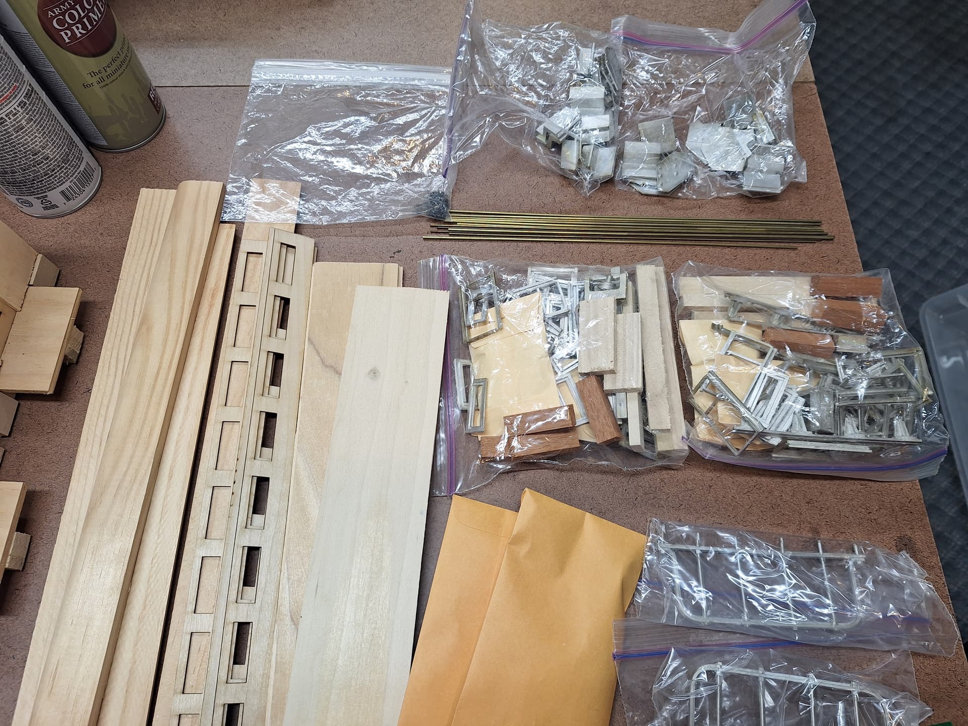

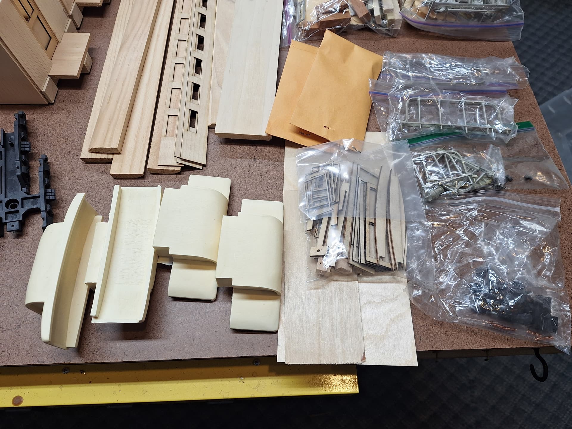

Pete, does this stuff look familiar? The bodies are 11.5" to outside of end walls. Resin roof ends, cast white metal window frames, steps, railings. The roof wood is too long, but might be able to cut it down.
These were from a big lot of kits a widow was selling at ECSLTS a couple years ago. Unfortunately the parts were mixed up amongst numerous bins and boxes, and people had been buying individual parts from her before I aquired these. Hence the mix.

Looks like you’re right about about the coaches being NENG Pete,

Thanks for those. The castings & roof parts shown are the same that I have. Must be it.
Cliff
For my kits, either Don W. maybe a “shorty” version, or the modeler who started these cut the bodies down and didn’t proceed further. Since the roof boards are long, I’ll guess the latter.
