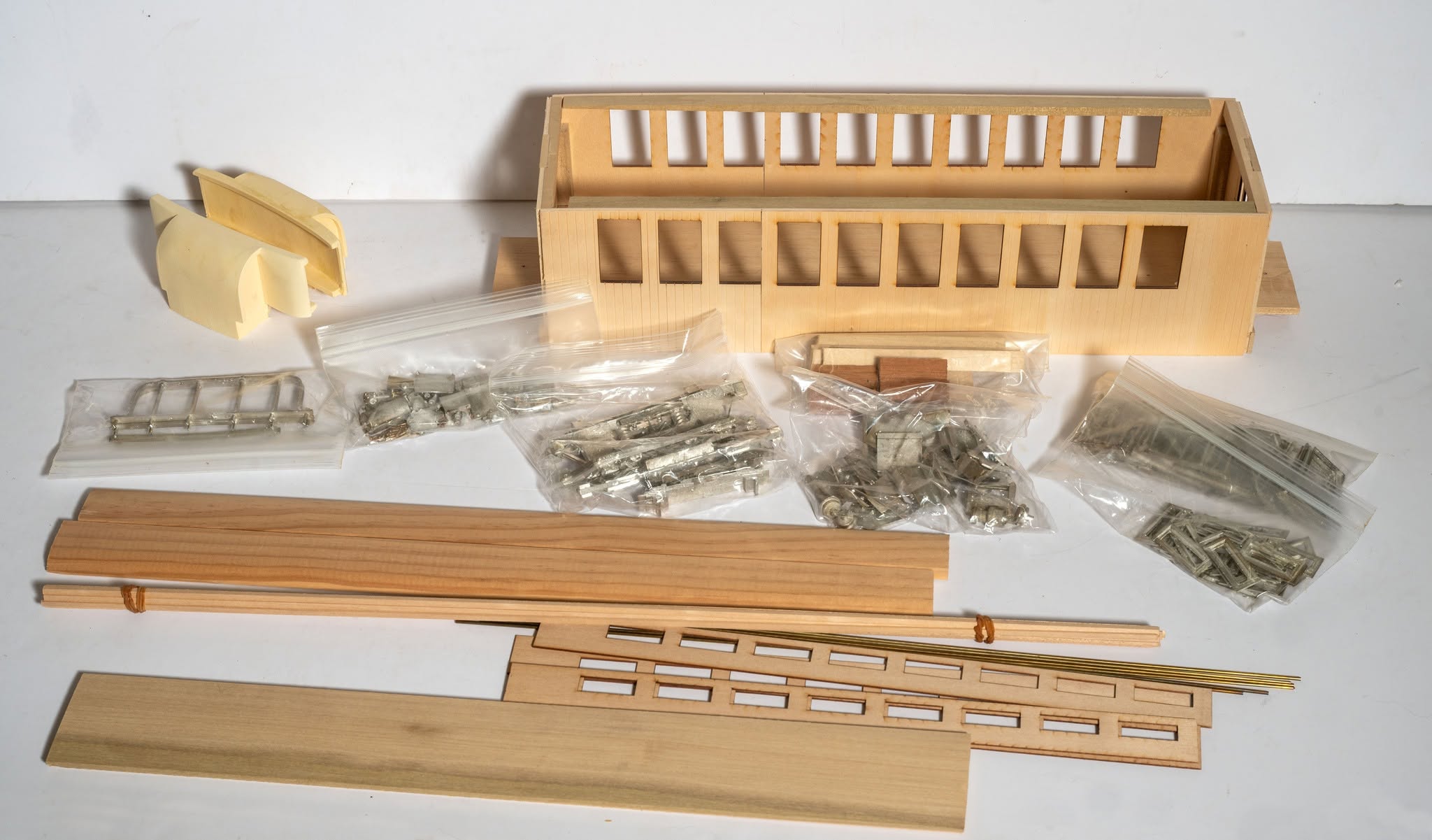

I just acquired what I think is a Don Winter passenger car kit. I saw your post and was wondering if these kits came with instructions? If so, is there a source to get a copy?
-Brad
Brad,
Welcome aboard!
I don’t have those, but I’ll suggest an email to Don Niday at Iron Creek Shops. He might have some clues, if not the actual files.
Actually, I’m in the same boat. A few years back I bought a plastic tub full of car kit parts, two of which I think are these Don Winter Passenger Car kits. Also one or two Drover’s Cabeese. But no instructions, and no way to tell if all the parts are there. No OB’s either, just a bunch of mixed up parts.
If someone can find instructions, I’d be glad to have them. As well as Brad.
