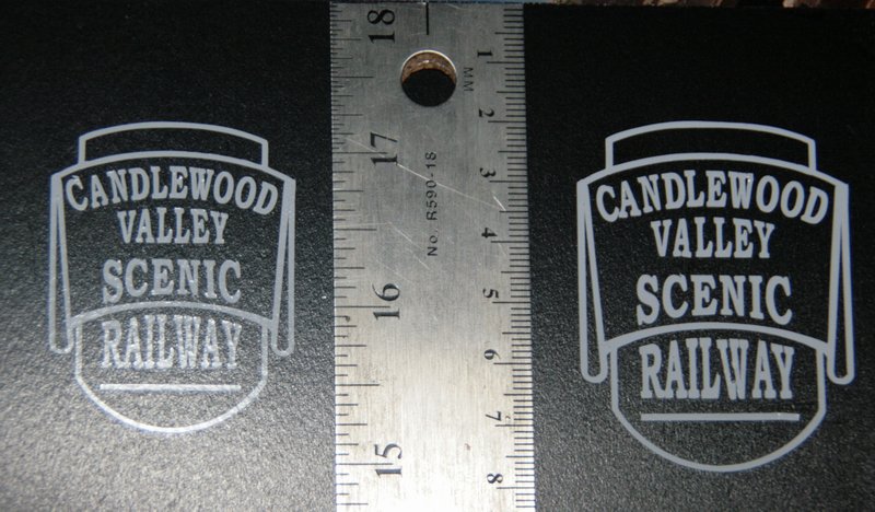

After our art director taught me a couple of more tricks to make my design “cutable”, he ran one each of the 2.25" x 1.75" and the smaller 2" x 1.5" version then turned me loose to try and weed the scrap vinyl out. I was able to do the larger one with out any vision aid other than my regular glasses, but the small one required the use of my 10X OptiVisor and a hypodermic needle as a pick. There were a few issues of lifting the “good” vinyl off the backing, but with a few adjustments I was able to get them both weeded. Very time consuming, but it works.

(http://www.cvsry.com/sig/CVSRy_Herald_test.jpg)
I’m a real novice at this and I made a few mistakes weeding out the scrap. Many will notice these problems, the worst being the W in Railway on the right one. This was a feasibility test and training mission, so with that in mind I think this was 100% successful. The left herald is just over 50mm tall, or about 40 inches in F. The right one is almost 60mm, or about 48 inches in F. I’m going to use the larger version in production because it’s much easier to weed. I’ve already created a master cut sheet with numbers and data for a few box cars and a few locos. Now I’m just waiting for some down time on the cutter. This has been a lot of work but still fun and very educational.
