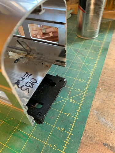

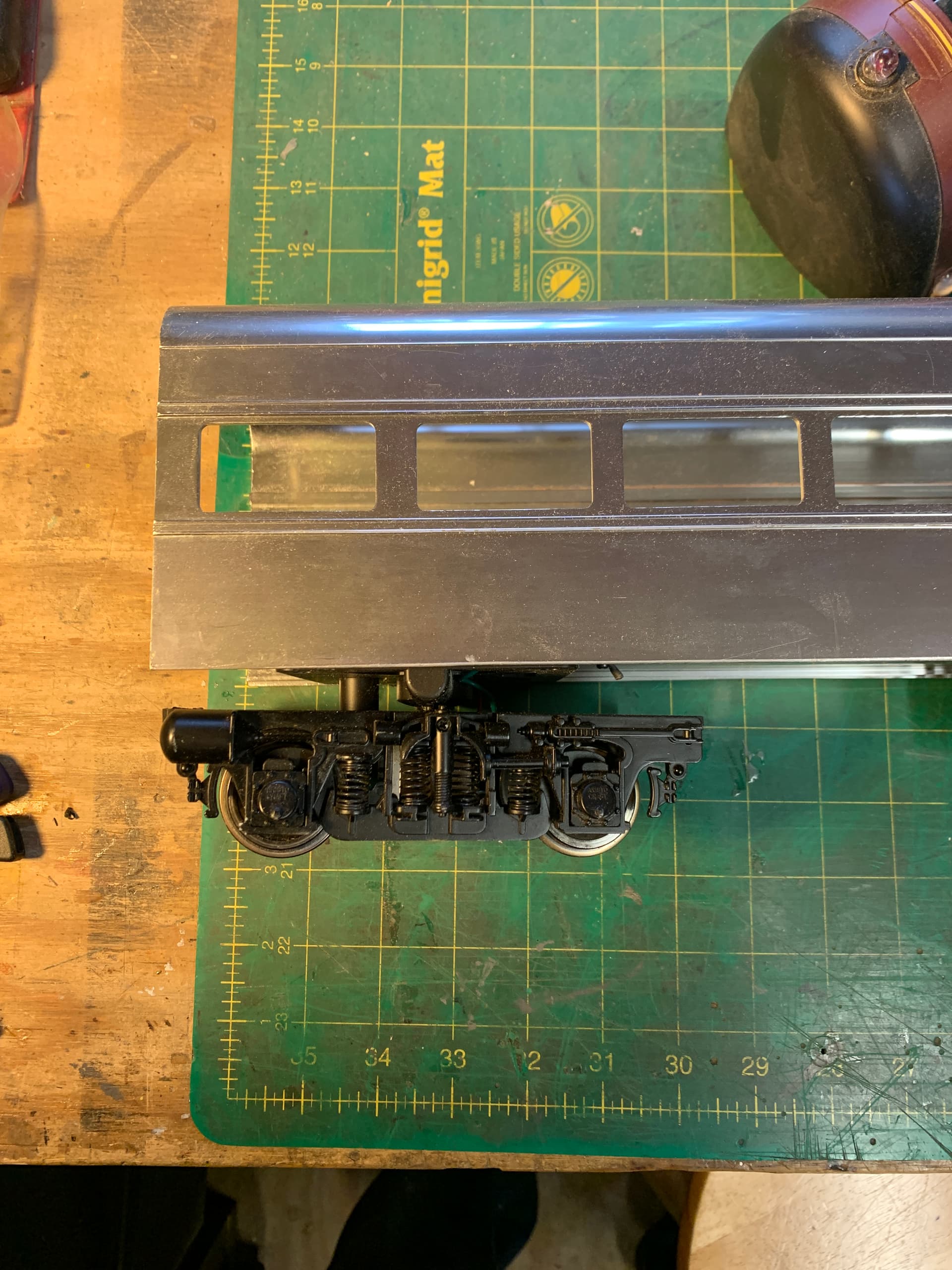

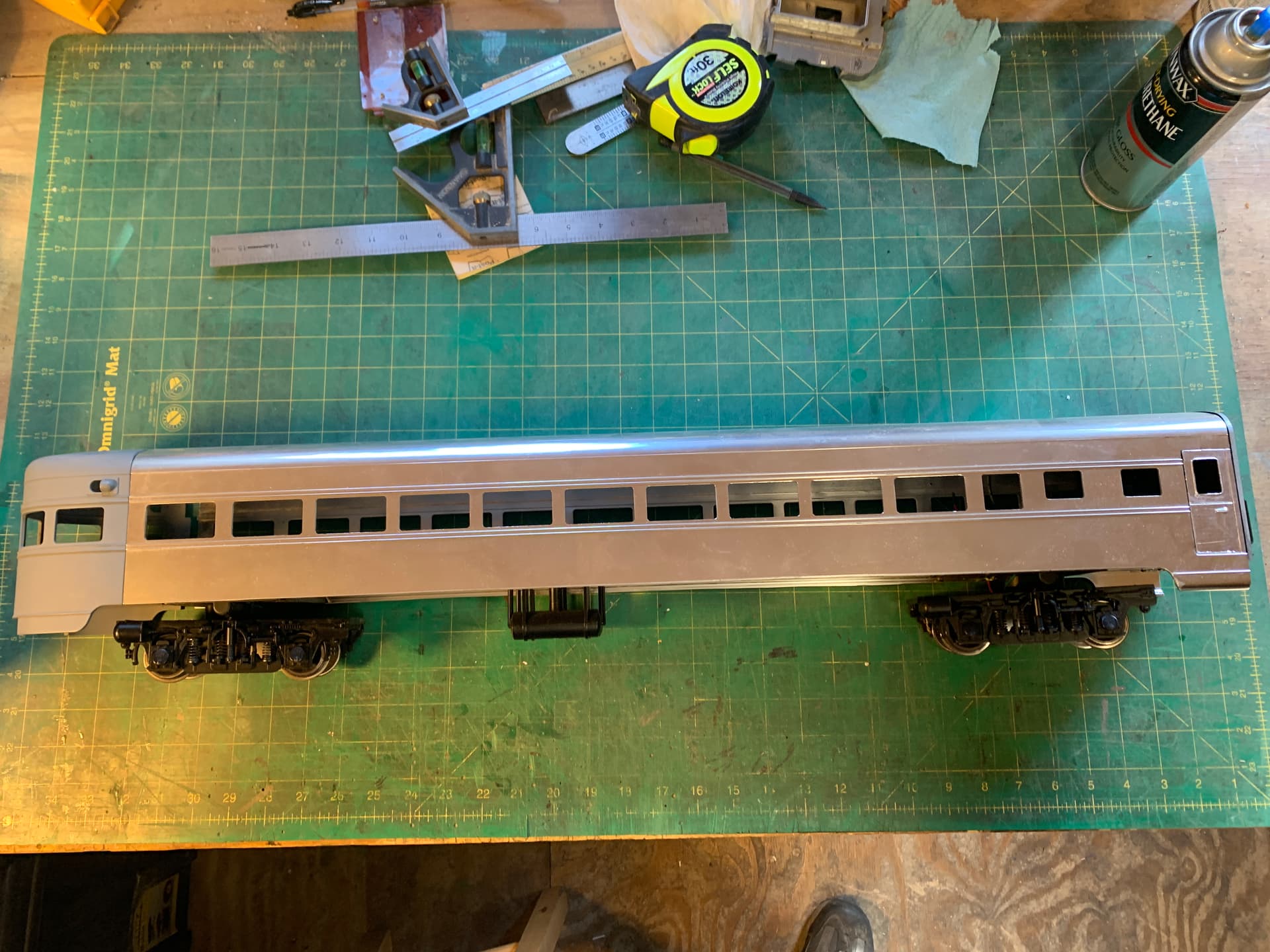

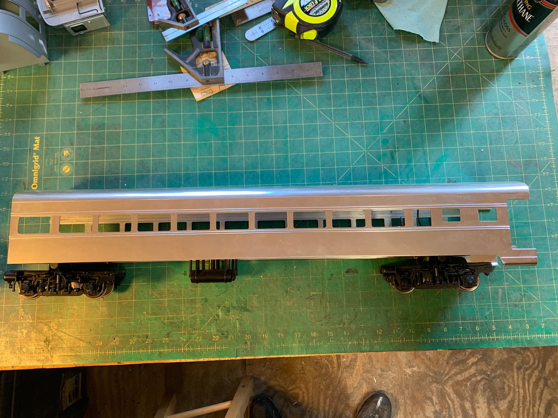

So with that said the next up is an Aristo Smooth side observation car. I played around with this car back in the day when someone asked me to build them a model of Conrail #9 Theater Car.
I got disgusted with the results, scrapped the idea and just built Conrail #9 OCS from scratch. I later tore the Aristo OBS car apart and stripped down the paint. Played around with it here and there but never got inspired.
So lets fast forward about 10yrs. I recently acquired another Aristo smoothside ( Santa Fe livery) observation car so I needed to do something with the original one that was shelved.
So here we go…

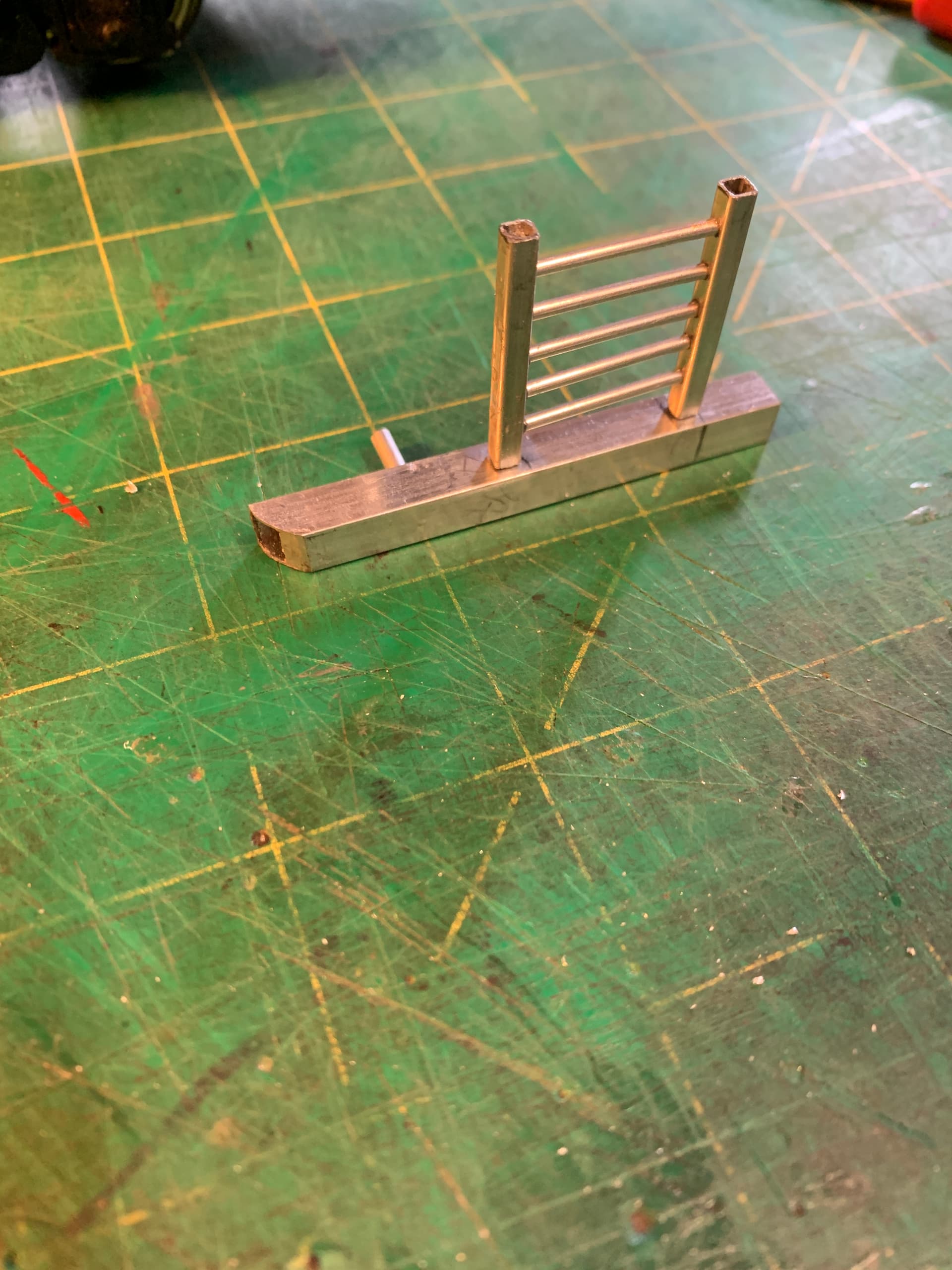

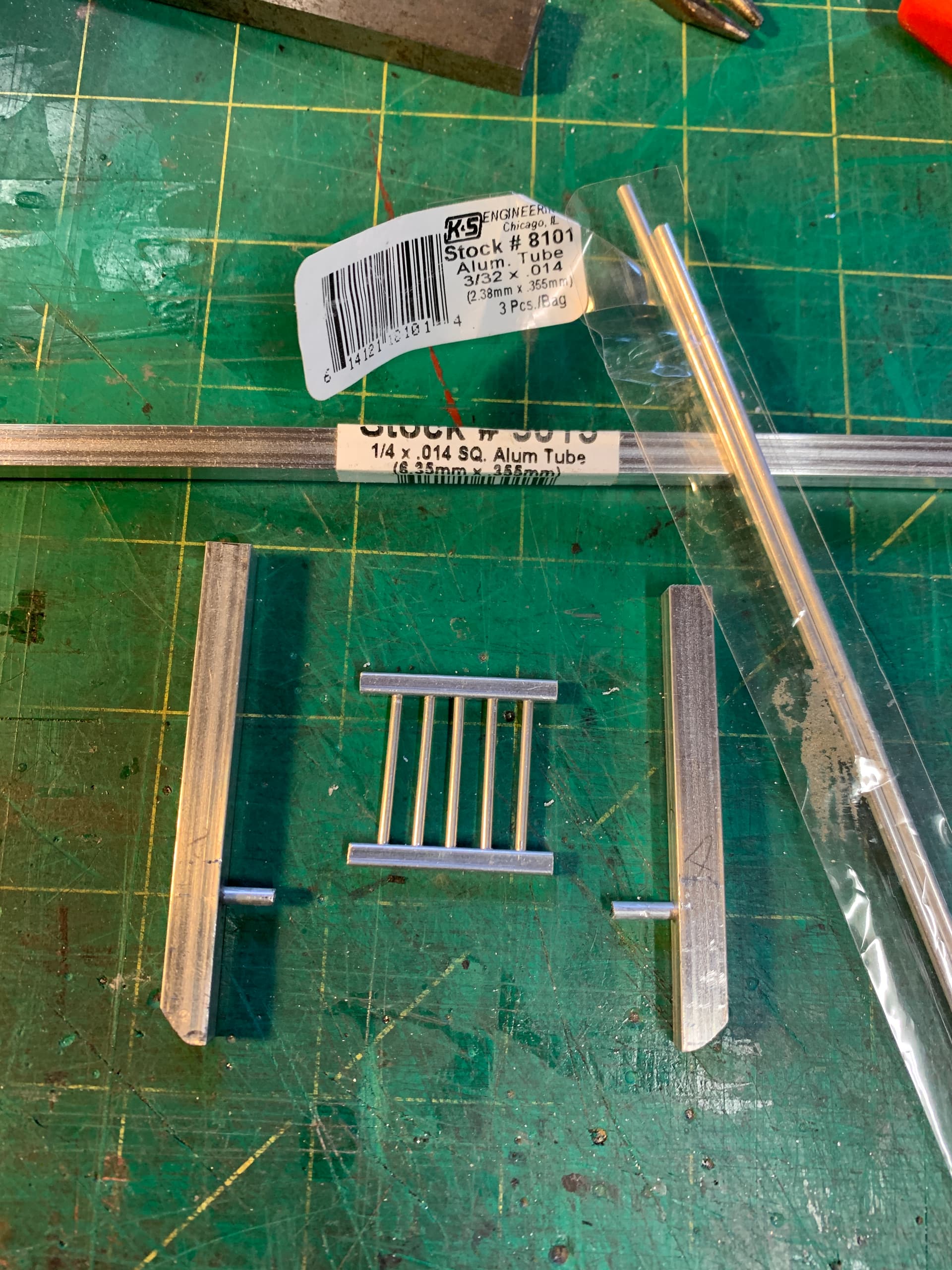

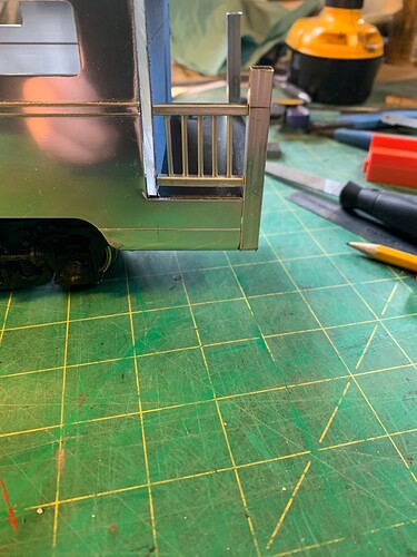

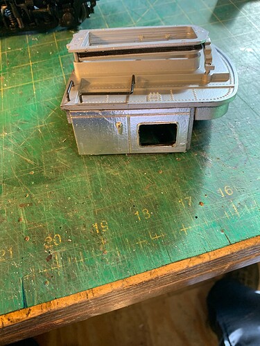

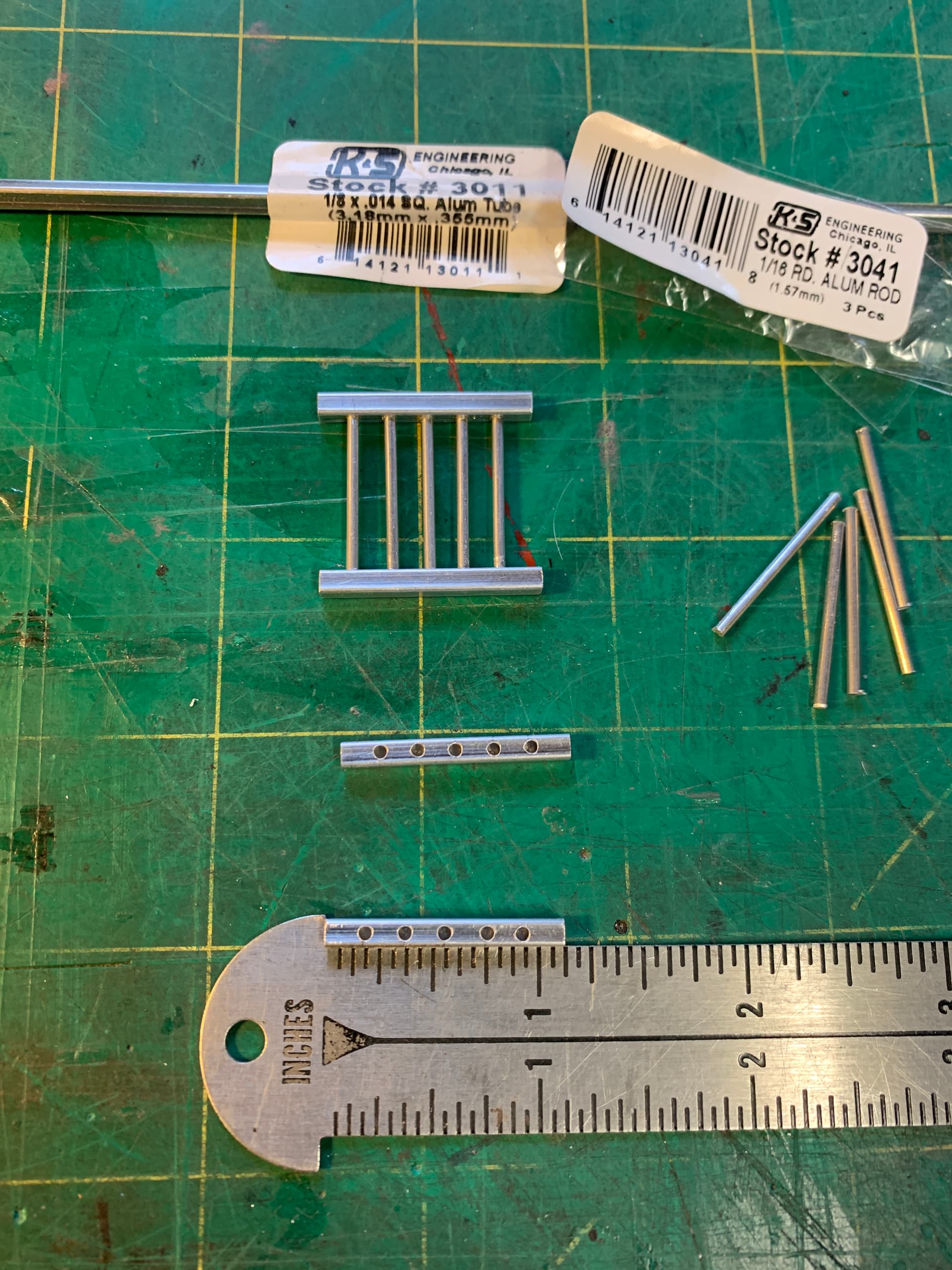

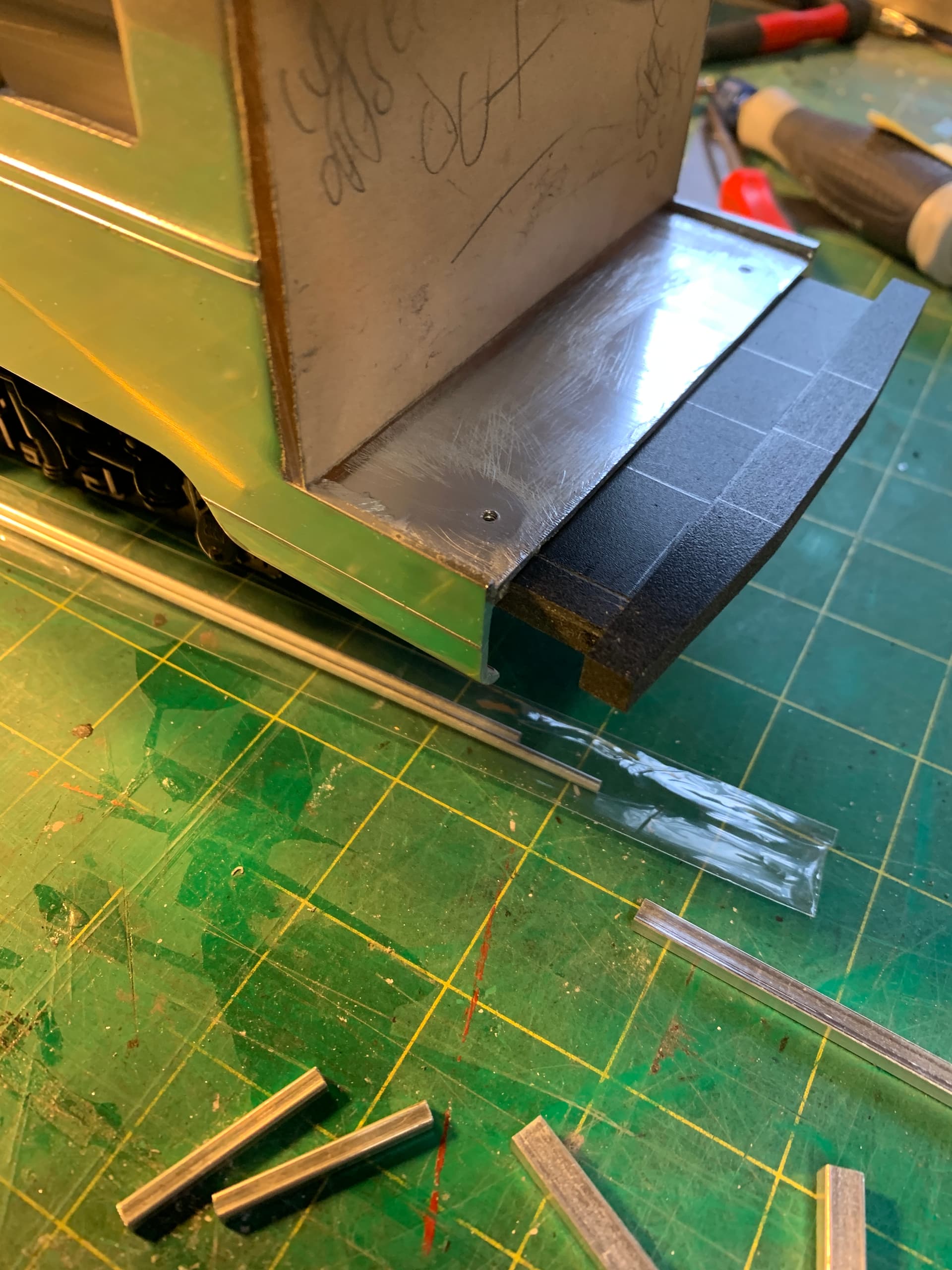

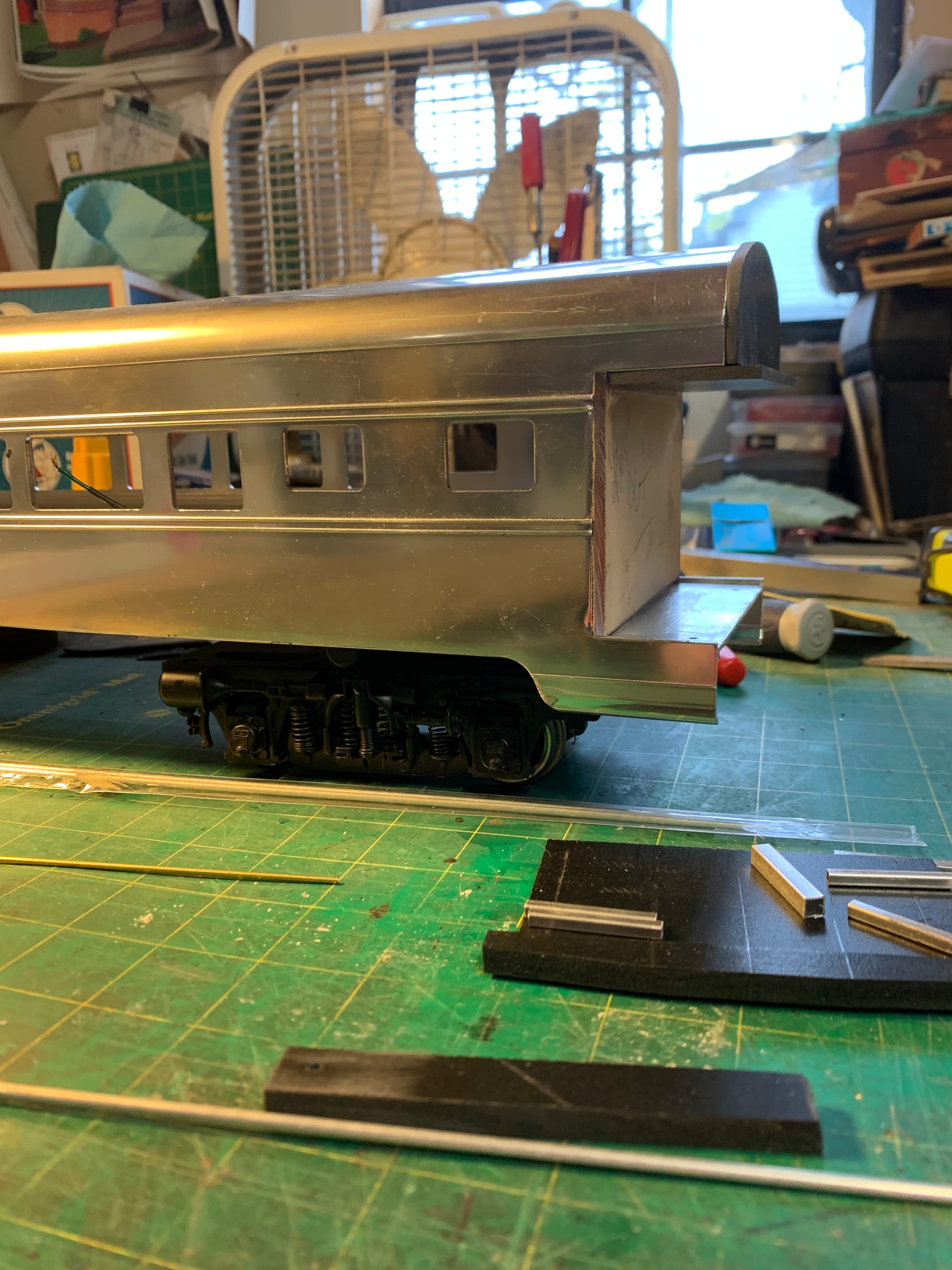

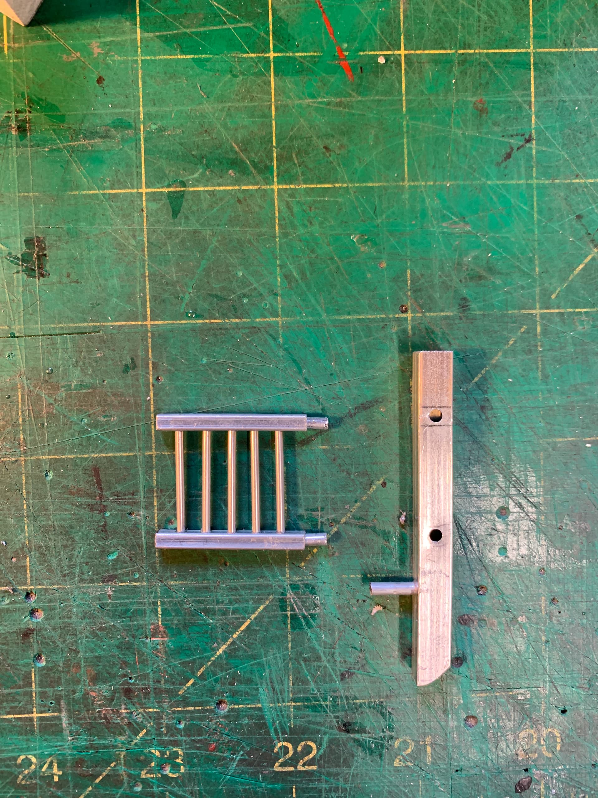

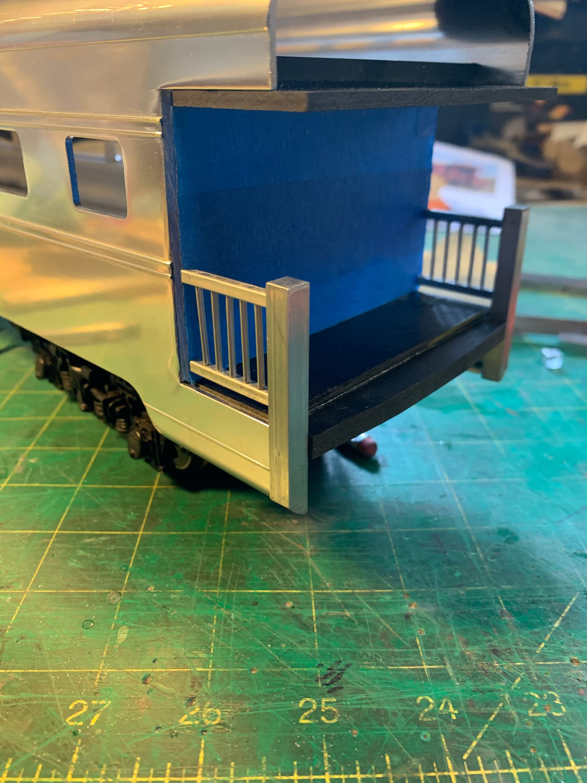

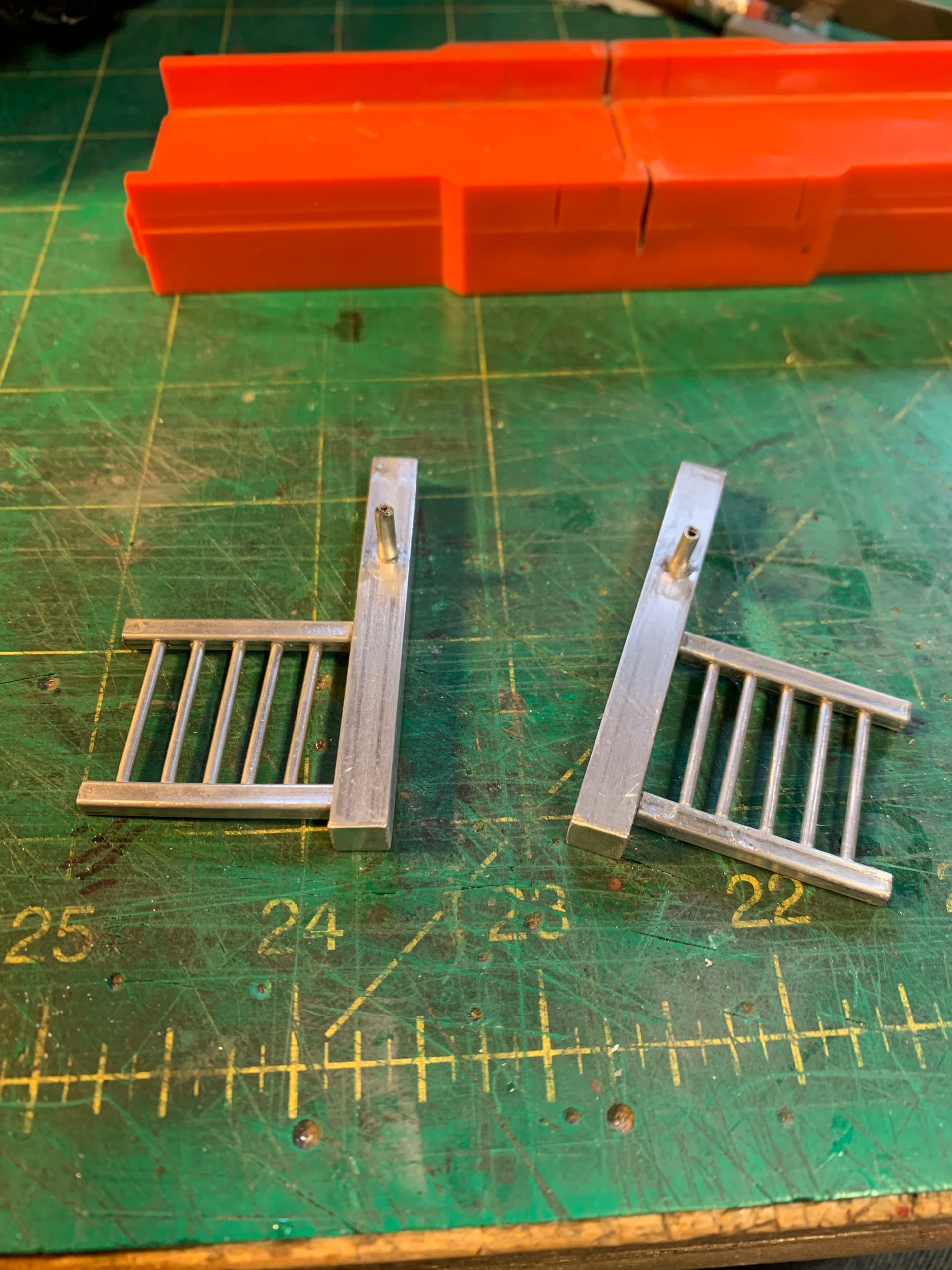

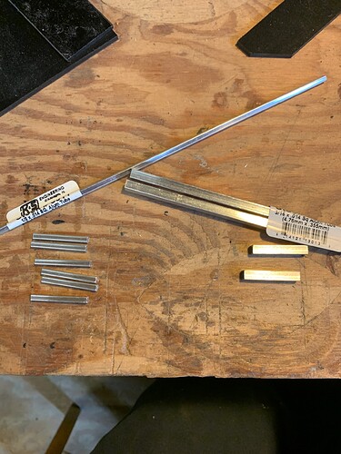

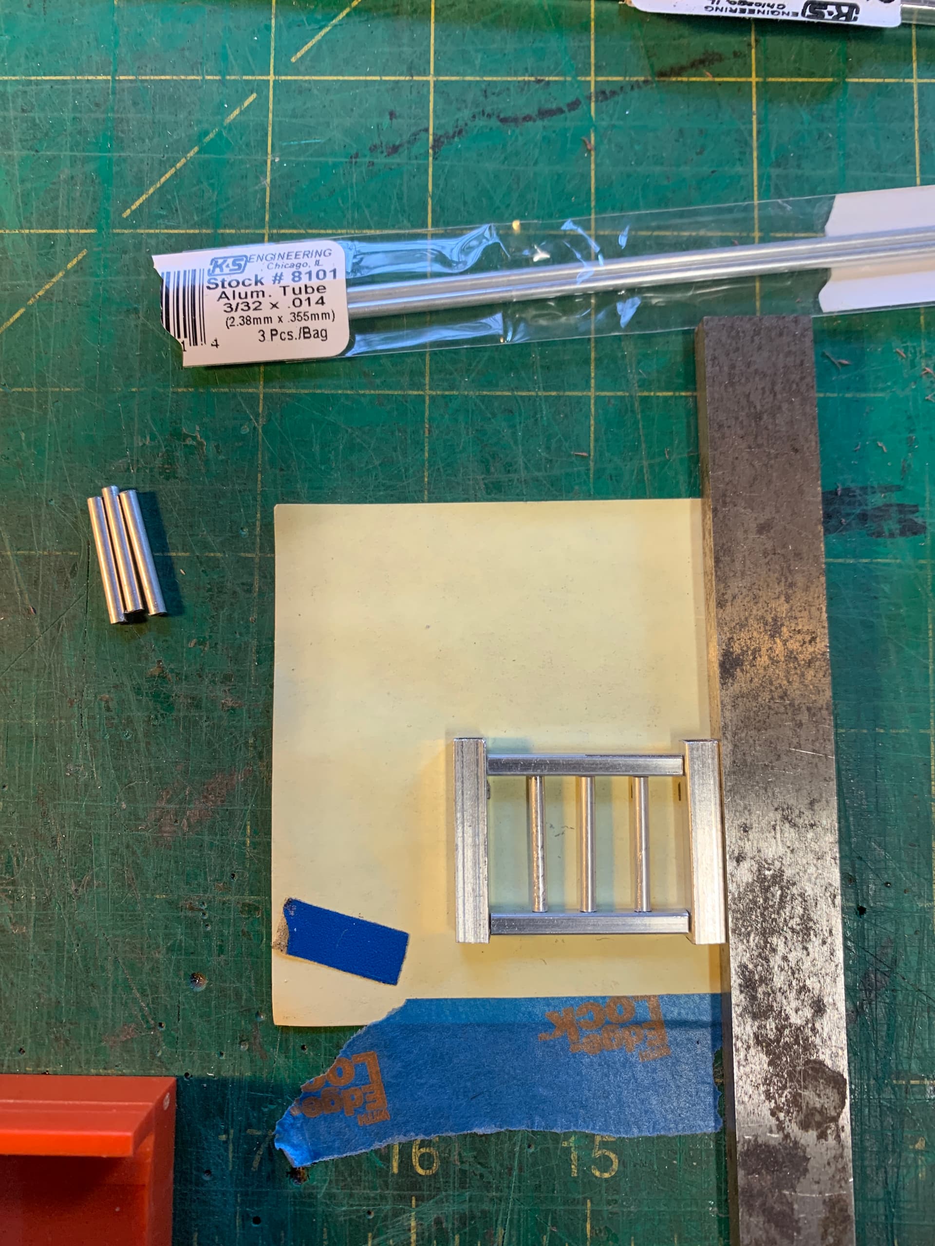

Had about 6hrs play time this weekend and did get a few things done. Figured I might as well work on the railing and get that out of the way. I’m opting for the Deco look of aluminum and I have some left over from other projects.
So I cut up some pieces and played with different sizes and a little on the configuration. Also played with tube verses solid rod until I found a configuration I was satisfied with.

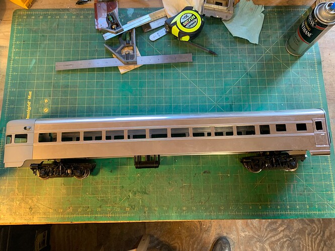

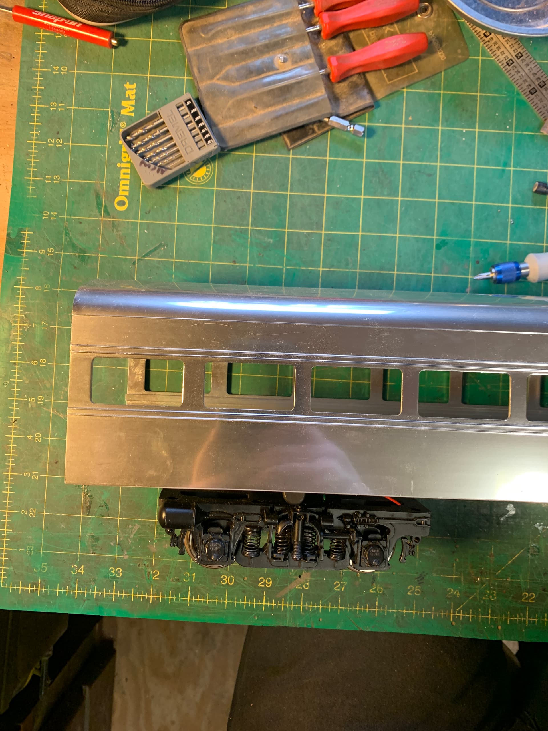

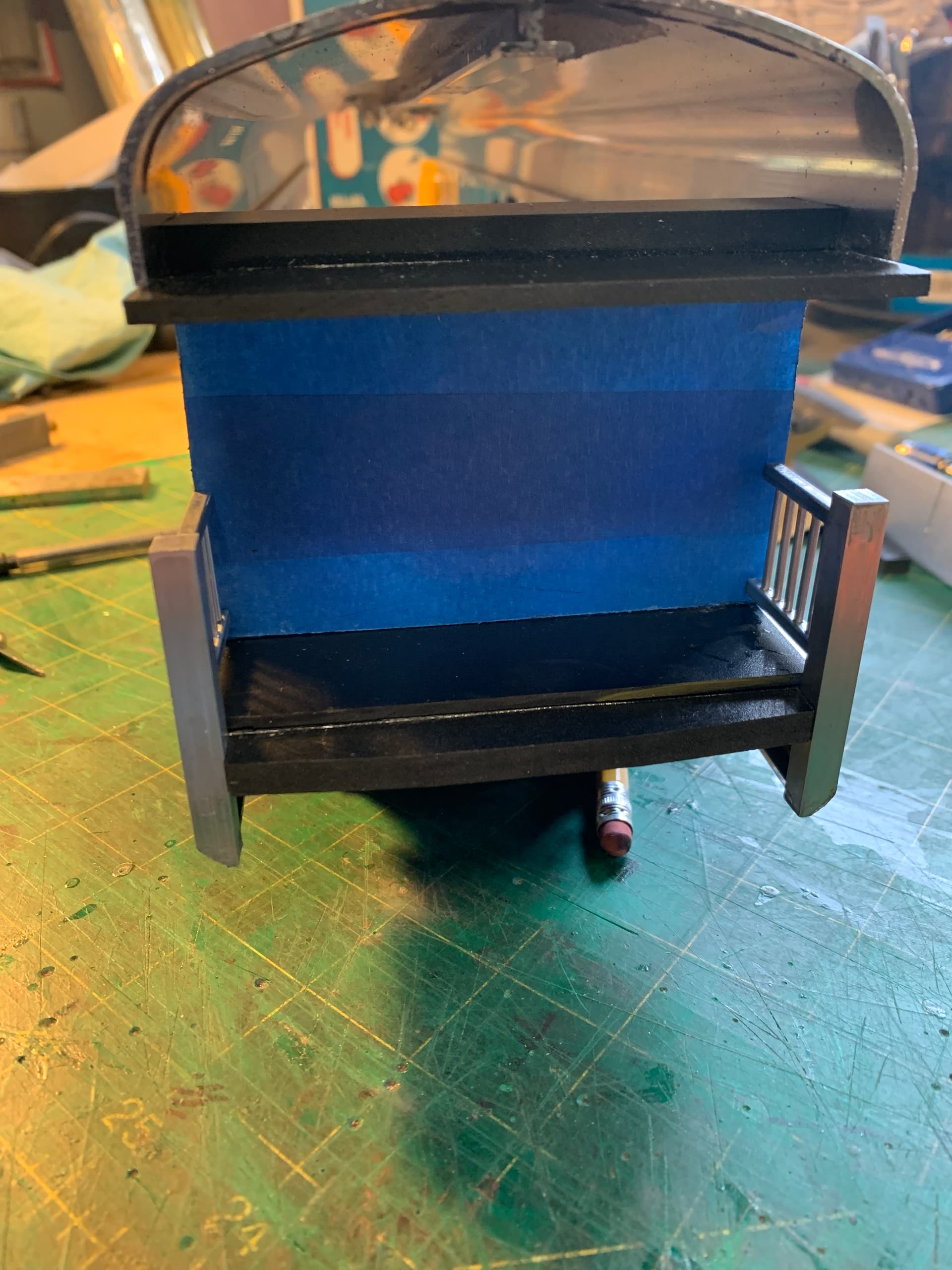

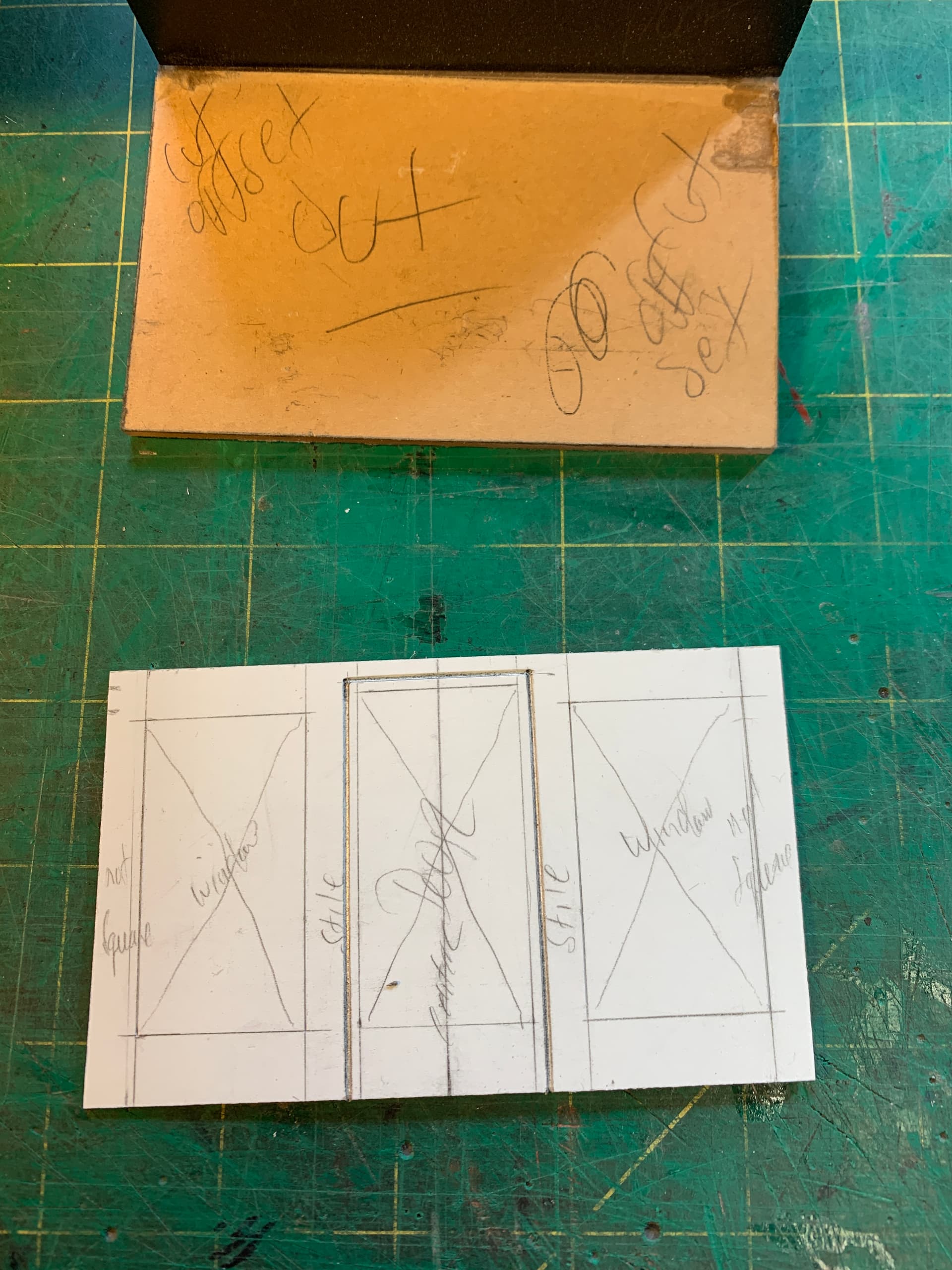

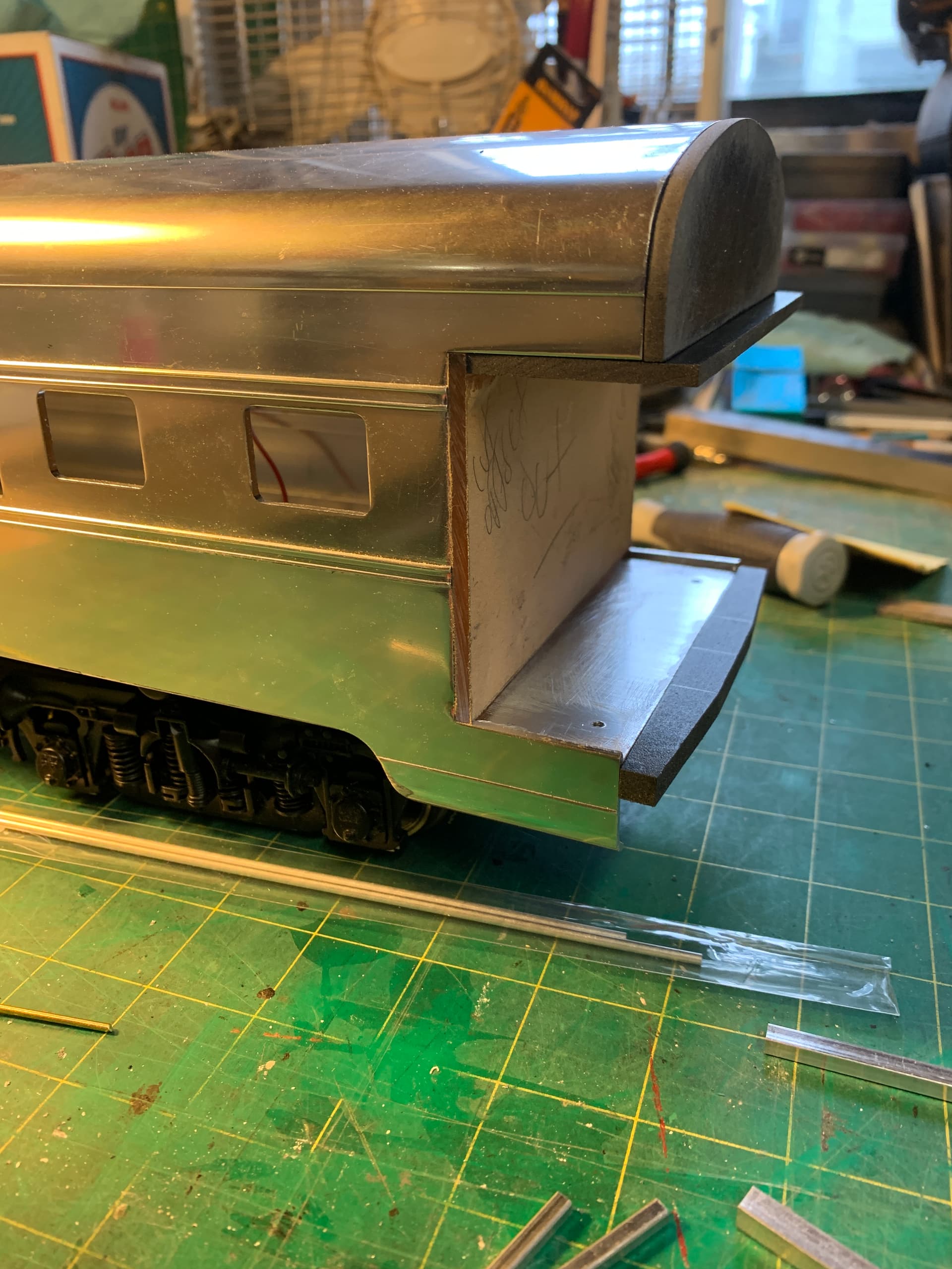

Next I laid out the back wall paneling and told the crew to start getting this stuff cut and mocked up in place. The aluminum shell is kinda out of square and I tried bending it back but it’s gonna spend the rest of it’s life trying to go back to the way it was so I will offset it with the trim.
