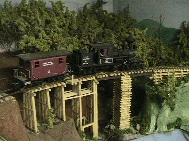

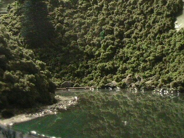

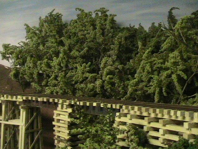

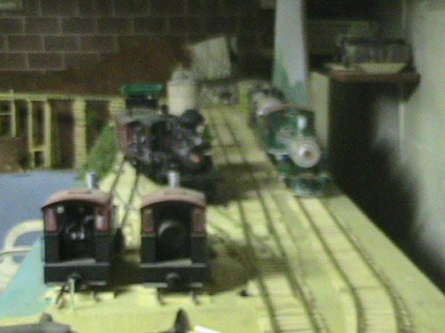

here’s some pics i hope lol
(http://i280.photobucket.com/albums/kk200/scooby19784/G-scale005.jpg)
(http://i280.photobucket.com/albums/kk200/scooby19784/G-scale003.jpg)
(http://i280.photobucket.com/albums/kk200/scooby19784/G-scale001.jpg)
(http://i280.photobucket.com/albums/kk200/scooby19784/G-scale002.jpg)
Scooby, your stuff looks really good, especially the scale brick wall in the last photo.
