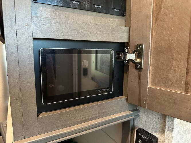

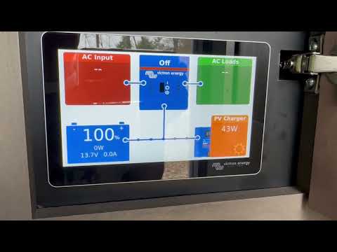

Very nice, So the end goal with all that battery / inverter power is to run your AC’s etc. off battery? Also, how many watts of solar do you have. I’m at 400 and don’t have room for more on the roof.
My solar / battery will handle lighting and the fridge for several days without sun, or many weeks if there is good sun. I decided to go with a propane generator to power the AC/Microwave when we don’t have hook-ups. Going to pick up the genny, a Predator 5000, tomorrow on-sale.
