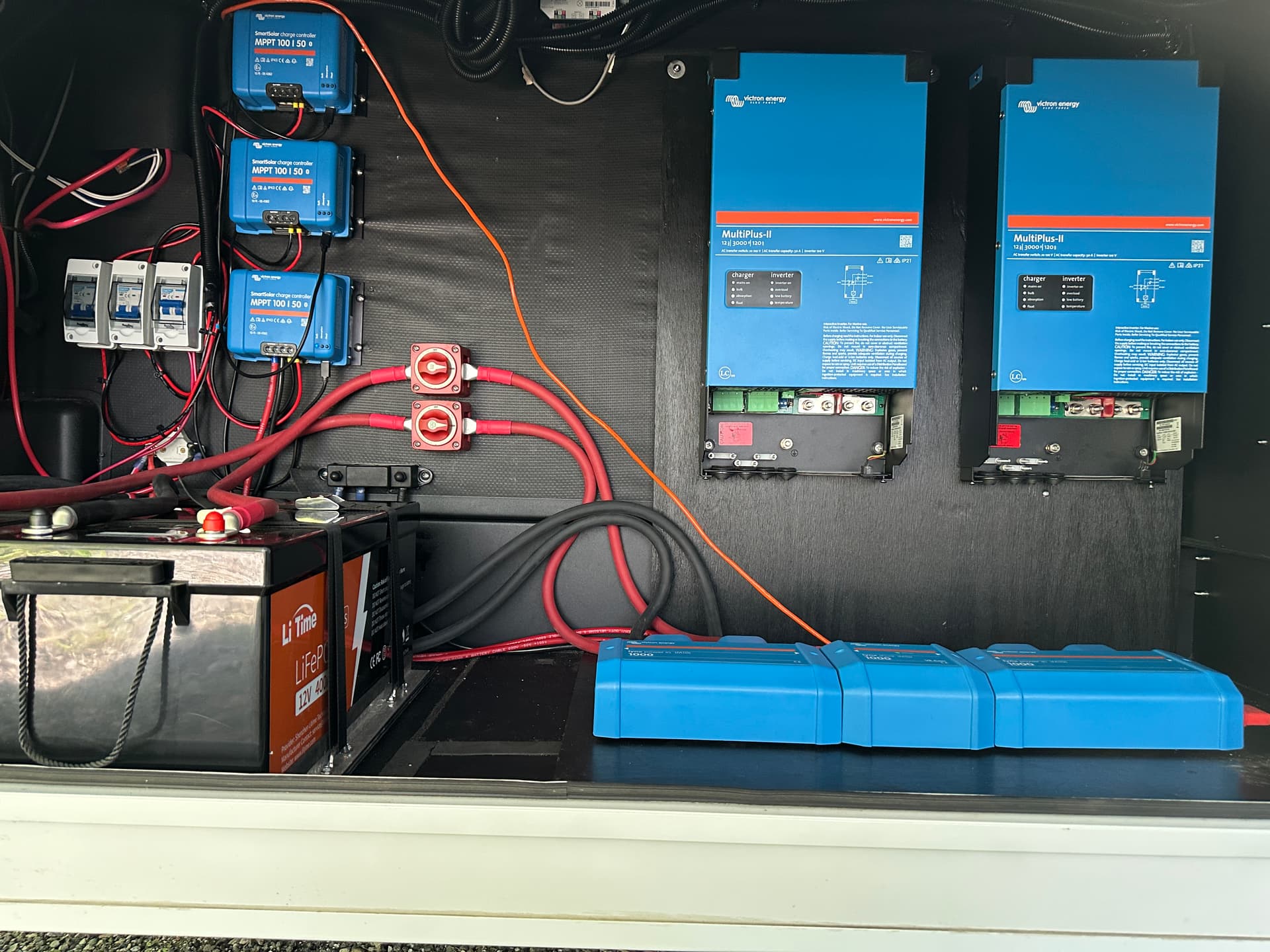

Wrestled the batteries into place and have them wired into the existing wiring. Once the inverter/chargers are part of the mix the wiring will change.

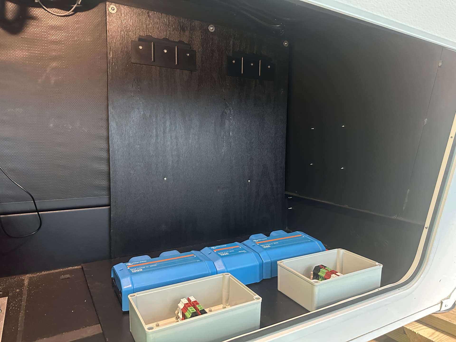

Some more work today. Got the 3/4 plywood backing for the two MultiPlus Inverter/Chargers mounted, and laid out where the bus bars and 120v splitters will go. The MultiPlus will hang from those brackets, and also get screwed into the wall. The batteries are off to the left of the photo. There is room horizontally for one more, and I could rack another three on top of them if I need MOAR POWER.

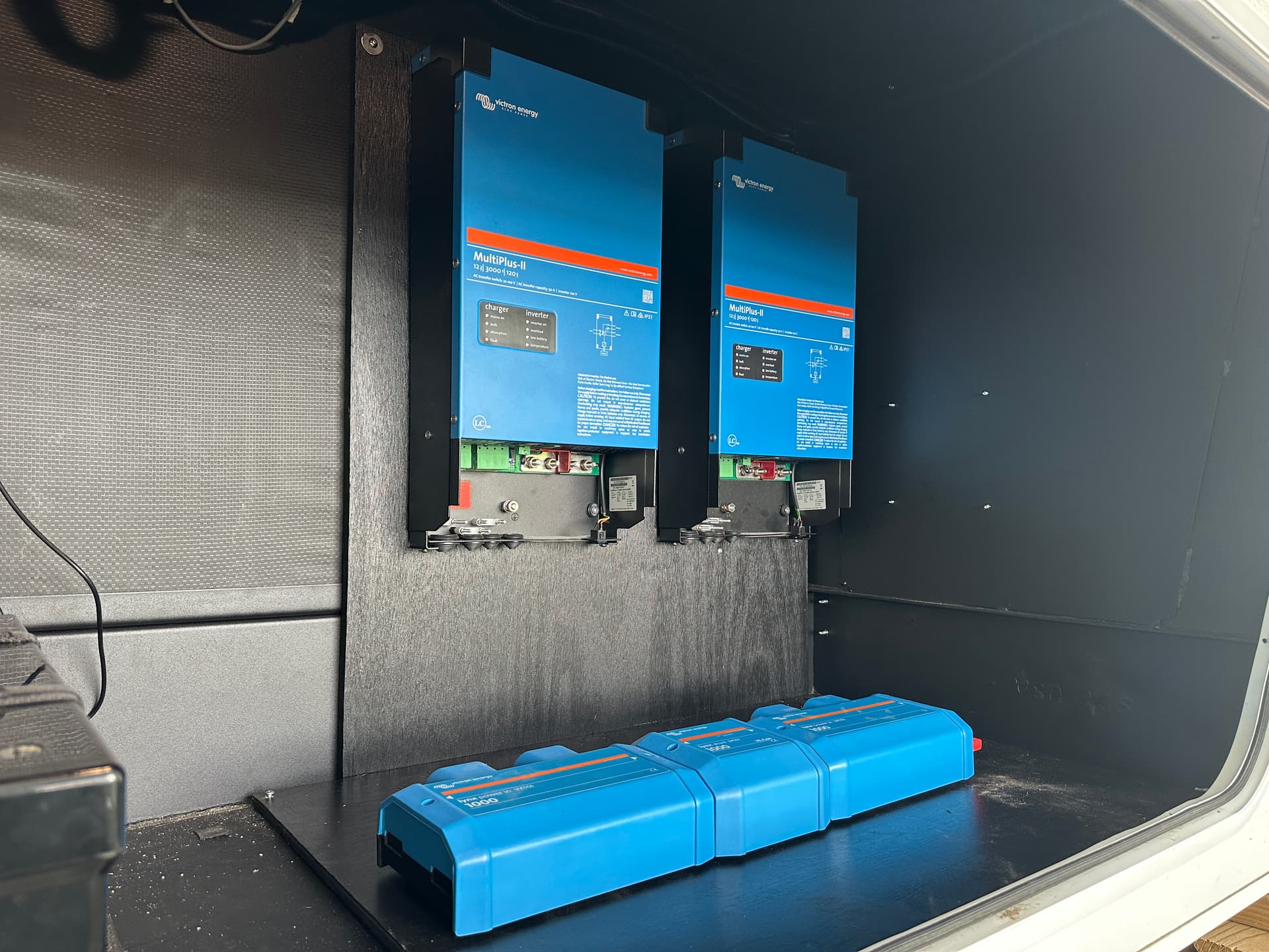

Lots done today. Got the MultiPluses (er, MultiPli?) mounted on the wall. They’re not particularly heavy but the weight is all at the top, so they’re awkward to haul around.
Anyway, those are in place, and measured for the 12v cable to go to the bus bars. The rest of the 12v wiring, with the exception of two of the solar controllers, is in place.
Next is working on the 120v side. 6/4 wire. Tough to work with. Yay.
Remember it’s amperage that kills and that 6/4 can carry plenty of it! Voltage usually just makes you soil yourself (sometimes heavily) then curse like a drunken sailor.
Yup. And on the 12v side, there’s the possibility of drawing 250a from each battery. Which is why those cables are 4/0!

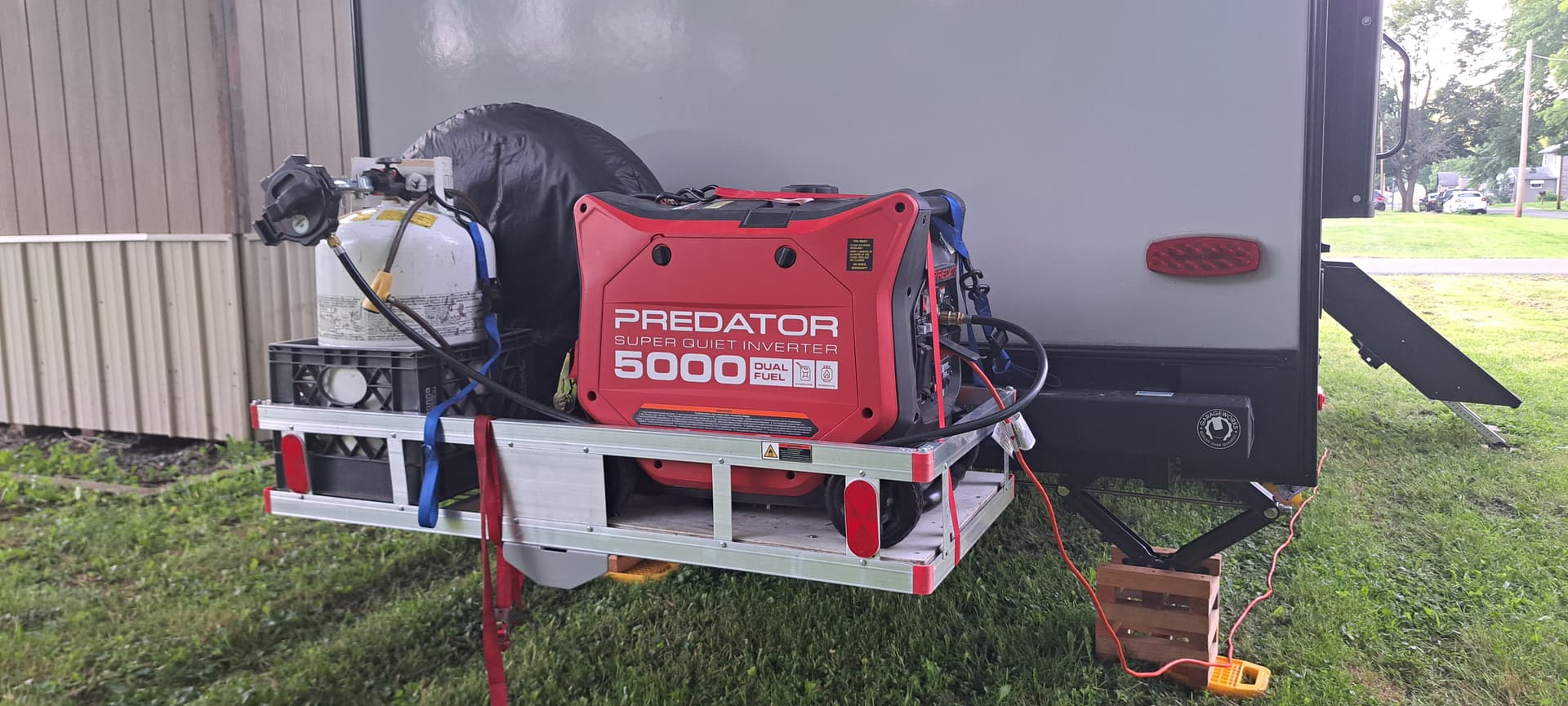

Just before we moved I bought a Preditor 5000 dual fuel and set it up on a rear carrier with a 30# propane bottle. Today I’m using it for it’s intended purpose for the first time.
I have been running on battery only since 10AM Friday.
At the new house there is only one 15A outdoor outlet. My shore power extension cord needs a 20A outlet and I want it to be a GFCI. Walmart only had 15A GFCI’s so, for tonight, I’m using the generator to power my battery charger.
Tomorrow I’ll check the local hardware store to see if they have a 20A GFCI so I can run shore power.
