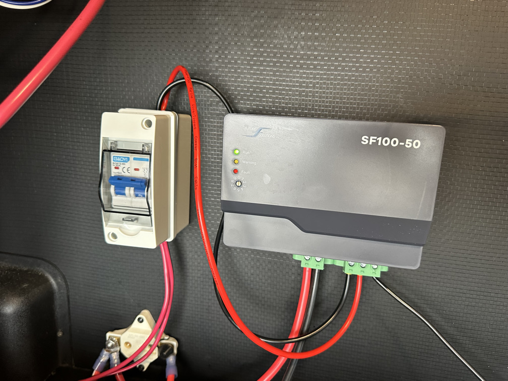

I suppose it’s OK to revive this thread now that camping season is on the horizon. This spring’s RV project is to update the solar charge controller to better charge the lithium batteries I added last year.
Step one is to add a disconnect for the solar panels and the charger -to-battery line. These are required by code in land based installations, but somehow the RV industry gets away without them. That meant that every time I disconnected the PVA leads at the battery they were still hot!
The upgraded charge controller is lots bigger…
It needs a lot of air space, so I needed to extend the wires to a spot where it would fit. The cut-off switch addition was a perfect way to extend the wires…
So I could locate the controller in the large cabinet in the bathroom…

Jon,
As BD said …nice neat/clean install!
I’m with Rooster. No idea what you guys are up to, or if it will work, but at least it’s tidy.

@Cliff_Jennings - It’s really simple stuff. Solar panels see sun and make power, but at a voltage that isn’t good for charging storage batteries. The Solar Conrtoller changes that voltage to properly manage the charging of whatever battery type you select. The stock (little) one uses PWM to convert the voltage, but it’s not efficient and doesn’t work hardly at all when there is not full sun on the panels. The Maximum Power Point Transfer (MPPT) controllers will pull power from the panels even on cloudy days. Google MPPT for the specifics, but basically it finds the voltage where the maximum amperage will transfer to the batteries while maintaining the correct voltage output for charging.
