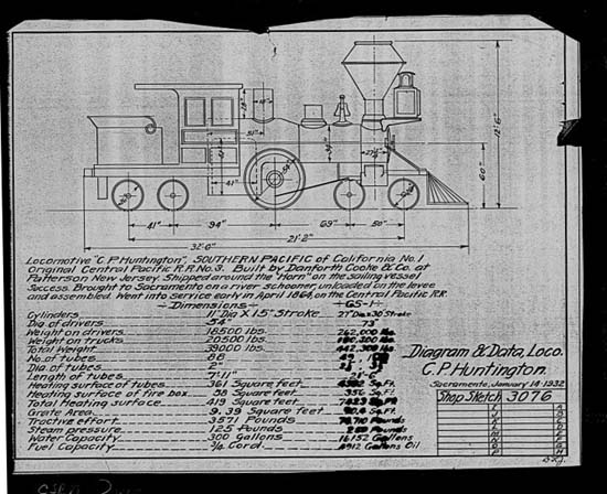

Tommy found this on the web
(http://www.trainweb.org/jeffhartmann/images/CPH_Diagram_1-14-1932.jpg)
http://www.trainweb.org/jeffhartmann/CPH_pg1.html
X
I began by putting up the full-size drawing of the CP Huntington 4-2-4T for inspiration.
