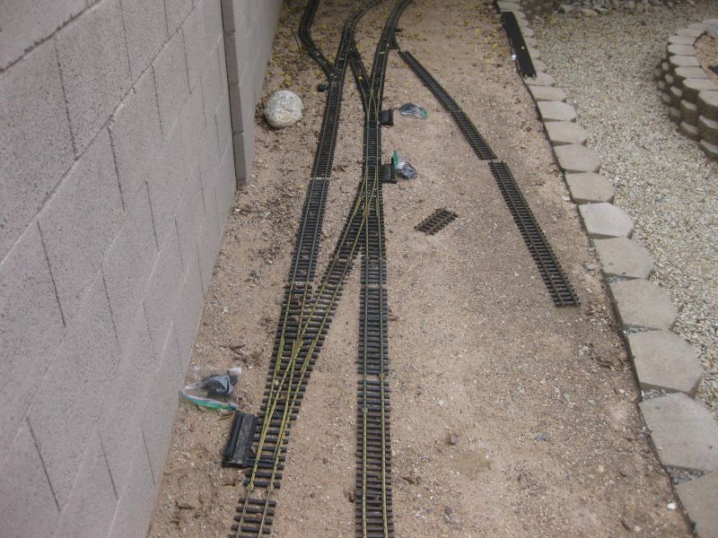

thought I would add this, as I have changed some things from when I started this, I have taken out some things and added more switching oppertunities, to give me something to do besides admiring my train running around the garden. At the bottom left the lead track to the yard is all that fits onto this paper, but there will be hopefully 4 tracks, maybe 5 to hold cars and trains. As always if anyone sees a better way to do something feel free to tell me what I am doing/did wrong.

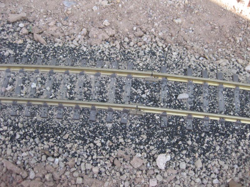

Time for a progress report, still summer so not a lot is going on these days in sunny ( when not under Monsoon conditions) Arizona. But I did get a couple of early morning days where I could do something before it got too hot Checked out some different things for ballast first was small pebbles, but they looked too large so picked them up for use elsewhere and then got a bag of decomposed granite, tried that but it blended in to the dirt too much so I added some of the abrasives I haul, Brand name SharpShot, copper slag from old copper mines, ground screened and graded in 75lb bags, (another product almost the same is Black Beauty) I used the extra coarse 12x30 size and after adjusting the mix I think I like how it looks

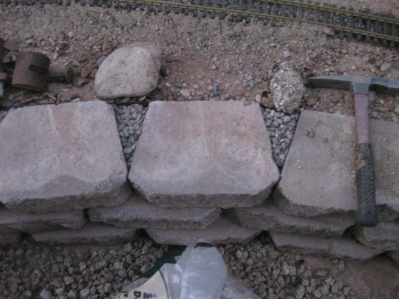

after that test I took the small pebbles bag and tried them in the “V” gaps between the wall blocks to make things look a bit more “finished” looking
I may spread them out a little from there to fill that area in.

Best keep that grit away from the throw bar area as well … A general rule of thumb is the switch goes on a hard surface and no ballast near moving parts, including the rails.

Are you track power or battery power? if track power, having metal particles in the ballast can cause the track to short out in damp weather.
And you really don’t want to use rounded stone as ballast, they don’t lock together and hold the track well.

Forgot to mention that the grit can get into your engines; a rain splash or watering, a downdraft can send it anywhere… I’d sift out the finer stuff and cover a wet cement slag heap with it.
Might want to wash your bearings between runs … https://www.webstaurantstore.com/all-points-85-1138-non-aerosol-food-grade-machine-oil-14-oz/AP851138.html
This stuff is bigger than sand particles so should not have a problem with it intruding any worse than sand and dirt. There isn’t enough of the slag to cause shorts , I don’t think, and I am not sure if it is even metallic. Going to get a magnet to see now!
Copper is non magnetic. An ohm meter will tell you if the slag is conductive.

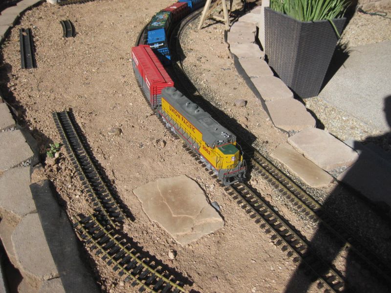

Well had some time off, so I got out and was able to bend and connect the second (inner) loop of track, so all the main lines are done with the exception of the reverse loop which will wait until I have converted the loco to battery power. So here are some pictures of the new loop of track
The cross overs and 2 of the industrial areas on the west side looking to the north. So I got bold and got a train together and ran it for about 15 minutes
as the train rolled past an area where it had done fine for 15 minutes, the next to last car went off the track and fell on its left side taking all the cars ahead of it, I think the fact that the boxcar behind the loco is a USA and all the other cars are Aristo and the low coupler on the USA prevented everything from fall over. That will teach me to not have all track supported before running cars over them. No harm to anything so no big problems

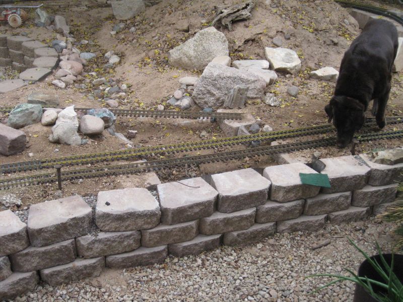

Here is a close up of where the 2 track bridge will go, the railroad spikes in the ground are a thinking about it widening of the riverbed to the 2 spikes( about 64" wide) to give a more dramatic main view of he layout from the patio and the big double doors from the house. I might shorten it to 48" I need to make a couple of templates to see which size works best without overwhelming the layout. Grandkid’s dog Sadie had to investigate the whole layout since I have had a neighborhood cat in the yard a few times
This is the first view that visitors at an open house will have not entering from the house. the mountain will need some major work to make it something that will get your attention. I may move most of the dirt more towards the camera and give it a way different treatment.
