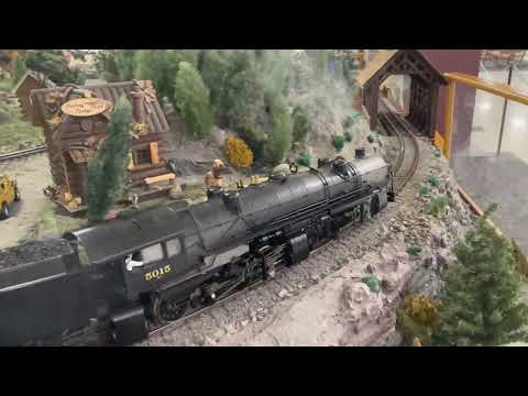

I always wanted one of those, just to say I had one. And just look at it. There’s no way it would run on my tight turns though.
