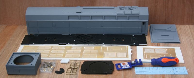

Here’s the kit I"m getting from Johnathan http://www.g-bits.co.uk, in the UK should have it next week. Should keep me busy. Will us Aristo FA bocks. Nice it has a frame. He also has some Aristo C-16 blocks.

I got my Shark B unit yesterday from Jonathan. It is just AMAZING! The crisp/clean details and solid construction are the best I’ve seen. It looks just like you see in the picture up above. The inside structure that you don’t see makes it very strong Etched metal screens, even comes with nuts and bolts to help assembly. This was well worth the wait. I am finishing up another locomotive right now, so will not start on this for a week or two. He’s done so much, there is not much to do except glue in the grills and paint it. This would be a great first kit for someone to learn on, but may spoil them when they get one from someone else. Thanks Jonathan for your fine work, the wait was worth it. Your communication on your progress was great and we’ve had many good email conversations, glad to have you as a friend now also.
What you can’t see here is the inside structure that makes it very strong. Note he includes nuts and bolts and a metric driver

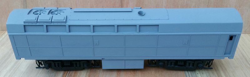

Just sitting here on Aristo FA trucks. Note on the frame how easy it will be to mount them. Very well thought out kit.
Looking good Jerry, can’t wait to see it painted and running with your A unit.
Finally got to the B unit. GOt the trucks on, they fit the frame he made like a glove! All wired up for track power and to hook up to the A unit. Silver paint is on, will get back to it, once I get the couplers on.

Here is the finished Shark B unit. Neatest kit I’ve ever bought. So well engineered and thought out. Small pieces to exactly fit on the Aristo motor blocks to attach it to the custom made frame. The etched parts from the A unit were made again to go with the kit and they went on well using E6000 glue. The A&B line up even with each other very well. Johnathan did a great job planning this out. The yellow stripes are vinyl left over from My A unit build. Stan did the decals. It’s 11 degrees outside right now, supposed to get up in the 40’s next week for some outside shots. No sound and doubt i’ll bother. Nice to have some quiet trains, I live near the UP mainline. It is track powered and the D&H coaches have Gary Raymond ball bearing pickups on them, so a nice long area to pick up power.
