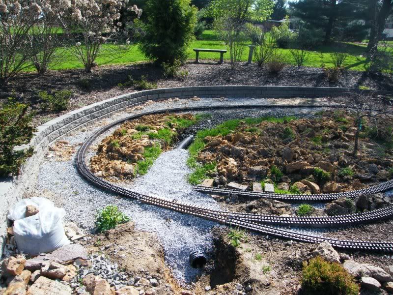

I wasn’t sure whether to start a new thread or just add on to this one, so I decided since it’s just one more phase of this thread it’ll go here. So this thread has been resurrected. Over the winter with all the snow and rain we had I came to the conclusion that this area needed some drainage. That thought had entered my mind while I building in this area. I just figgered I’d wait and see how bad it got. A few times the water from melting snow and rain covered the track work which is a good 4" in some places above ground level. I didn’t think of it at the time to take pix, so you’ll have to take my word for it. This convinced me that I needed to put in something to drain all this water away. Overall the layout held up pretty good over the winter. One exception was the switch on the south side entering Hesperus. Due to a lot of below freezing weather this area for some reason experienced a bit of frost heave and tore out some of the track on the switch. I pulled the switch and rebuilt it last month. Hopefully I reinforced it enough that it won’t happen again. While I had that switch on the workbench, I decided to lift the switch at the opposite end and rebuild it too. I had made it with some left over code 332 aluminum track and had been debating rebuilding it with 250 alum. The drainage issue came up so I pulled up that switch to rebuild it and while it was out began planning on how to put some drainage in. This is what I came up with.
(http://i253.photobucket.com/albums/hh58/rgseng/expansion/expand070.jpg)
This end of the layout seemed to have the worst drainage problem so that was where the drain would go.

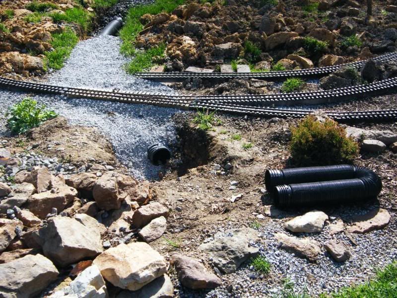

(http://i253.photobucket.com/albums/hh58/rgseng/expansion/expand071.jpg)
The switch that was pulled up and rebuilt and is now back in place.

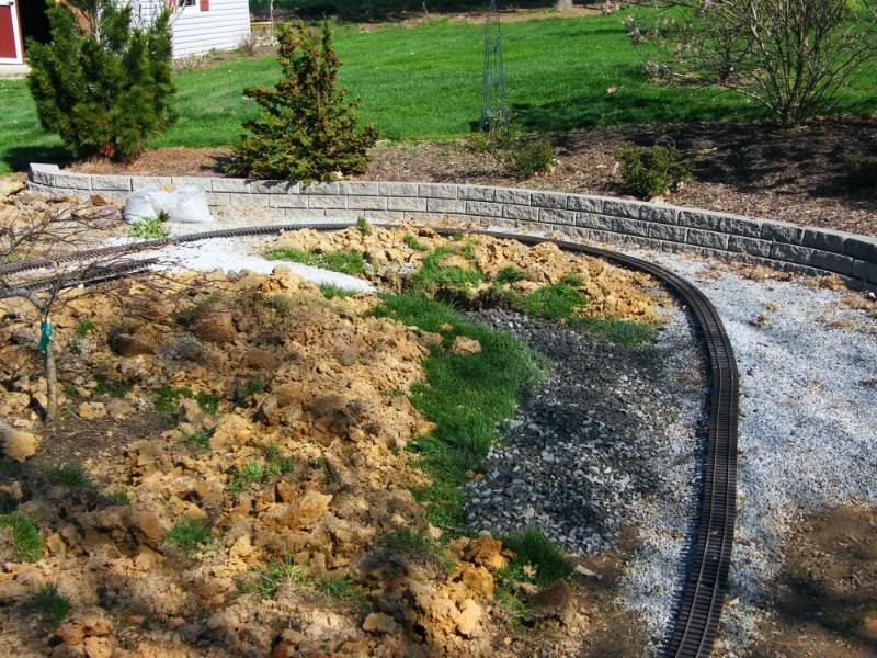

(http://i253.photobucket.com/albums/hh58/rgseng/expansion/expand074.jpg)
As you can see this added a bit more dirt to the layout and once I get that spread out, it will be a few less truck loads I’ll have to buy and spread.

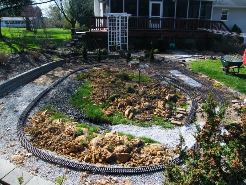

(http://i253.photobucket.com/albums/hh58/rgseng/expansion/expand073.jpg)
The Japanese Maple on the left didn’t fare well over the winter either. With all the snow accumulation it split right down the middle. My son taped it back together but it doesn’t look good at this point and will probably need to be replaced. Now, all I need is some rain to see how this all works out!
