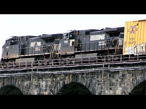

Pretty sure were on the same page. Just a terminology I have never heard. She is a monster loco!
BTW, I’m about 20 minutes from Rockville if you ever decide to visit Pennsyltucky. :laughing:
David, yes keeping the cuts square can be a challenge. :open_mouth:
Rooster, that’s a great shot of the original following the rebuild. :slight_smile:
