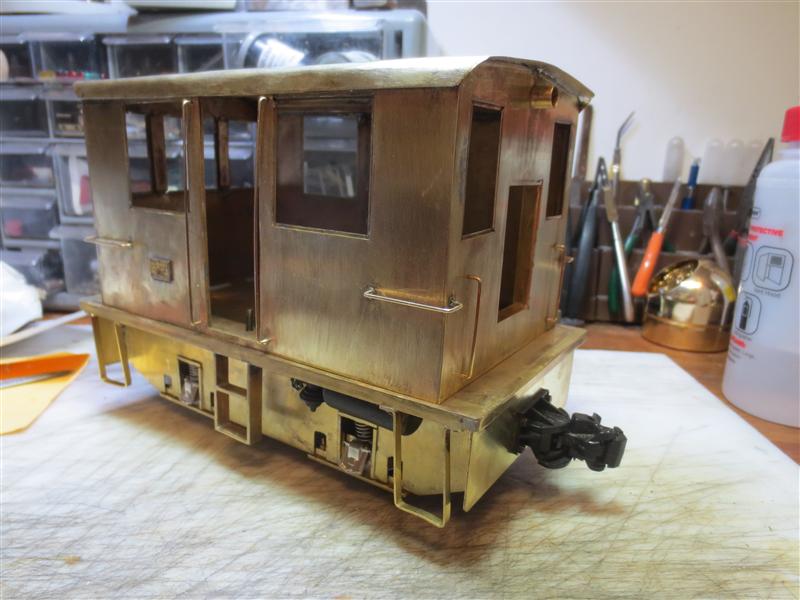

I first cut a pattern out of paper to get an idea of how big of a brass piece I would need.
Then cut the brass to size.
Next up was trying to bend it into place. I finally put the cab on it’s side and used a hammer to shape the roof.
It probably still needs a few more whacks, but it is almost ready to solder in place.
Here’s a couple of shots of the roof just setting in place.

Here’s the deal. The roof will NOT be removable. Too hard to make that happen.
However, the cab itself will be removable. 6 screws will hold it onto the chassis. Pretty easy, as I have put a 1/8 x 1/2" brass bar on the sides - easy to tap into it.

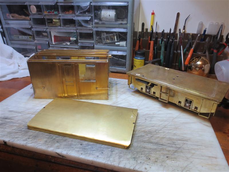

Well, now that the Sludeworks is complete, it’s time to go back to the critter.
As you may recall, the body had reinforcing beams soldered across the top, and the roof was bent to shape.
Today I started soldering the roof in place; quite tedious as I had to make sure that the roof was flat against each beam and try to solder while I’m holding it down. I could have used 3 more hands.
But, I’m soon done…lots of cleanup this time.

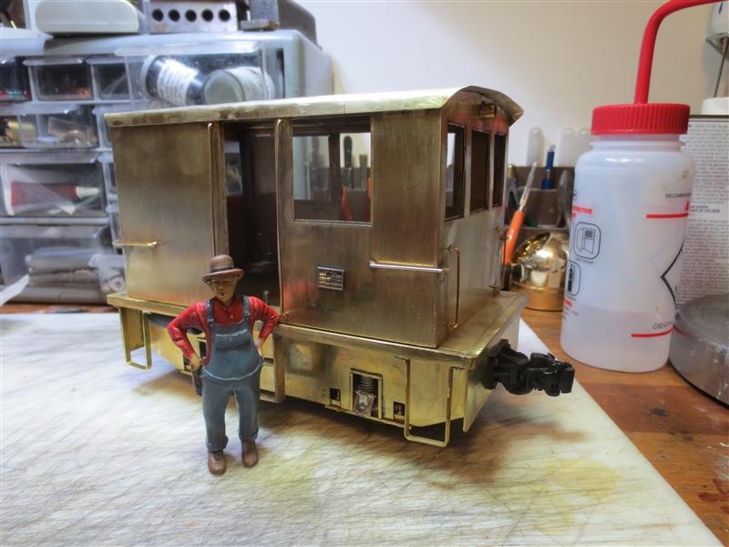

Next, I drilled and tapped for 6 4-40 screws to hold the body to the frame. I added some manufacturer plates and I’m almost ready to go!

Awesome work, looks like an expensive brass import.
Where’d you get the builder’s plate?
Thanks guys.
Ray, those builder’s plates are from Trackside Details. One nice benefit is that they are brass and could be soldered in place.
