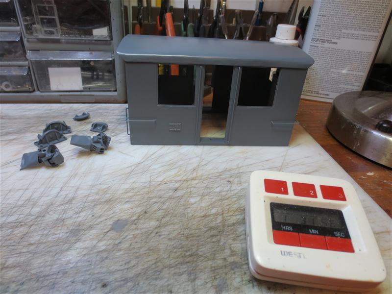

Today I started attacking the electronics.
First up, an enclosure for the speaker. I ended up making a combination piece that is screwed to the base. It acts as a place to store the battery underneath, the Revolution receiver on top, and a seat for my driver.
The receiver isn’t fastened down yet - I’ll probably use some double sided tape to hold it in place.
Later, I hooked up some LED for the headlights and tested everything to make sure that it all works.
Once there is some glazing, I’m not sure how much of this will be visible, so I don’t think I’m going to try to cover it all up.
