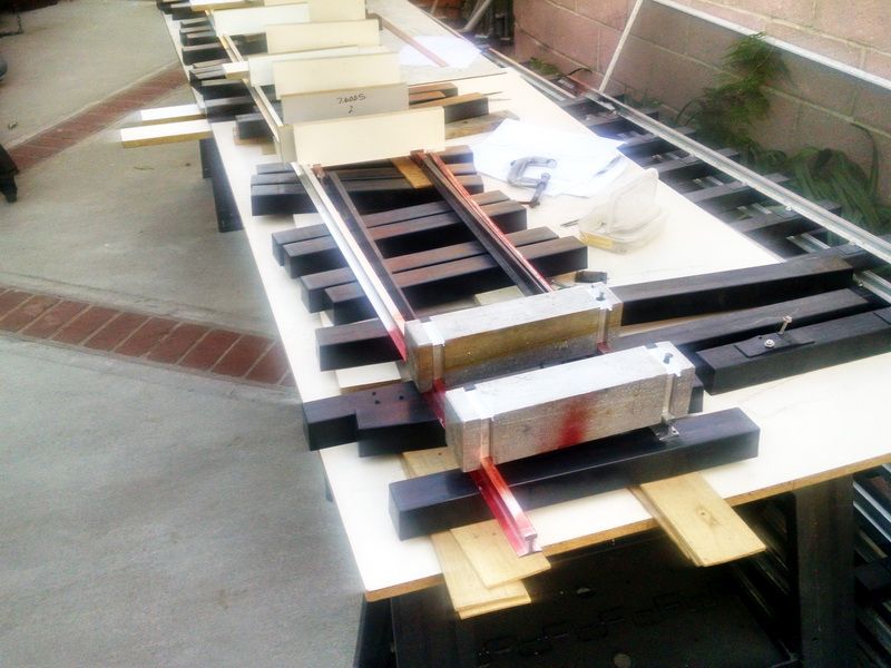

The series of photos below, show the various “fitting templates” and gages I machined, to check track gauge, chord length and arc height. These are positioned in “station points” or positions along the turnout. All the dimensions are based on the distance from the end of the switch points. Also the fitting templates establish the relationships between the curved closure rail and the straight closure rail and their relationship to the main stock rails.
As you can see in this photo, the edge of the fitting template establishes the relationship of the main straight stock rail and the main curved stock rail AND the position of the cast aluminum frog and the ends of the curved and straight closure rails. Everything checks :).

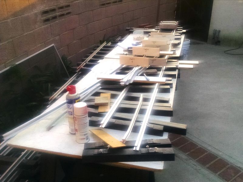

Well today was the big day. All the parts are finished on this big turnout and the day of reckoning has arrived. Now I see if it all goes together and all the geometry lines up to make a good operating 1/8th scale turnout. I started with the straight main stock rail first and drilled and fastened the first tie into place. Next I fastened the end tie on the straight stock rail on the diverging end. All the subsequent ties go against the match board along the entire length of the 104.5 inch long turnout. With the screw holes already drill in the foot of the rail, it was easy to establish spacing. I centered each rail hole in the center of each tie and match drilled the tie. I just “marked” the hole going into the tie about a 1/16th of an inch. Then I finished drilling the pilot hole in the tie on my Shopsmith, with everything straight and perpendicular in the tie. Back to the turnout to open the 1/8 inch diameter hole up to .135 diameter (the tap size drill for a #10 SS deck screw).

If you look closely at the photo, you will see the pre-drilled 1/8 dimeter holes in the straight closure rail. and also the elongated cast holes in the frog. The straight closure rail gets screwed to the ties the same way the main right stock rail does (I’m still assembling :)). BOTH the curved and straight closure rails don’t fasten to the frog. The frog is attached to the ties as the rails are, but the frog “floats” separately. The assembly of the turnout is done in the following order: The straight rail is first, then the straight closure rail, using a track gauge fixture to establish correct track gauge. Next the frog is fastened in place in relationship to the straight closure rail.The curved stock rail is next. Last is the curved closure rail checking track gauge to the curved stock rail.
