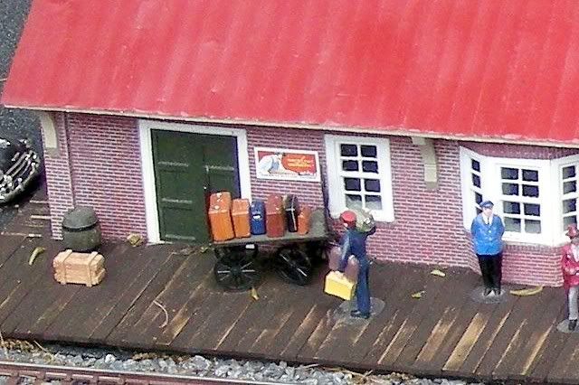

You can get a big sheet of them for $10 from Precision Products in several styles. They are a pain to paint the clear ones but they are cheap. I use MicroMask to coat the panes, spray paint them and then score the MicroMask with an Exacto knife before peeling it off. I have clear on my station and pub -
(http://i113.photobucket.com/albums/n214/altterrain/building%20projects/stationcart.jpg)
(http://i113.photobucket.com/albums/n214/altterrain/building%20projects/pubblksm.jpg)
