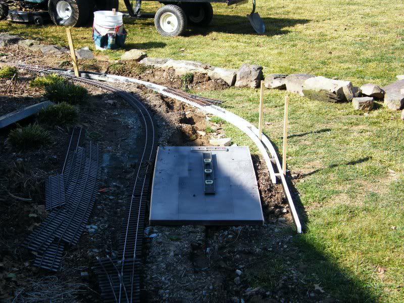

I want to glue some crusher fines to a piece of hardybacker cement board that I am using as a base for my station. The bases will be outside year round in PA weather.
Anyone had success in this area?
