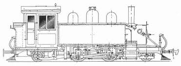

The cab is much larger than what it should be for 1:22.5 though, more like 1:20 in overall height and width. Also going by the doorway which was not that high on the prototype. I’m 6’2" and I duck my head on Lyn’s much bigger sister NA class 2-6-2.
If you compare it’s profile to an Accucraft ‘Lyn’ you will notice the main steam dome is taller compared to the cab but on the Bachmann ‘Lyn’ it is not.
The roof sits a little lower than the L&B rolling stock from Accucraft but looks OK as they are all very small prototypes.
Here is a link I was luckily able to find again on the subject. It gives some useful prototype and model dimensions.
http://www.finescalerr.com/product_reviews/Bachmann-2-4-2.html
David Fletcher’s Baldwin 2-4-2 and 2-6-2 drawings.
http://www.pacificng.com/ref/blw/style/stylediag/Na1-Lyn-Colour2-STLE-292-223.png
Some approximate prototype info from the above links:
Length (end beams): 28’
Drivers: 33"
Wheelbase Drivers: 5’
Wheelbase Overall: 17’ 7"
Width (side tanks): 6’ 5"
Height (cab roof): 8’ 10"
Door height: 5’ 3"
